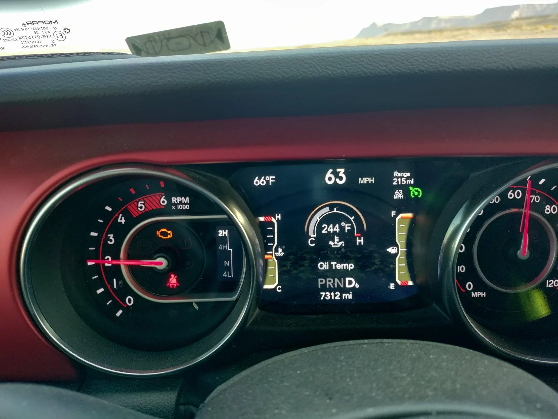

Highest temps I got was 248

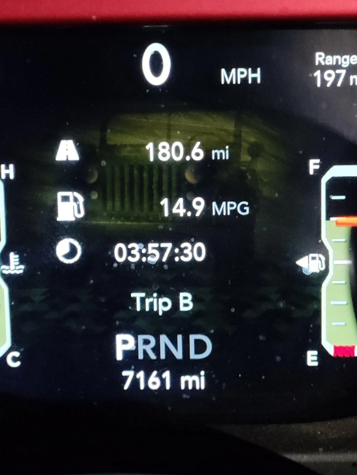

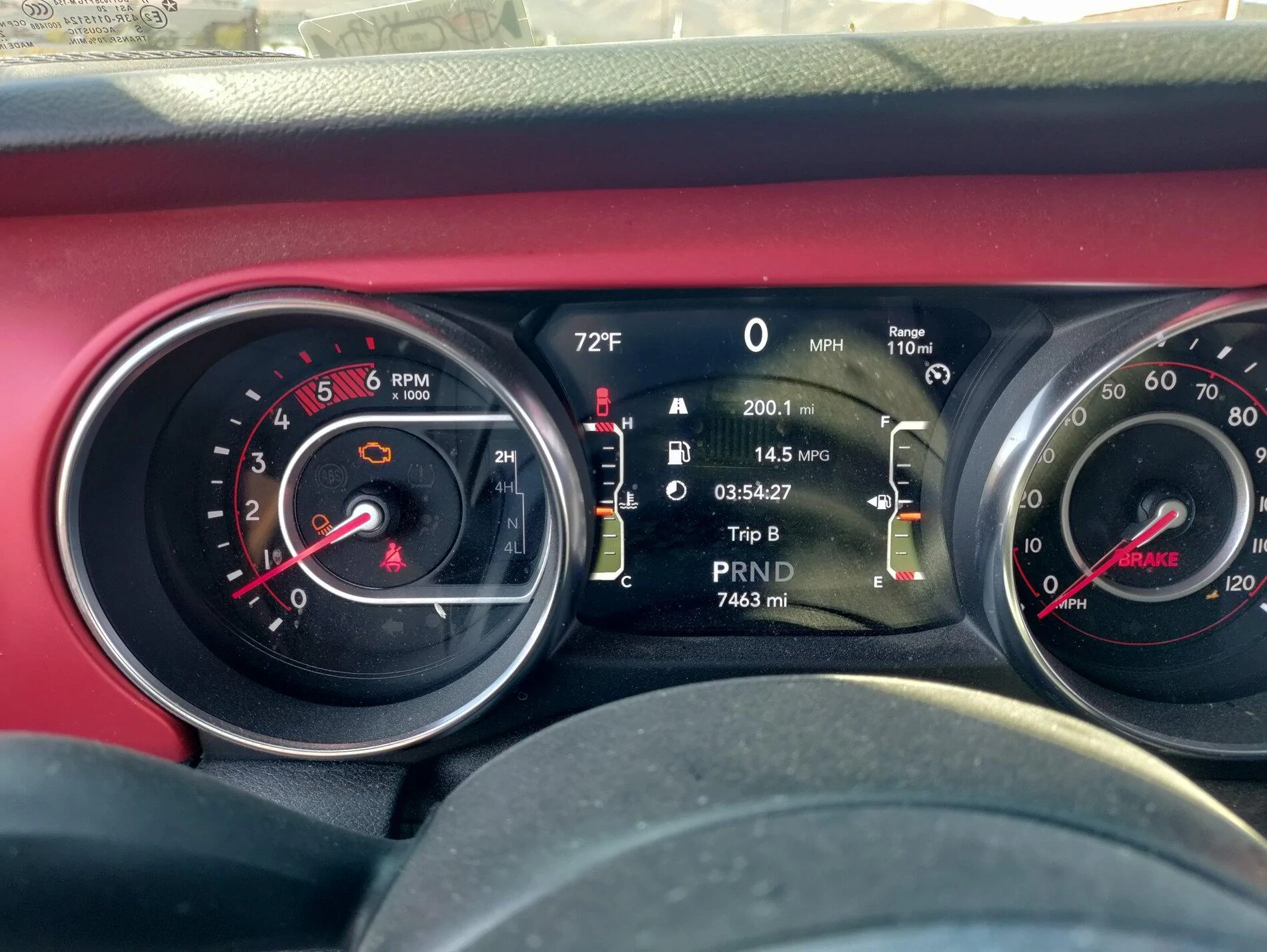

I got 14.9 mpg going down and 14.5 mpg coming back meaning a real world of approx 14 mpg towing a 4000lb trailer through the Rocky mountains very pleased with that

Coolant temperature never got above 224 trans temp max was 212 truck had plenty of power and pedal left going up the mountain but if I went faster than 52mph oil temps shot up

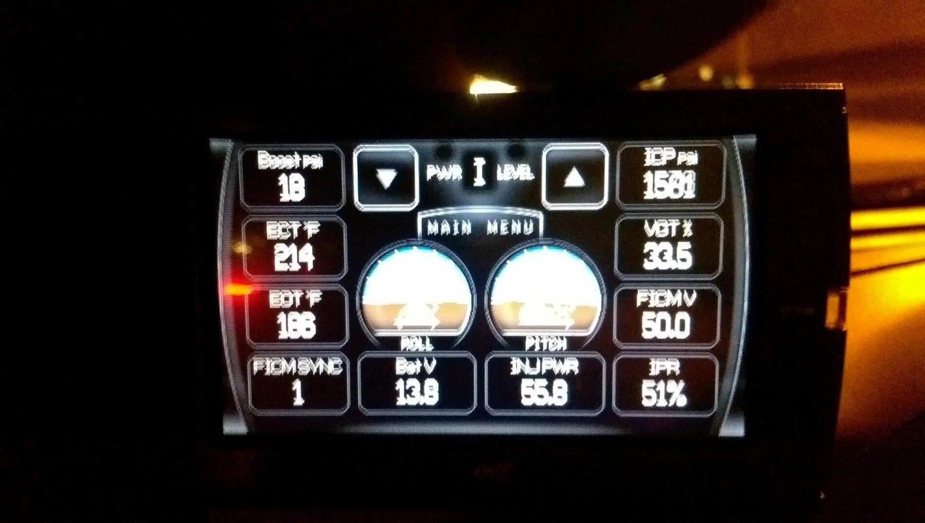

How I'd want it. I'm running a cooler with 3x the volume of the Bulletproof Engineer one. I've never seen more than 212 oil temps fully loaded, on a grade, in the hottest SW US conditions on a 500 rwhp truck.
Jeep Gladiator First towing experience this weekend WP_20171229_006
What cooler?
So, 214/186 at 18psi.
What’s max boost on that?
what’s the JT’s max boost?
