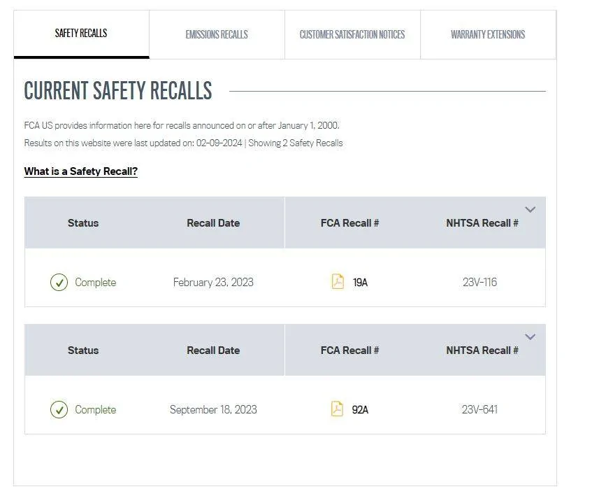

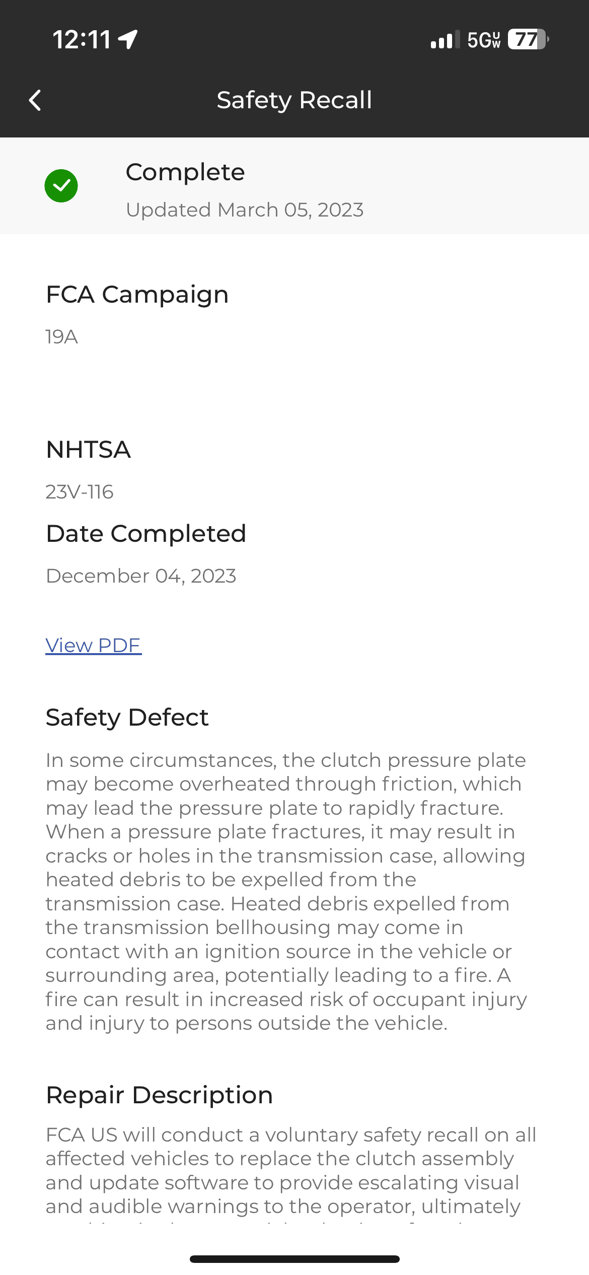

  2. The two manual transmission related recalls were completed for this one by the dealer. Where can I find the details on how they fixed it and dates? I am planning to ask it to the service department when I go in but was wondering if we can look the details up somewhere.

Don’t know about the start/stop (consider yourself lucky), but the clutch recall will be in your Jeep app under “recalls.” I’ve shown mine below, also completed prior to picking up the vehicle new.

As for the two recalls, the 19A requires a clutch assembly change and reflashing a software update to the ECU and instrument cluster.
I believe the 92A required a replacement of the "all gear position sensor" or whatever they are calling it now. The sensor that lets it know which gear the trans is in, if any. Since the selection of the reverse is what makes the reverse camera activate, and federal mandates require a reverse camera, any issue with that switch not activating that camera is cause for a recall.

Thanks. I got the date from the app. Bot got completed in 13th Nov 2023. Will get more details on the visit to the shop next time. Need to see the parts they replaced.
