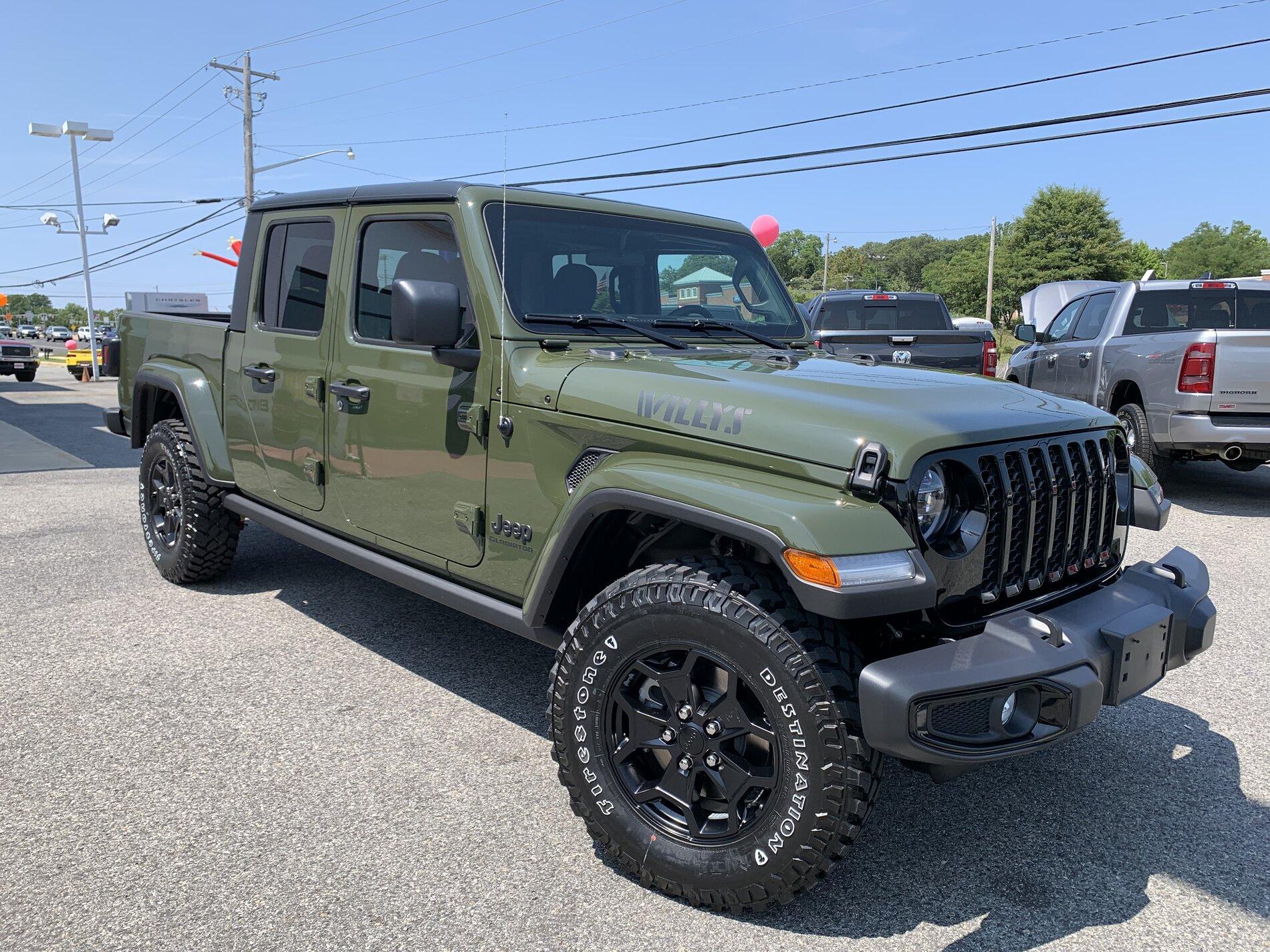

My new Sarge! Planning to keep the rims but going to 285/70R17 Duratrac ( Rubi size), but not sure what to do to lift it a little more.

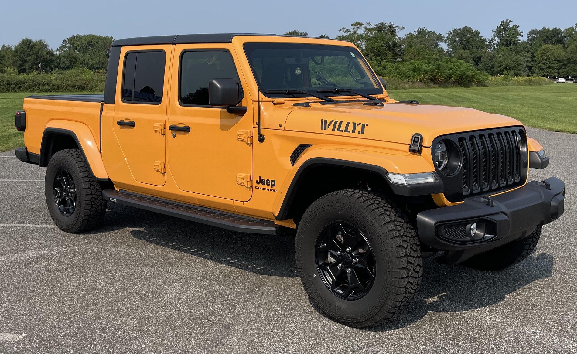

Put 285/70-17 before doing anything else.
Jeep Gladiator My new Sarge! Planning to keep the rims but going to 285/70R17 Duratrac ( Rubi size), but not sure what to do to lift it a little more. 477A14B5-5759-4CC4-B206-EF5314BDDFDF

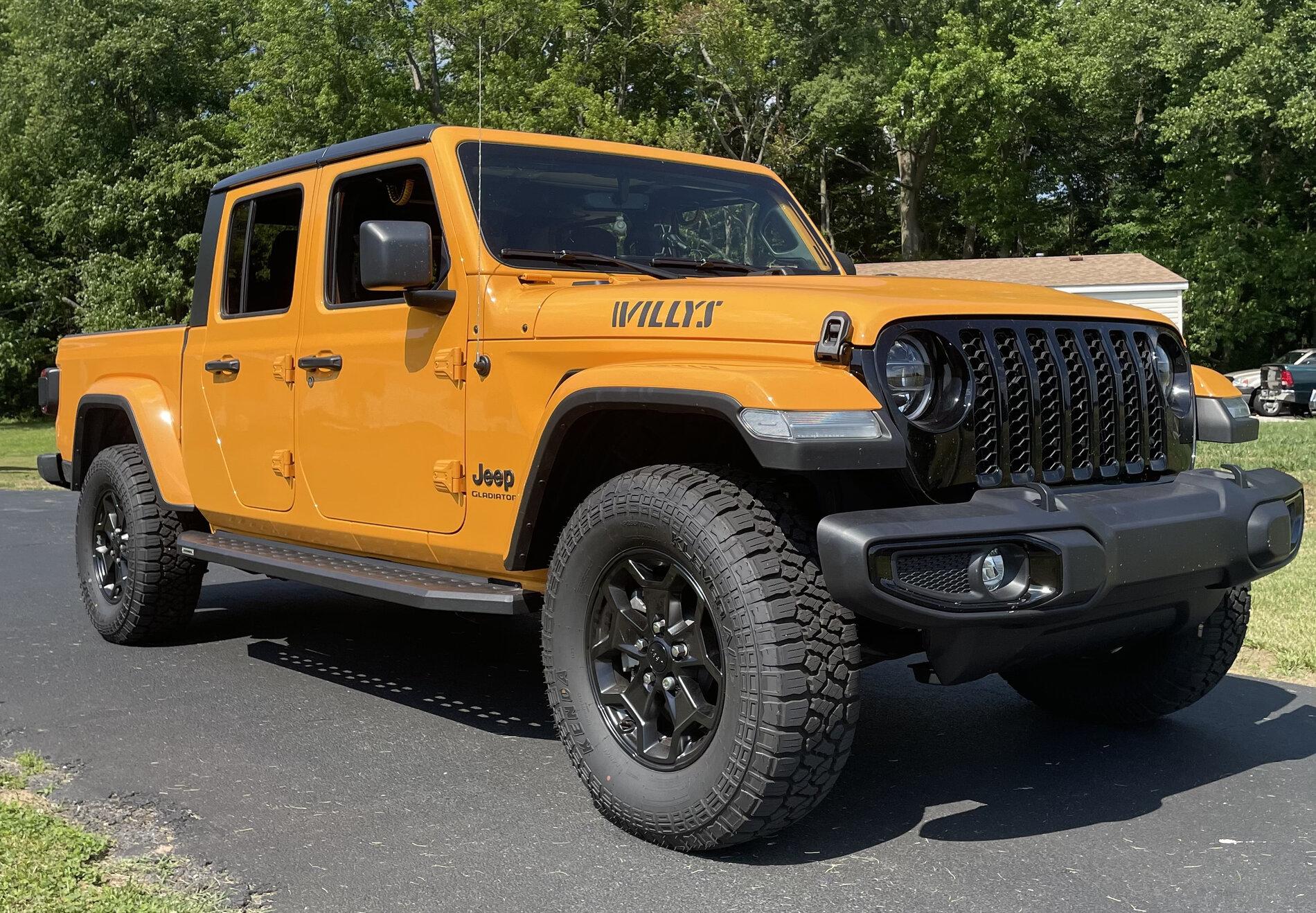

This is after Rubicon shocks, front springs and max tow rear springs.
Jeep Gladiator My new Sarge! Planning to keep the rims but going to 285/70R17 Duratrac ( Rubi size), but not sure what to do to lift it a little more. 860F8973-2F20-4924-9D0D-336CE967555C

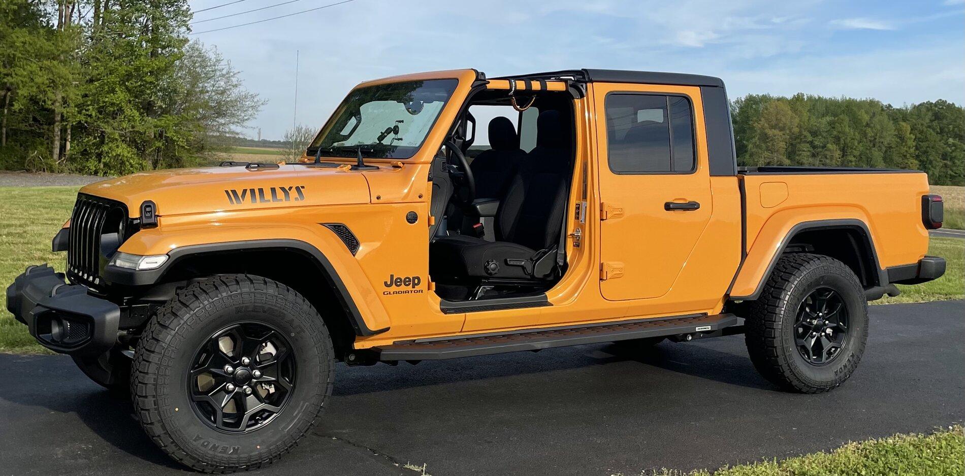

And finally after adding the Teraflex 1" front spacer.
Jeep Gladiator My new Sarge! Planning to keep the rims but going to 285/70R17 Duratrac ( Rubi size), but not sure what to do to lift it a little more. 83E68BD3-1AA0-43CE-927C-DB9AB3214433

Glad yours is a Willys. That’s what I need for ideas. Thanks. I can’t use Rubi models for example ideas, seeing how they are already about 1 inch taller in the front and the fender sits higher.
