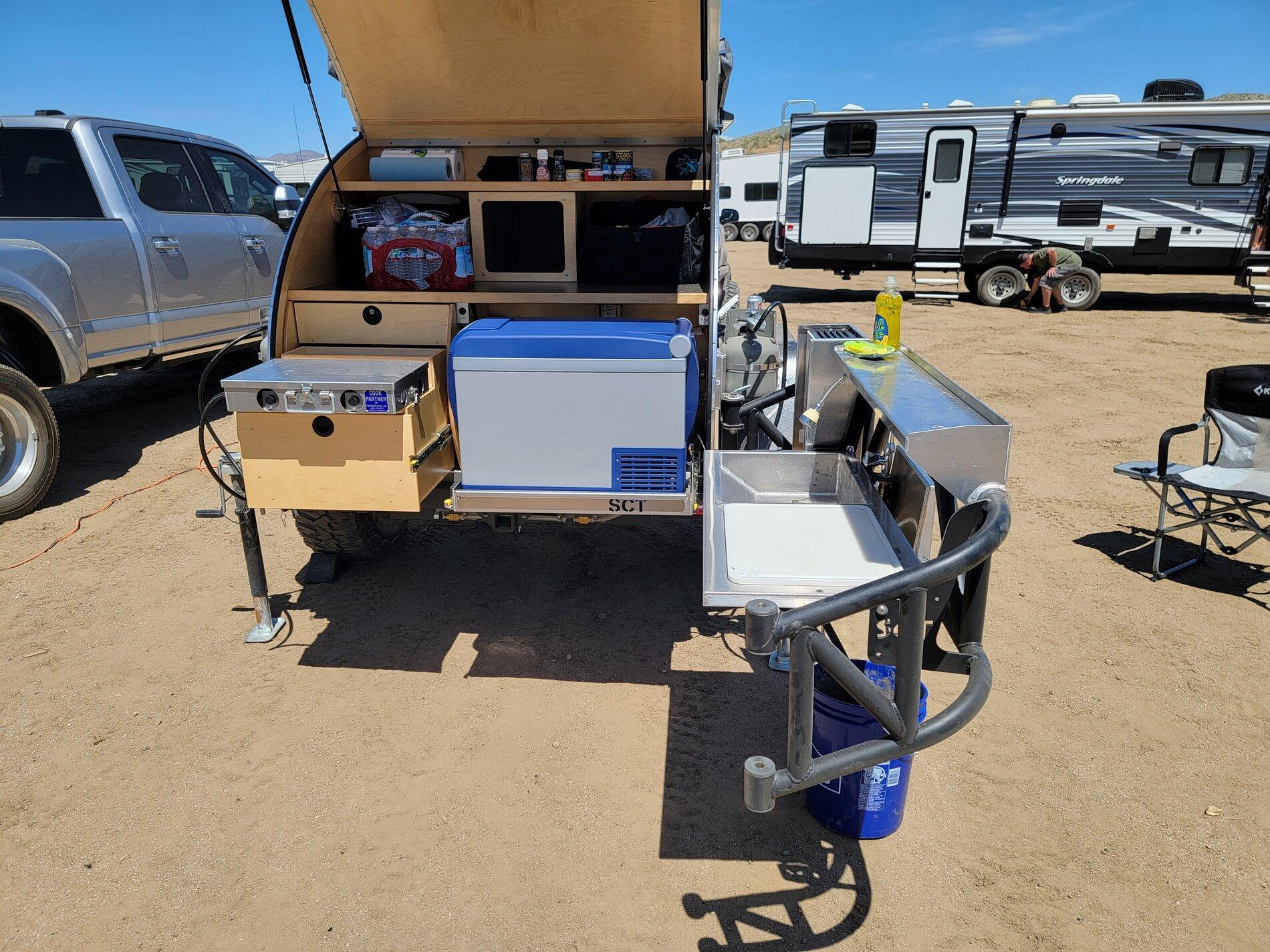

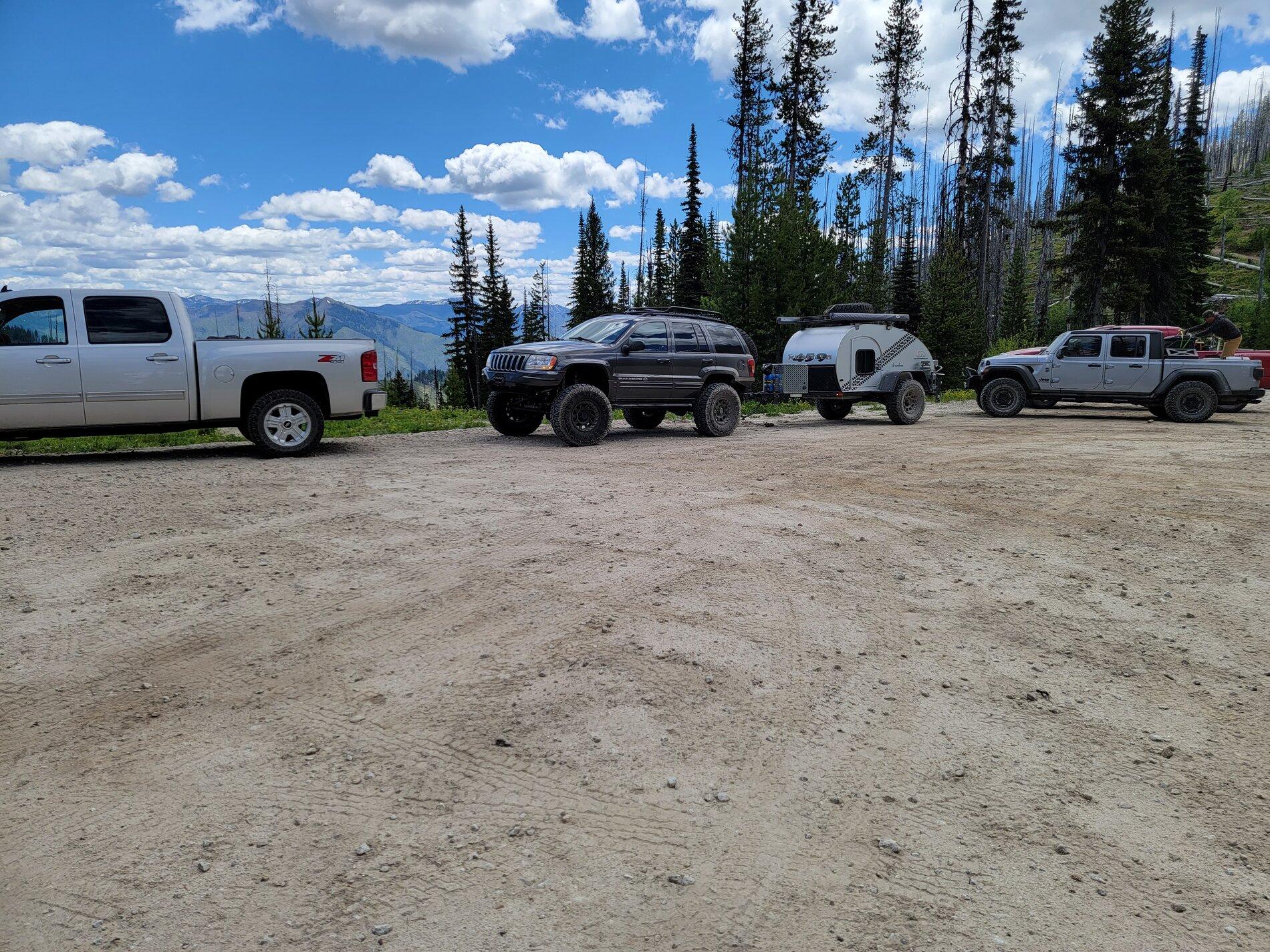

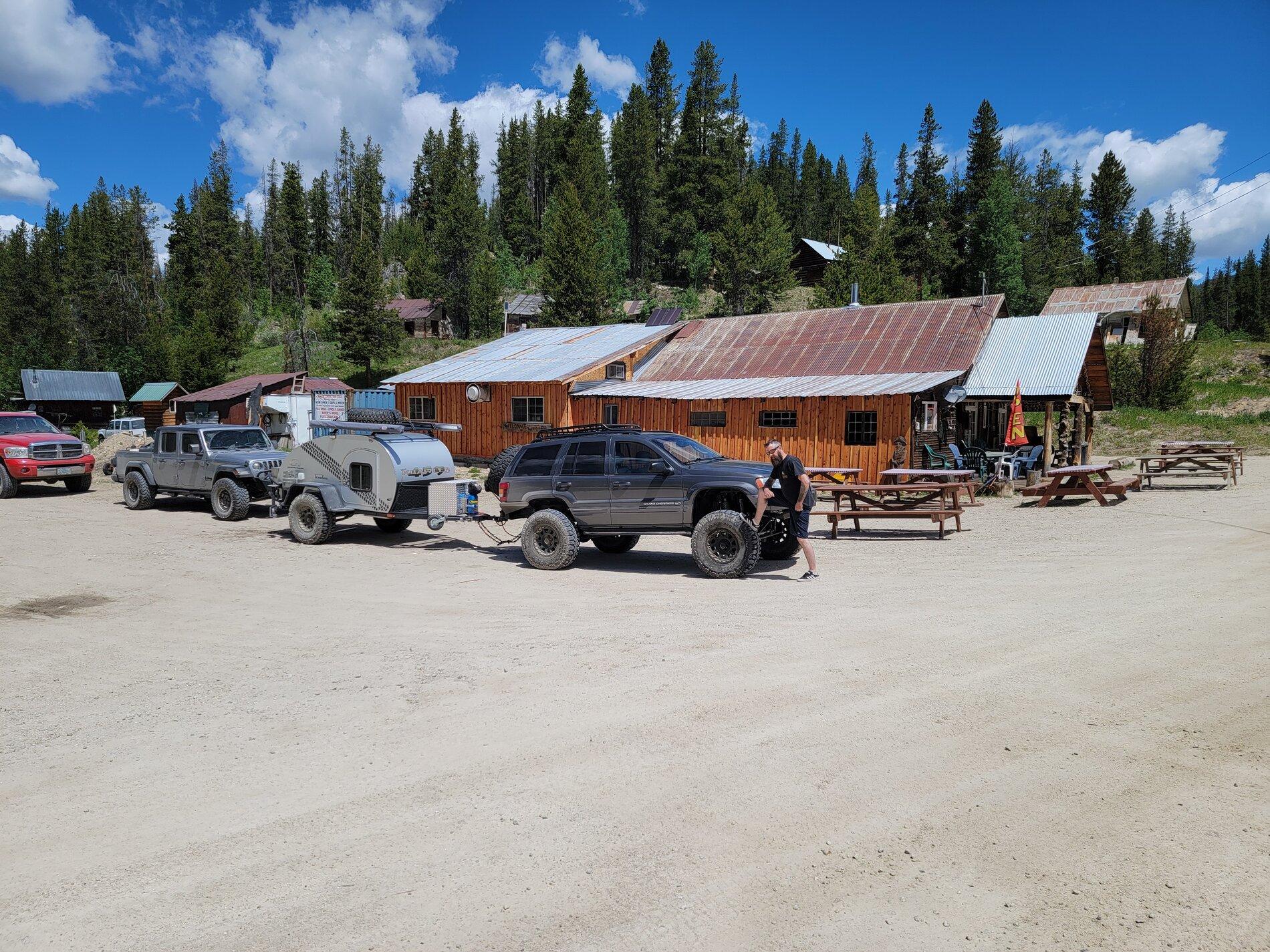

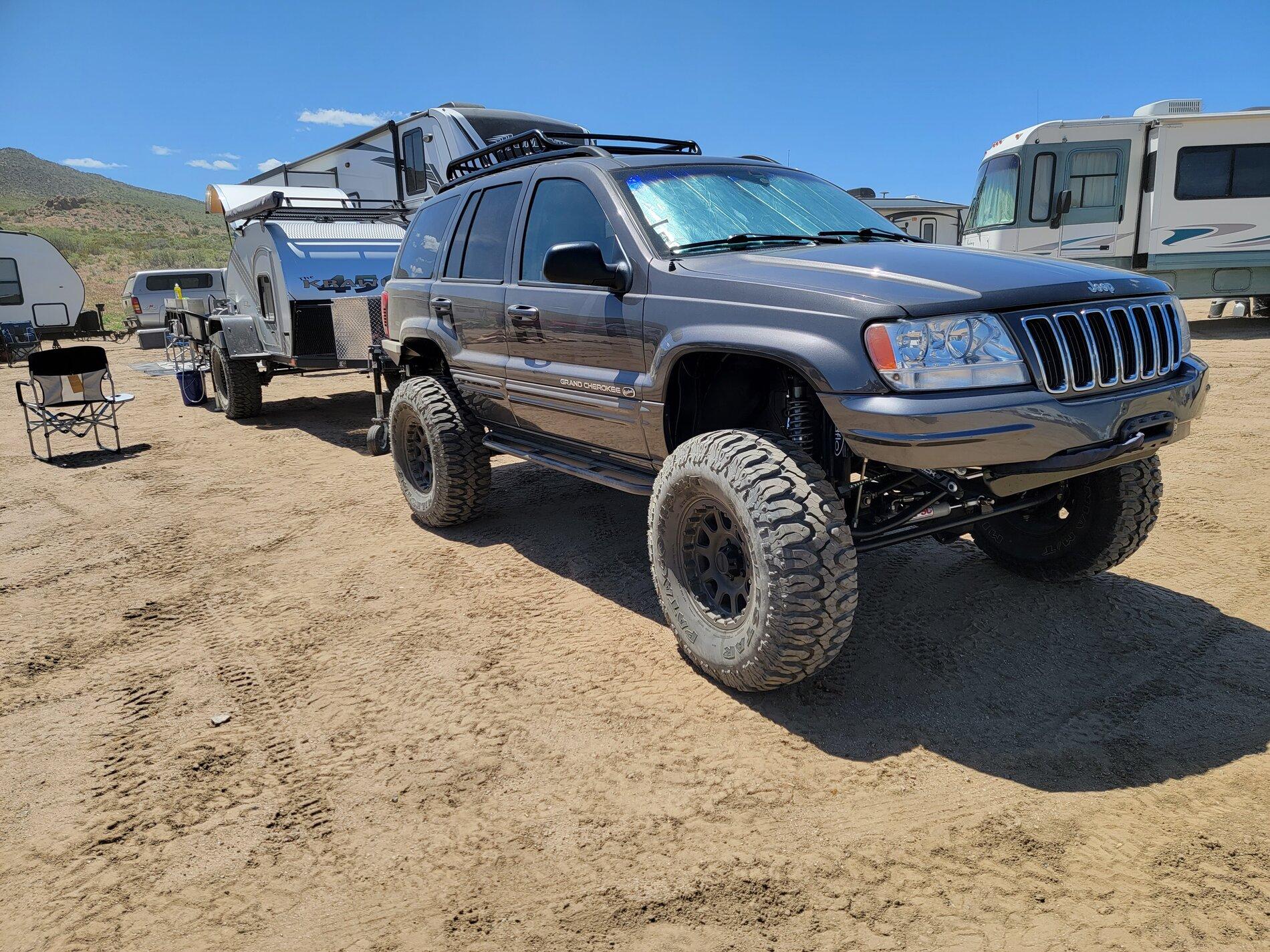

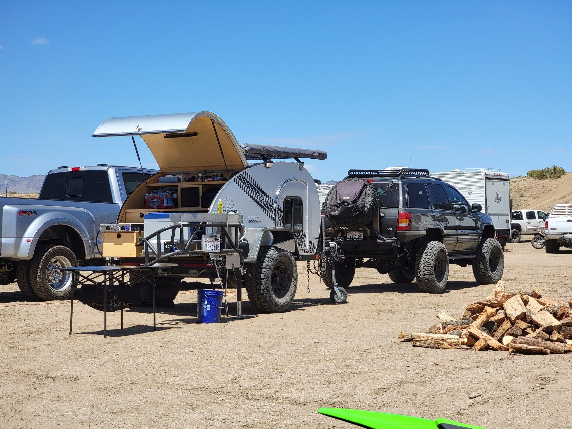

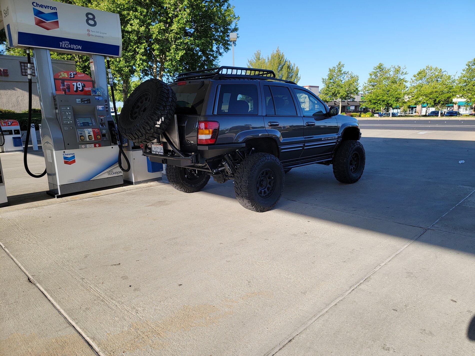

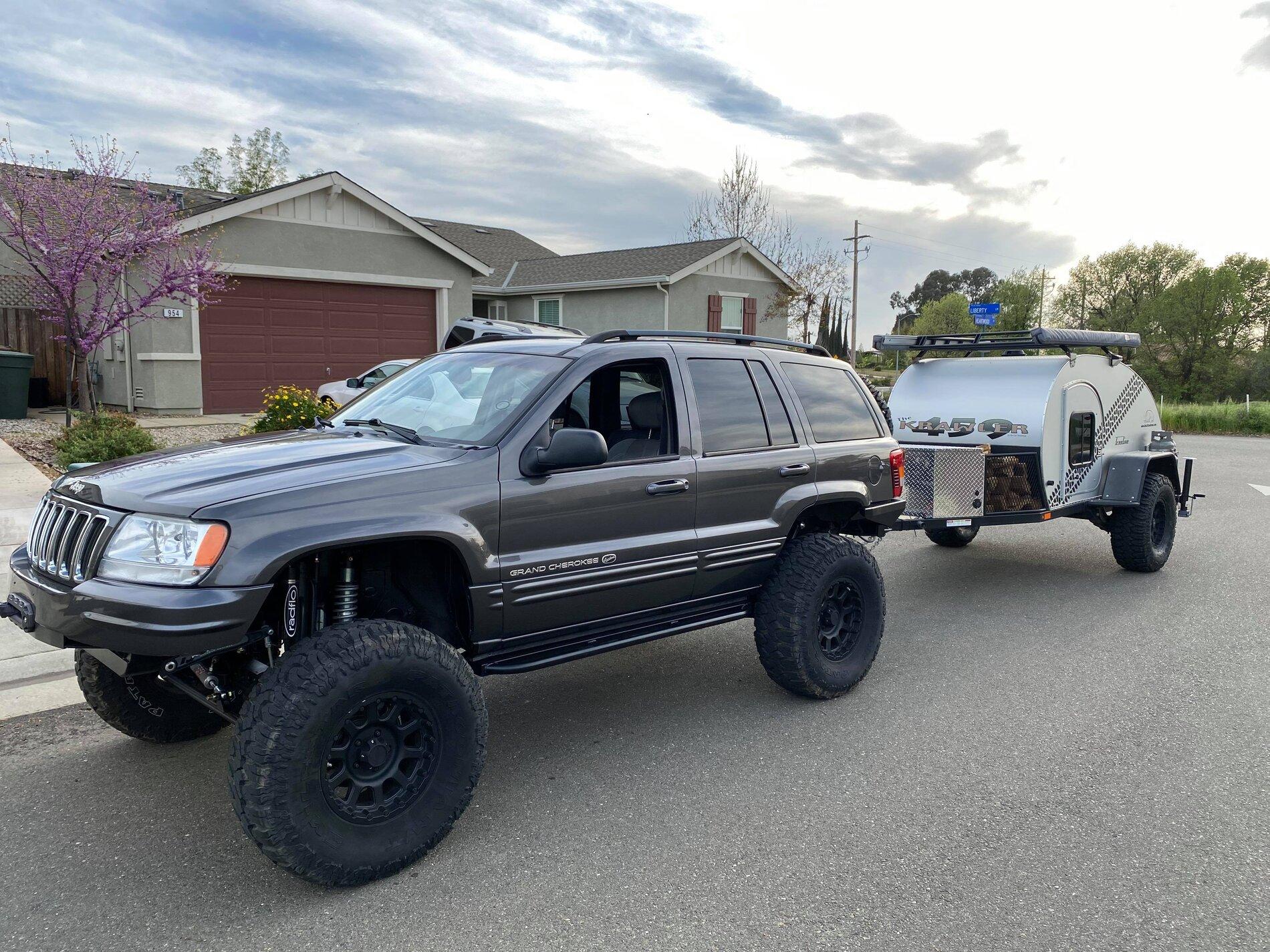

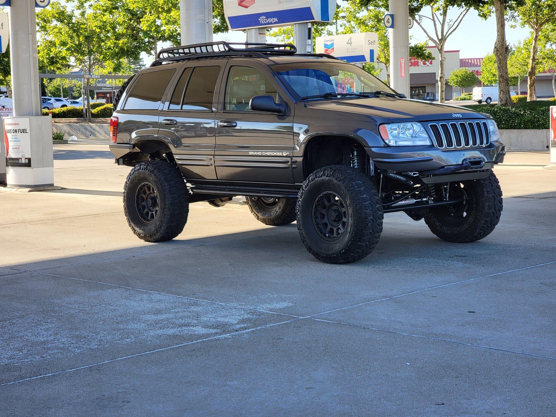

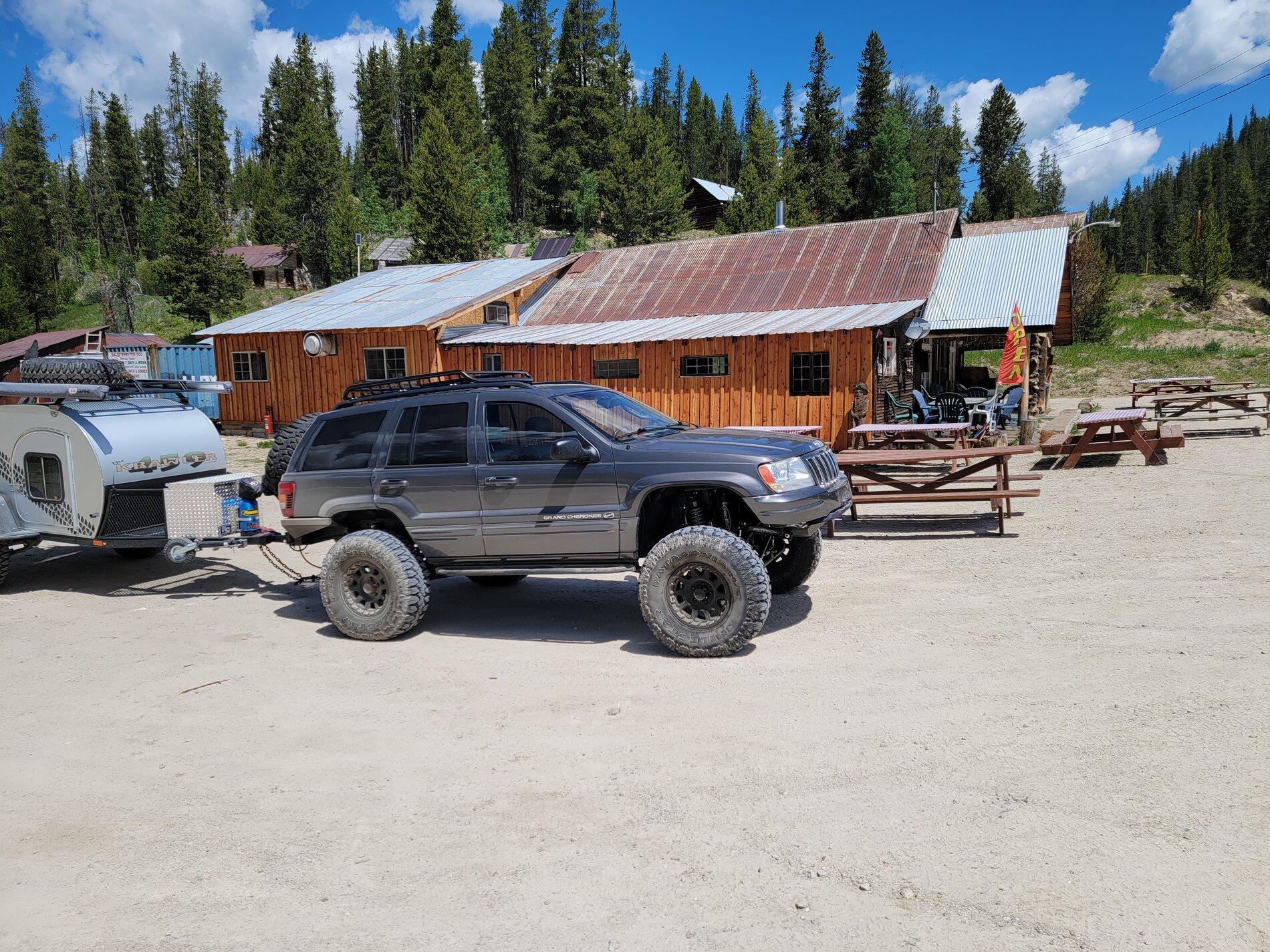

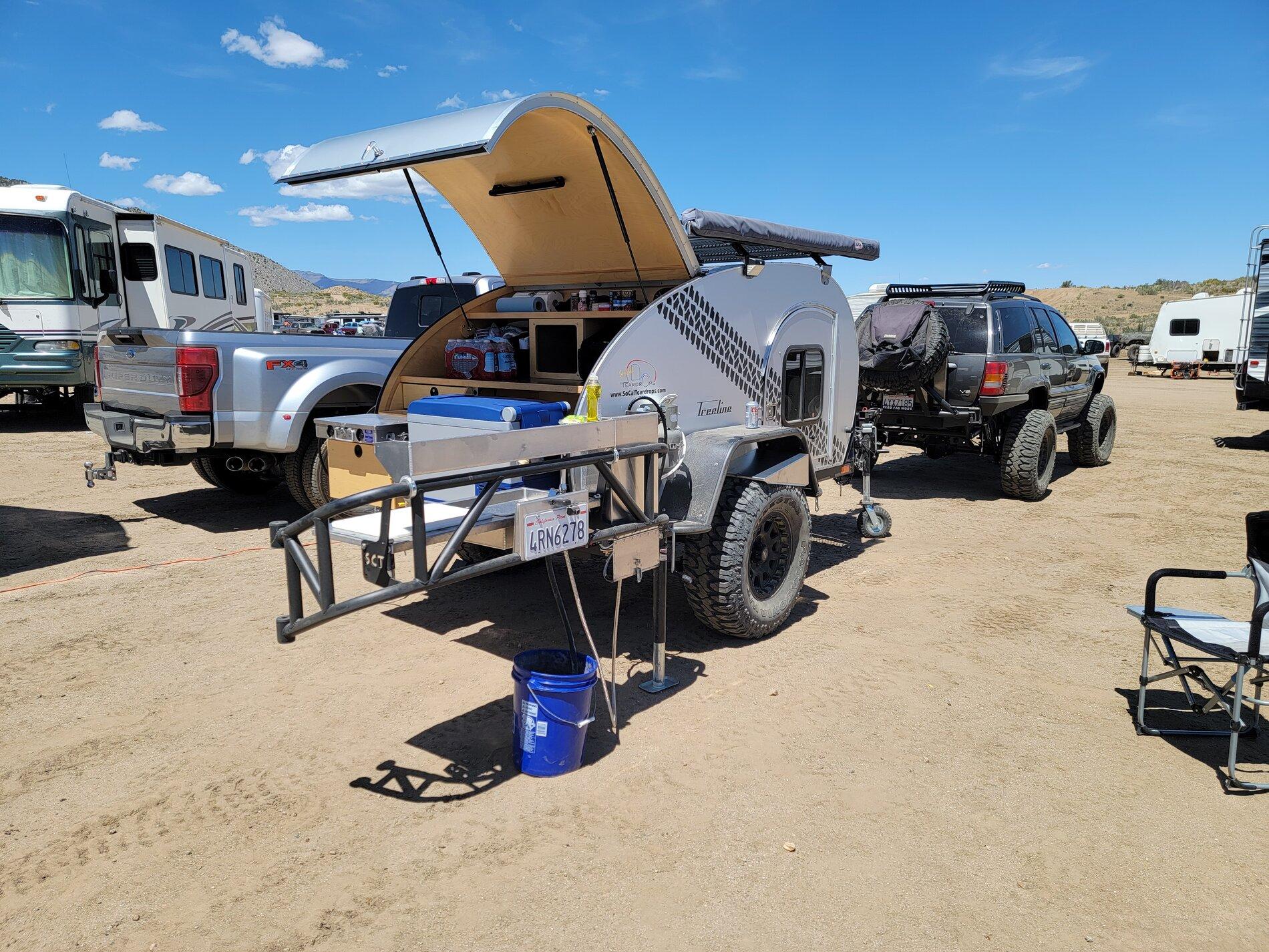

Hi all, I'm new here and doing some research on potentially switching to a diesel Gladiator (Rubicon) from my current '03 Grand. I'd be keeping the WJ, just too much time and money in it, with very little potential return on investment selling it. My use case is towing a small off-road camping trailer mostly in the Sierras. The WJ does a pretty good job (fresh rebuilt 4.7 HO, upgraded cooling system, and a mod list longer than my right arm) but gets warm on long grades (even with all I've done for cooling). I figured a diesel Gladiator would be the *perfect* solution. Having the bed to carry additional gear, fuel, firewood etc. will be super handy, and on trips where I take the trailer I'm not doing anything super-technical where the long wheelbase and long rear overhang of the JT will be a problem (again, I'll keep the WJ for that stuff).
Here's the trailer setup, and the WJ:
