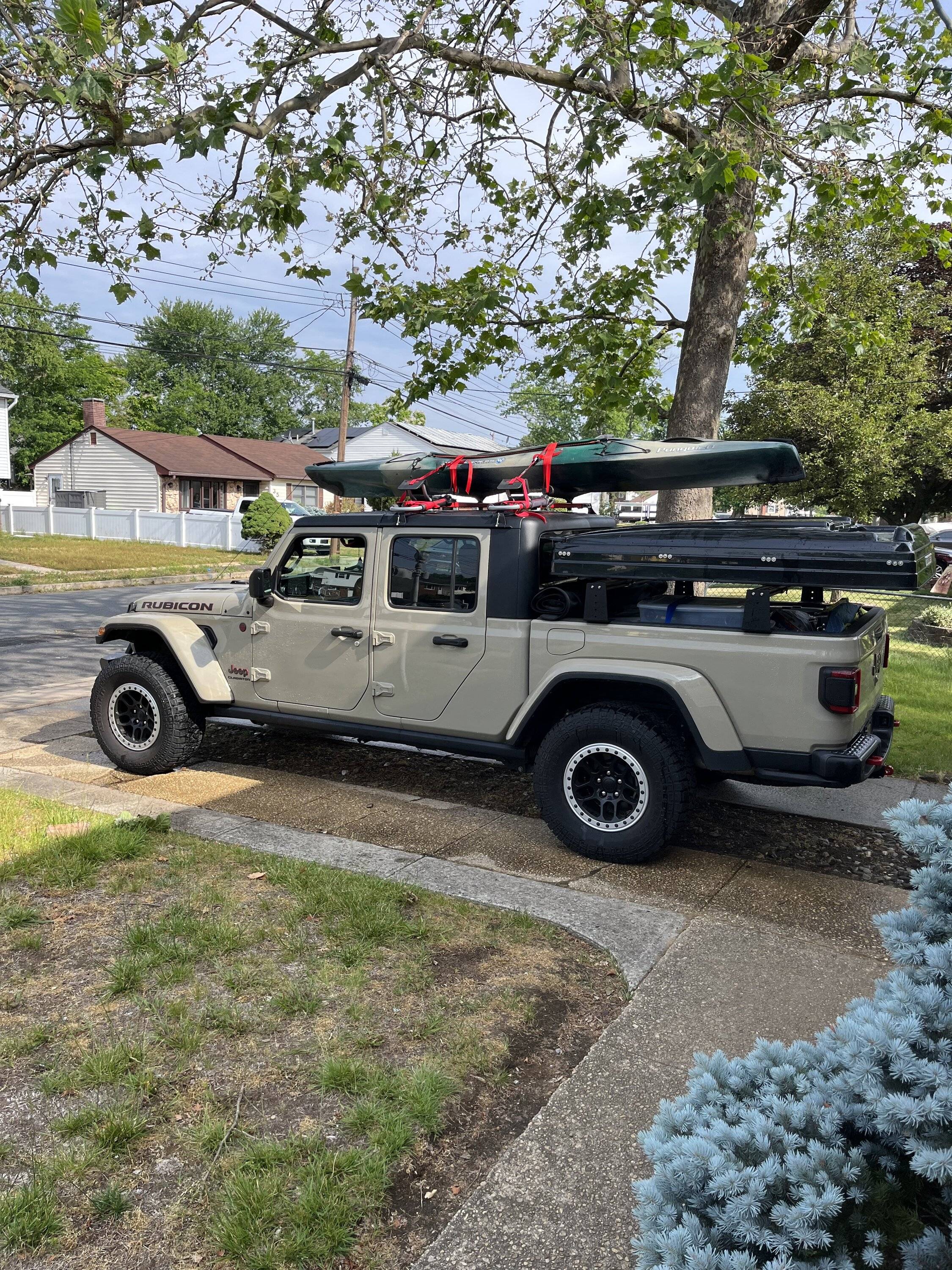

Kayak & RTT can work on the JT.
this look spretty much perfect, what kind of tack is in the back and which RTT? The rack on top is a bit narrow, but wider bars would fix this, to have enough clearance on the side. Hell might even able to carry 2 kayaks
I have 8” Billie Bars over the bed, lets me use the Mopar rollup cover. RTT is the Roofnest Cóndor XL.
