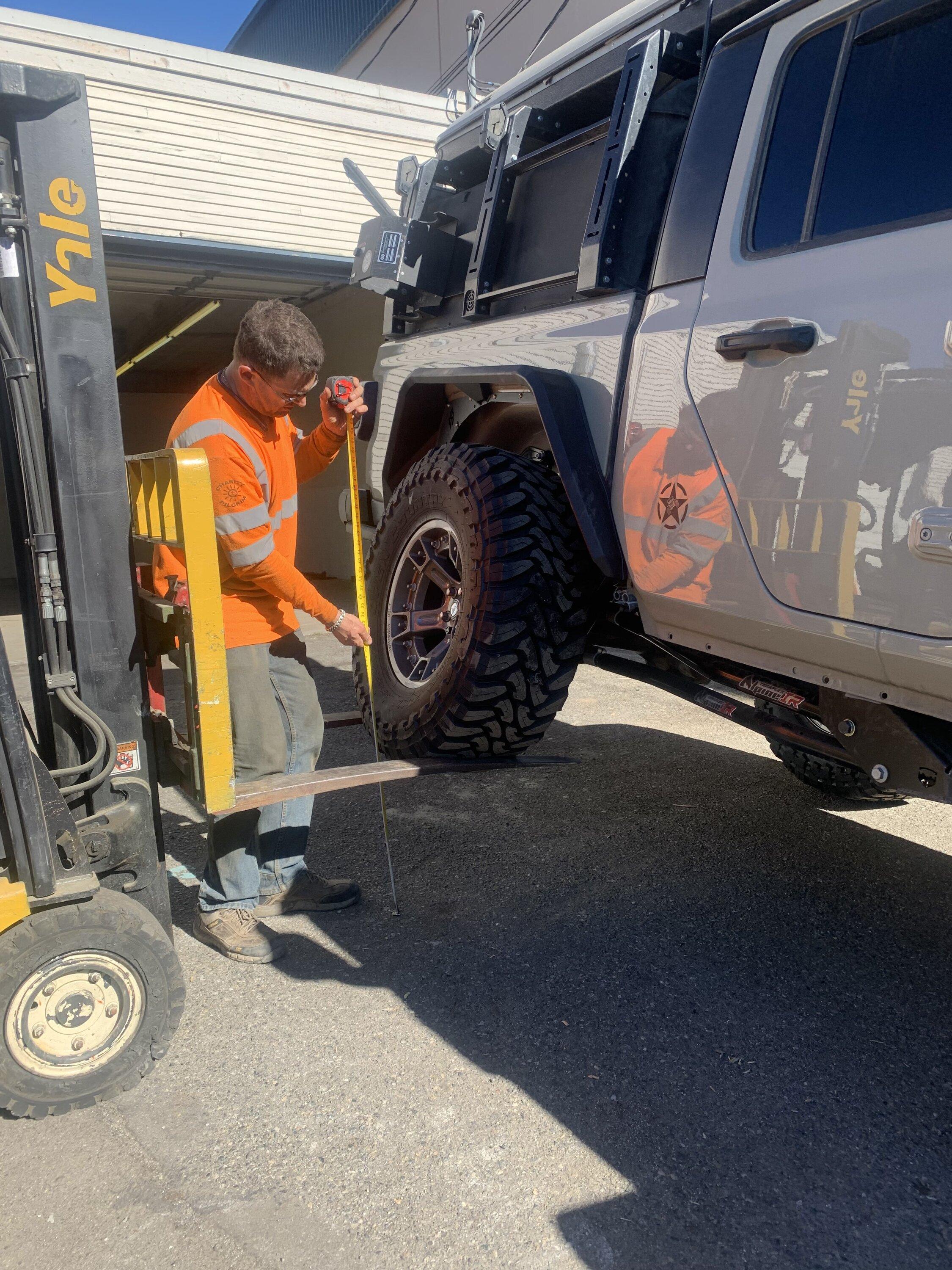

For the rear, the instructions recommend about 4 inches of bumpstops. I slapped on 2.5", and still have plenty of space at full tuck using a forklift.
For the front I'm also running less than the required bumpstops (about 1" if I recall correctly). Also no rubbing even at full tuck.

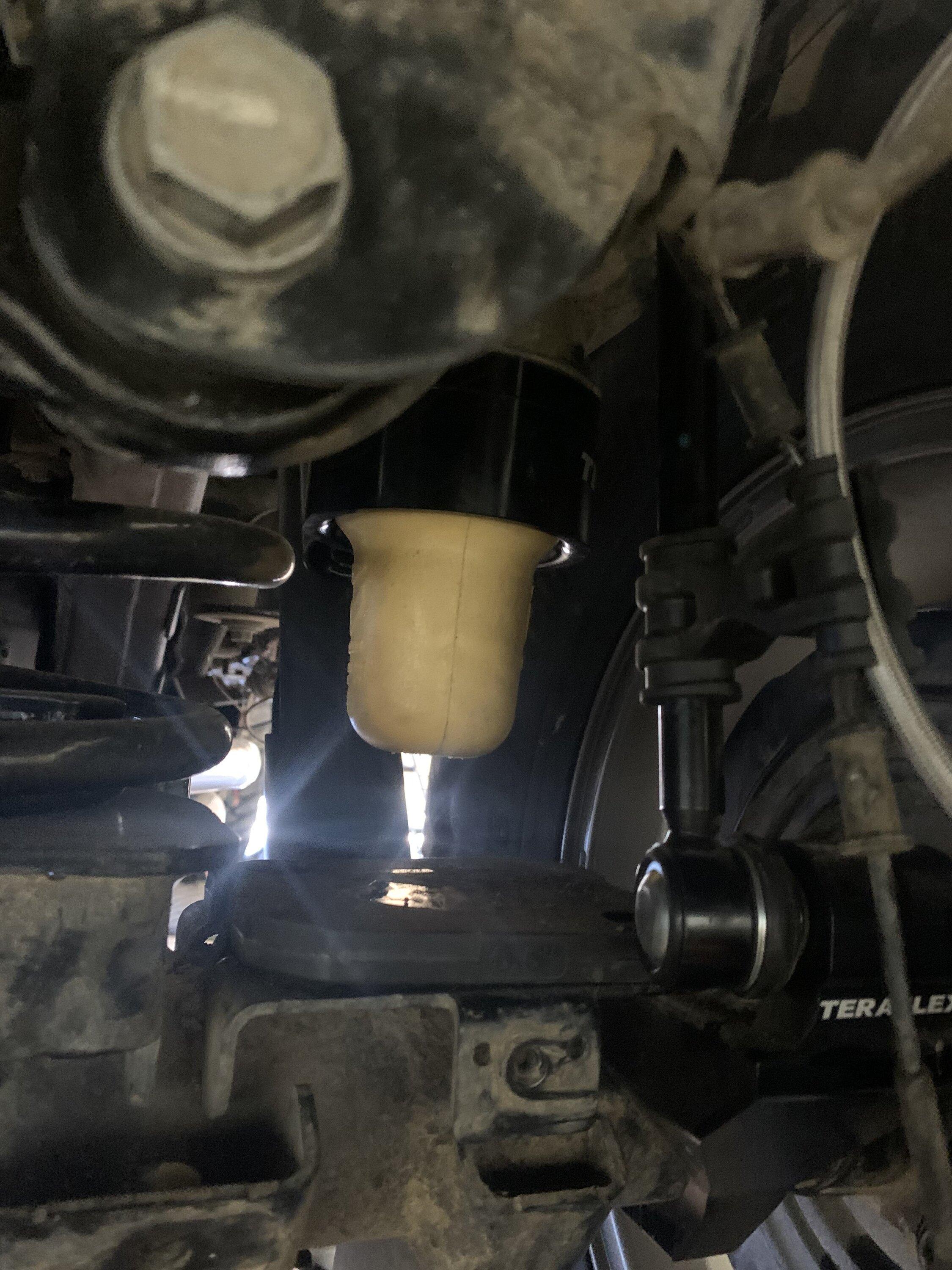

Rear bumpstops at ride height:
Jeep Gladiator Need bumpstop advice after lift: '20 JTR, 4.5" 38s IMG_1449

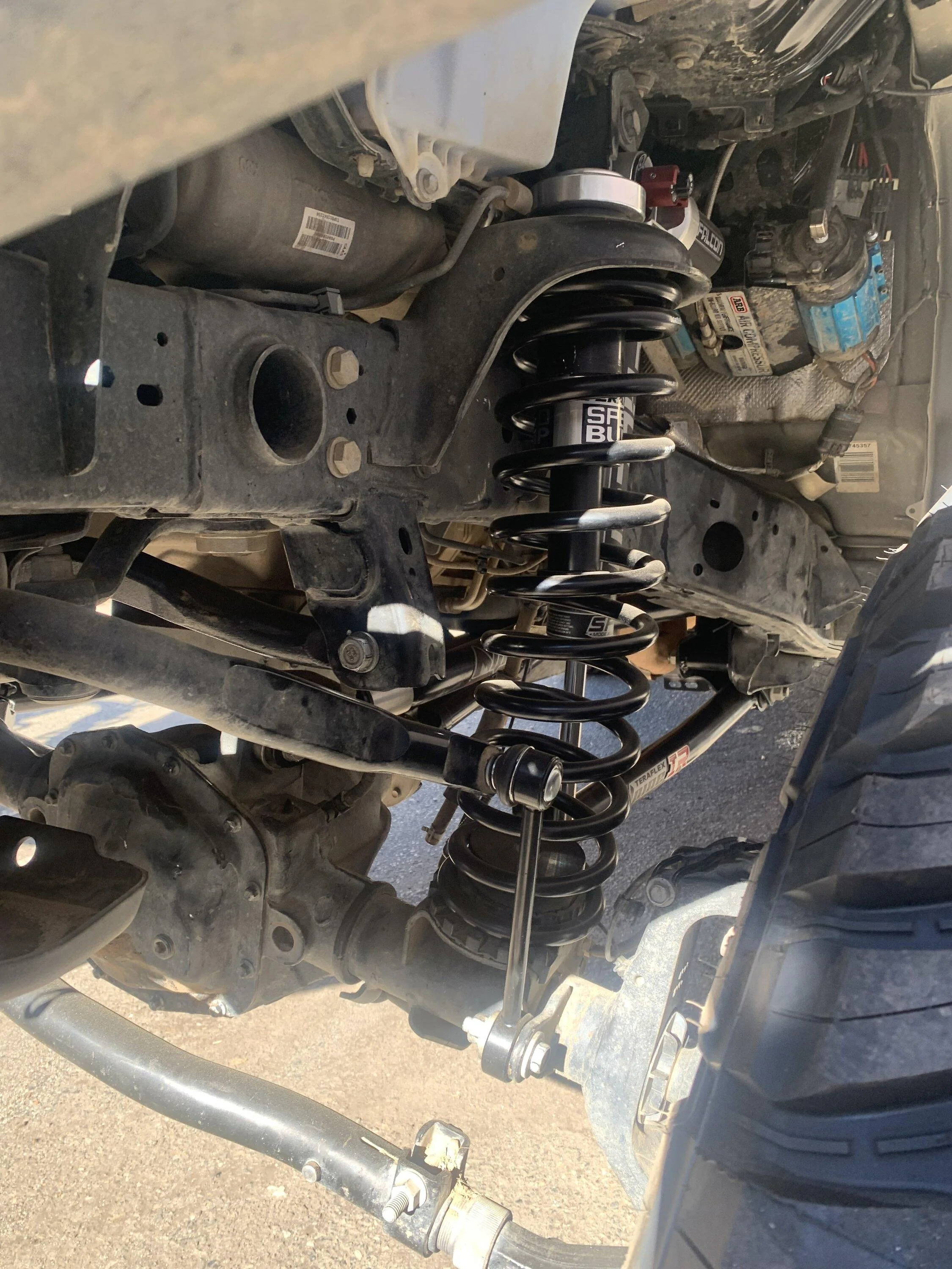

Front bumpstops at ride height:
Jeep Gladiator Need bumpstop advice after lift: '20 JTR, 4.5" 38s 1659904332925

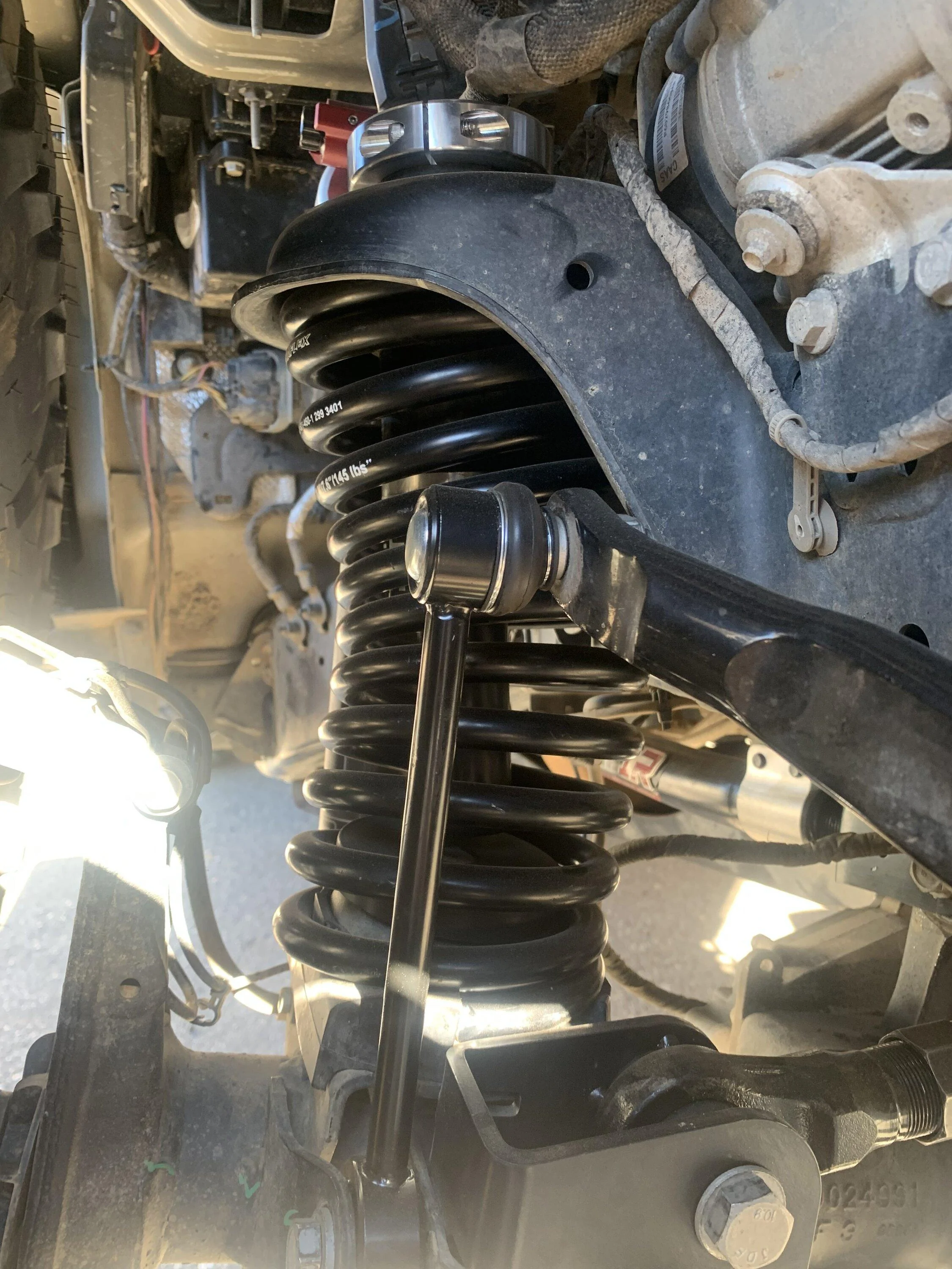

Front at full tuck

The bump stops are to keep your shocks from slamming all the way compressed and damaging them.
Has nothing to do with tuck and rubbing, although that is a side affect.
The people who put together the lift kits have done the math and engineering and list the bump stop height to prevent damage.

Shock travel, coil bind, and any other clearance issues are what you are bumping for.
You might not need anything in the rear depending on coil bind and remaining shock travel.

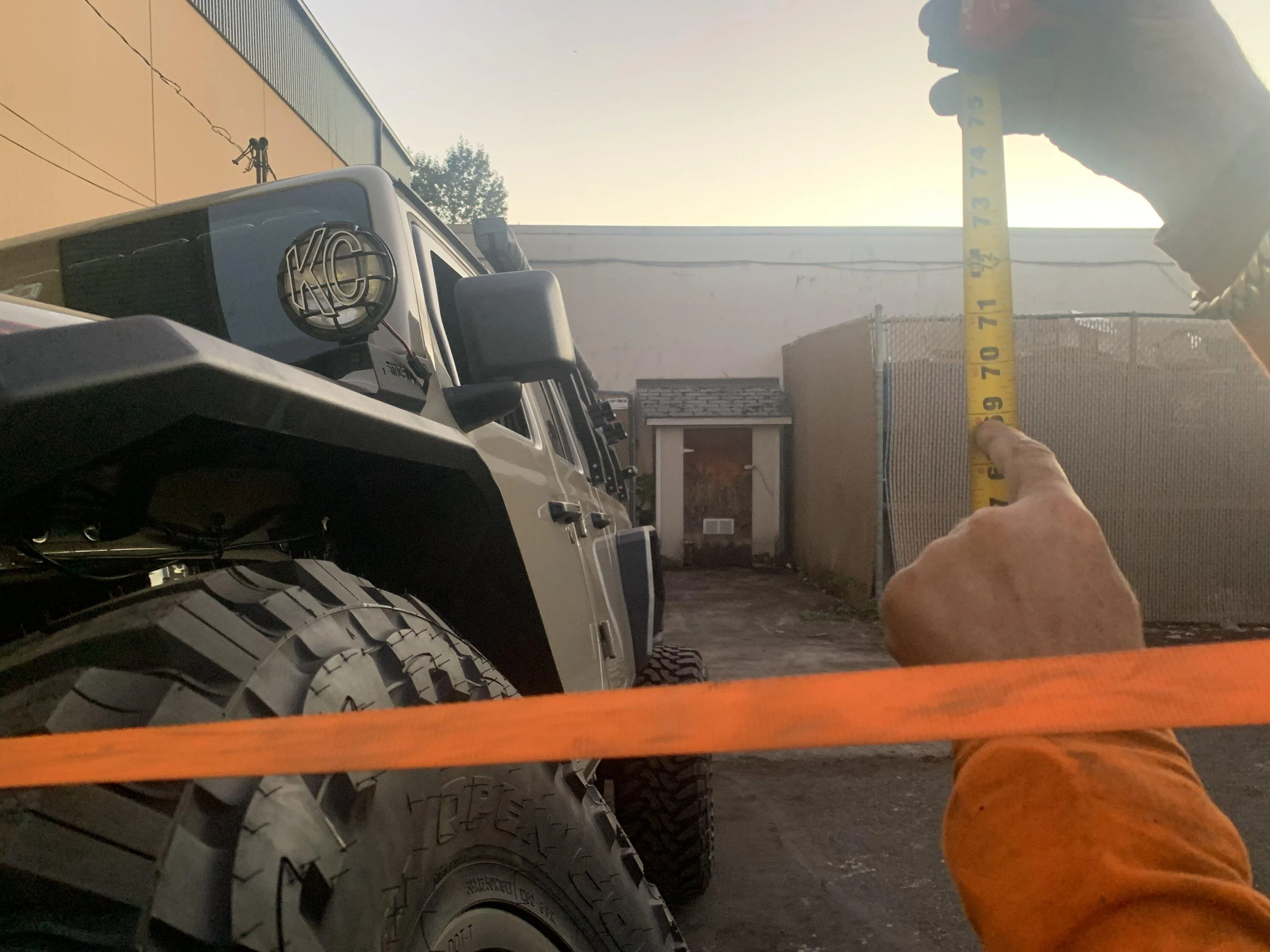

Front at full tuck:
I have never seen anyone measure ground to top of tire when flexing…. Usually it’s ground to bottom of the tire. ??
Op- there are a lot of variables when setting bump stops. Tires- wheels- suspension- to include variations with springs, and shocks.
At a minimum- pull the springs on the front axle. Re-attach your shocks no springs…. You will want to droop one side and stuff the opposing side and check for clearances. Then stuff the entire axle up.
You do not want your shocks either together or one side to be the stopping factor for how far the axle can be stuffed up.
Usually leave 1/4” shock shaft if you are using hydro bump stops.
If you are using factory bump stops (or similar) personally I pull them off! (For clearance checking…) when the metal of the joust mount touches your bump stop pad this simulates full max compression of the factory jousts…. (With a little safety factor). Again leave 1/4” shock shaft minimum showing if the rest of your clearances are fine.
Once you have checked everything, you can determine the height of your bump stops.
I like to use hokey pucks while I’m monkeying with setting everything….. then once it’s finally blessed and not getting touched I order 3” diameter aluminum and make my final pump stop height with that.
(This was pre economic crash- so I haven’t looked to see what aluminums at. Usually I can get 12” for around $50…. Today it might be close to $300… :( )
Over compressing springs is another issue- each manufacturer is going to have a full extended and full compressed coil length- so you are going to have to reach out.
some times the coils will bend when compressed to a certain point. This can cause the spring to catch on what could be several things…..- sometimes this can be helped with spring wedges….. sometimes bump needs to be increased.
bump stops are important…. A lot of folks over look this and are either missing out on a couple inches of “would be nice” up travel…. Or worse! Push an axle/truss into the oil pan.

Another trick I use when forklift testing flex is to leave the front bar connected while testing to force more rear stuff. Then disconnect for front testing.
