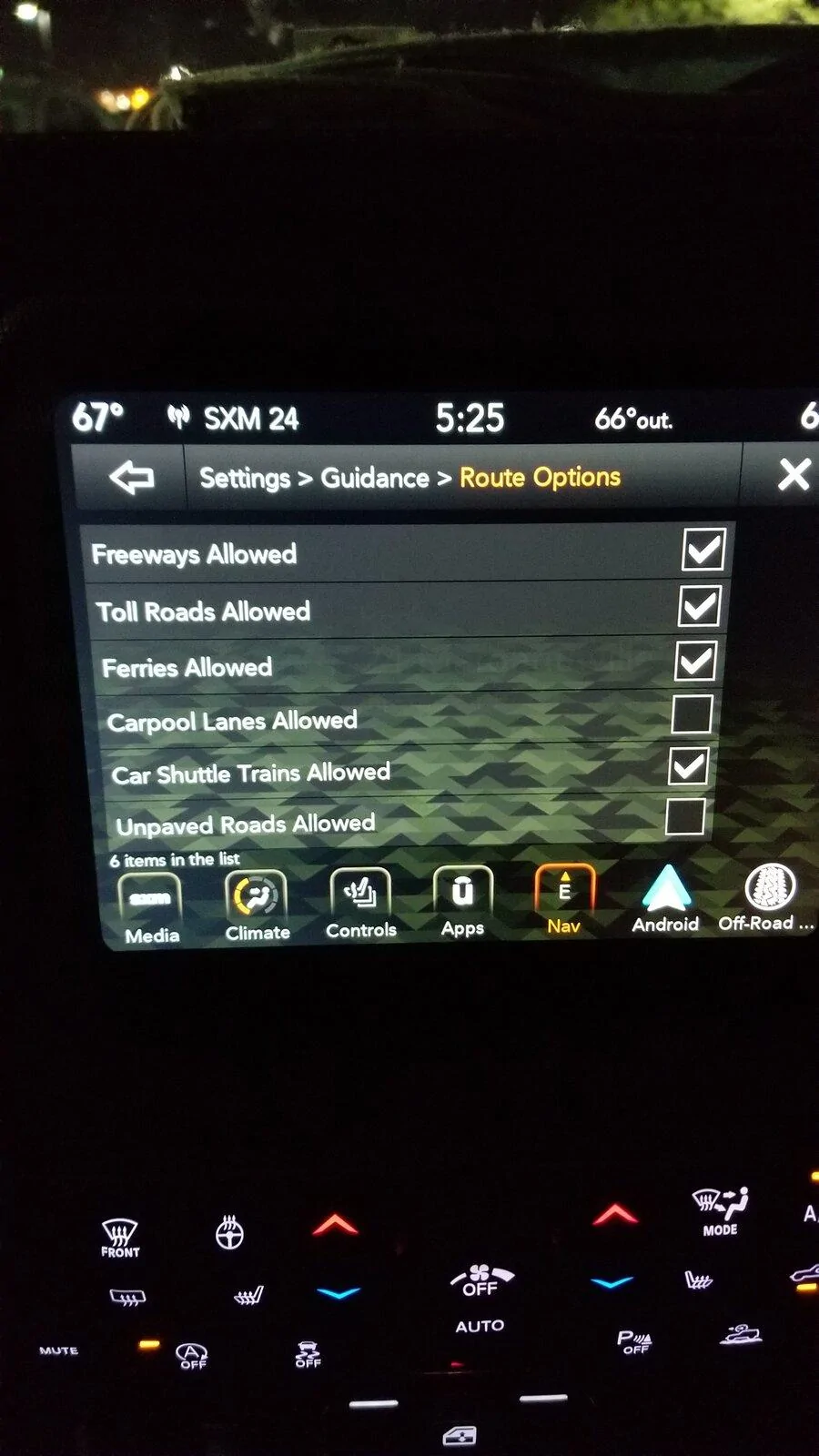

Hey everyone got a silly question. My GPS somehow got set to street only and dose not like freeways, I’ve looked everywhere to find how to change it, and I can’t seem to locate it. I’m willing to rest to default if that’s what’s needed but I can’t find that either. Anyone know how to change this?
Also, when using XM, I have favorites set, and sometimes I’ll get the notification that one of my songs are playing, and when I click it, it’s empty. What are these gremlins up too ?? Can this be fixed?

The Favorites can be fixed with a software update. They sent me the latest version to load when I ordered the Map update that was on sale in August. I never tried using the Favorites until after loading the update, but it works like it is supposed to.
I'll look at mine. There should be an option inside the NAV program to adjust the settings.
