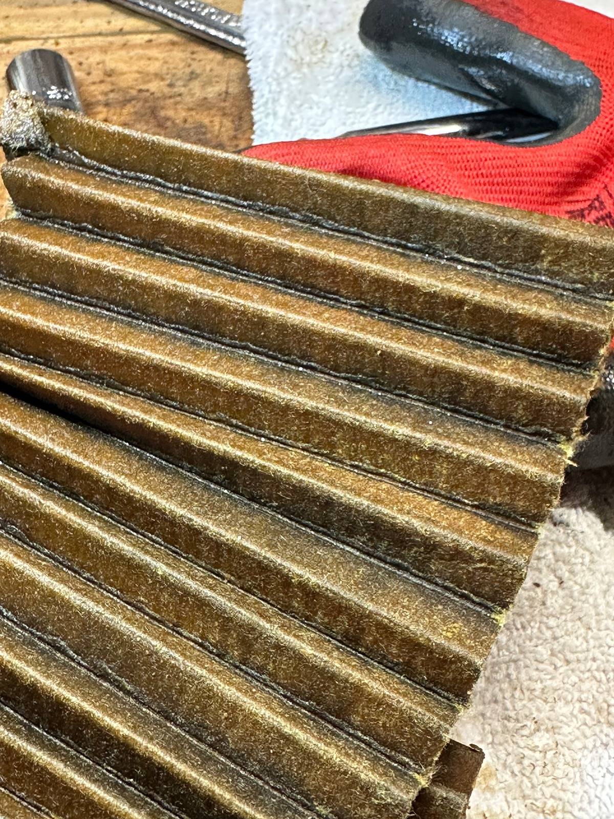

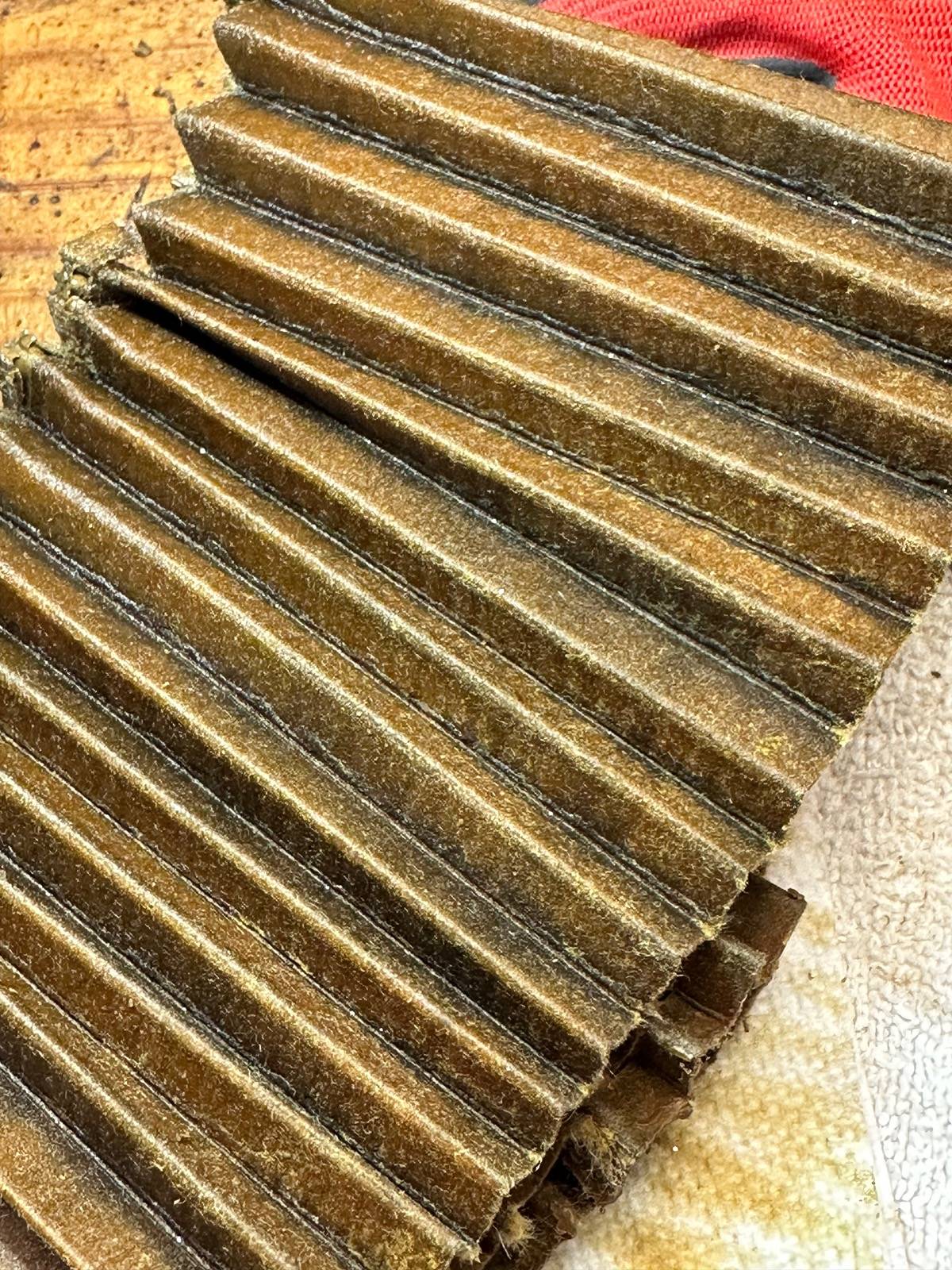

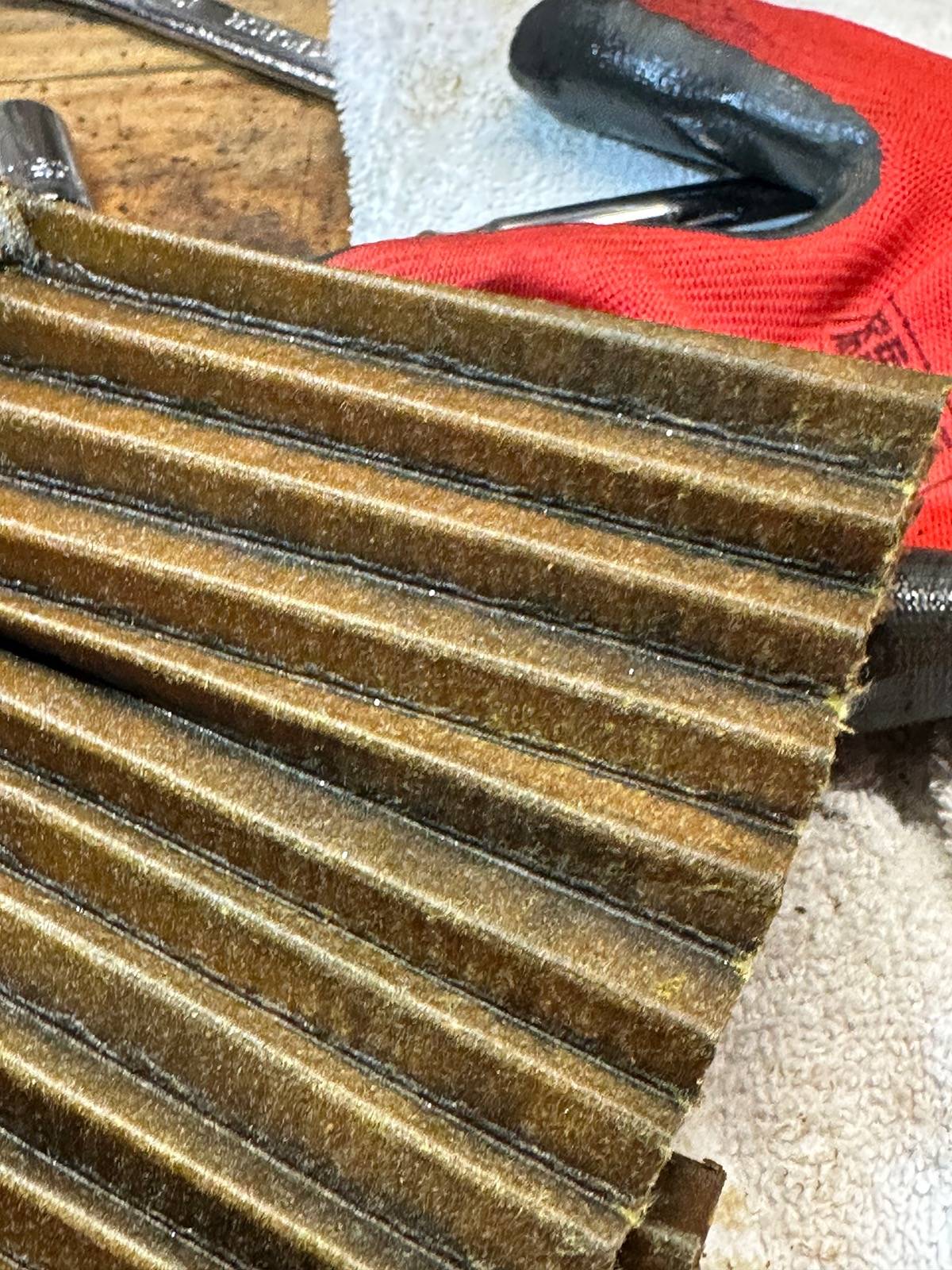

Looks to me like the filter doing filter things.
What type of cleaner did you run and why? To me, they are just snake oil.
I ran the MotorMedic synthetic cleaner… not the best on the market but the Jeep was a rental (which we found out after) so I am trying to take extra care of it as I plan on keeping this for a long time… plus building it up!

Looks good to me. If you have OCD. Go to 5K on your oil changes.

Looks fine to me. Agree with others, If nothing seems off. I would just do the oil analysis, if you want to confirm. 👍🏼

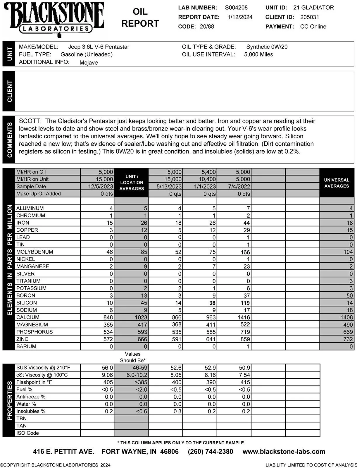

Grabbing a sample for testing would be tricky now, so run it to the next change and then get an analysis done.
Blackstone runs 4-5 weeks on results now I believe.
Not sure on the other one posted.
If you send a sample, be sure to tell them what additives / cleaners you used.
Here's my last Blackstone report. I am still waiting on the 25,000 mile report, but it's only been sent off for a few days.
Jeep Gladiator NEED HELP!!??!! 20000 Report
