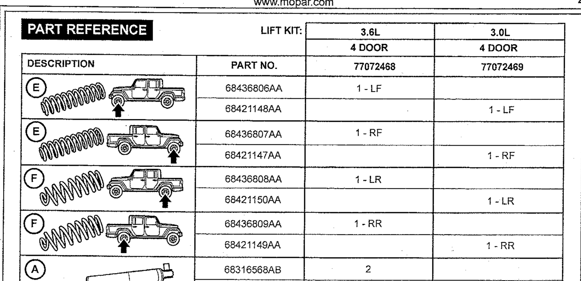

I just brought my Jeep into the dealer to look at my steering issue. They just got back to me and told me it is caused by my front springs from my Mopar lift. Said they were installed on the wrong side of the Jeep. I really dont think this is a thing, but could you guys please let me know if it is?

I'm pretty sure there is a correct drivers side and passengers side spring. See attached, they have different part numbers.

Crap, yea I just saw that in the instructions....I wonder if that's the actual cause. They said it was causing the bumb steer

It does have different springs for right/left, but probably isn’t causing a steering issue. Might cause a lean...

Mine is slightly lower on the passenger side but I double checked the spring part numbers probably 20 times before moving on with the lift install so no clue.
