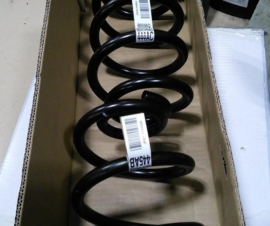

Here are the numbers of the MT springs I put under the rear of my JT
Jeep Gladiator Need Spring number help Maxtow, going on Mojave! In process! JT-mt-springs

Yes mine must be 2022, they have way different number and a lot of plastic isolators top and bottom also. Thanks Shadow.
