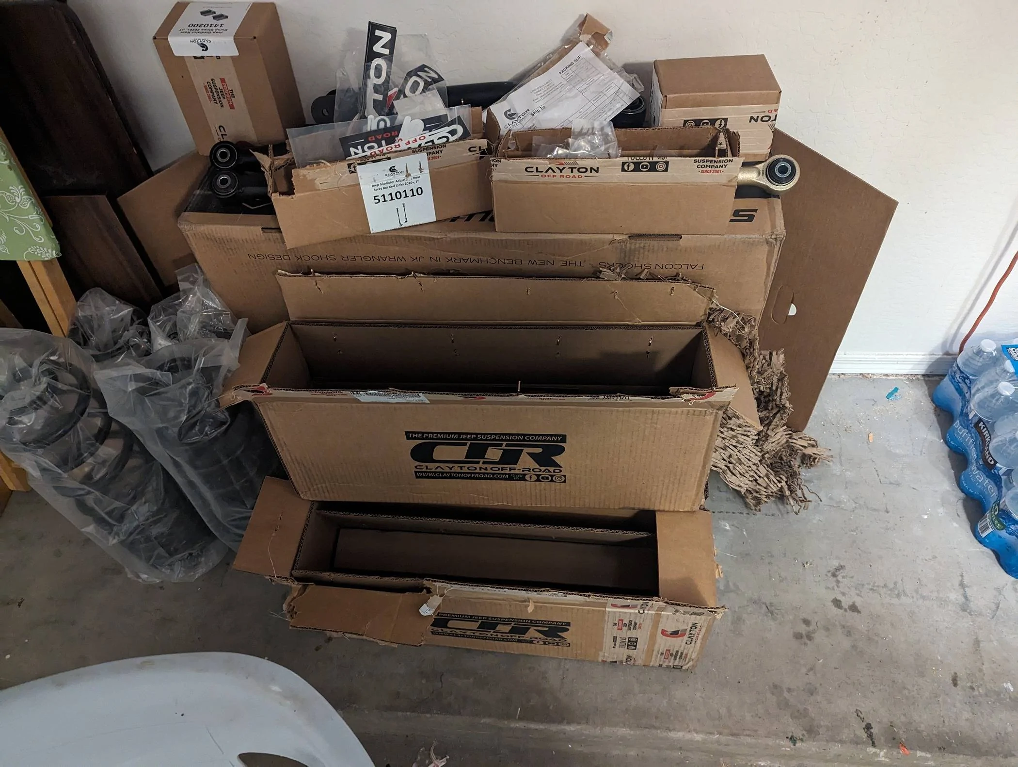

I initially just did the Clayton 2.5" Ride Right lift, then I ordered the control arms, then some other stuff, so essentially what I got was the Clayton 2.5" premium lift kit here, except I went with the Fox ATS 2.0 steering stabilizer, but got all the other components..... https://www.claytonoffroad.com/product/jeep-gladiator-performance-packages-jt-premium I should have just bought it from the beginning in the package, but oh well.
Jeep Gladiator New Owner/New to Jeeps, Things Just Got Expensive But Fun, Looking for Advice PXL_20240315_042117260

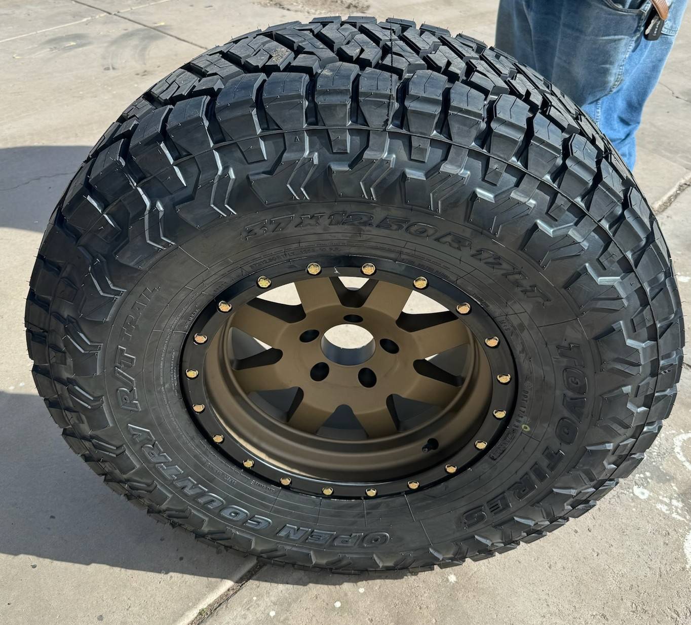

I then got a set of Raceline Defender in 17x9, and Toyo Open Country R/T Tires in 37x12.5.
Jeep Gladiator New Owner/New to Jeeps, Things Just Got Expensive But Fun, Looking for Advice Raceline and Toyo Jeep Tires

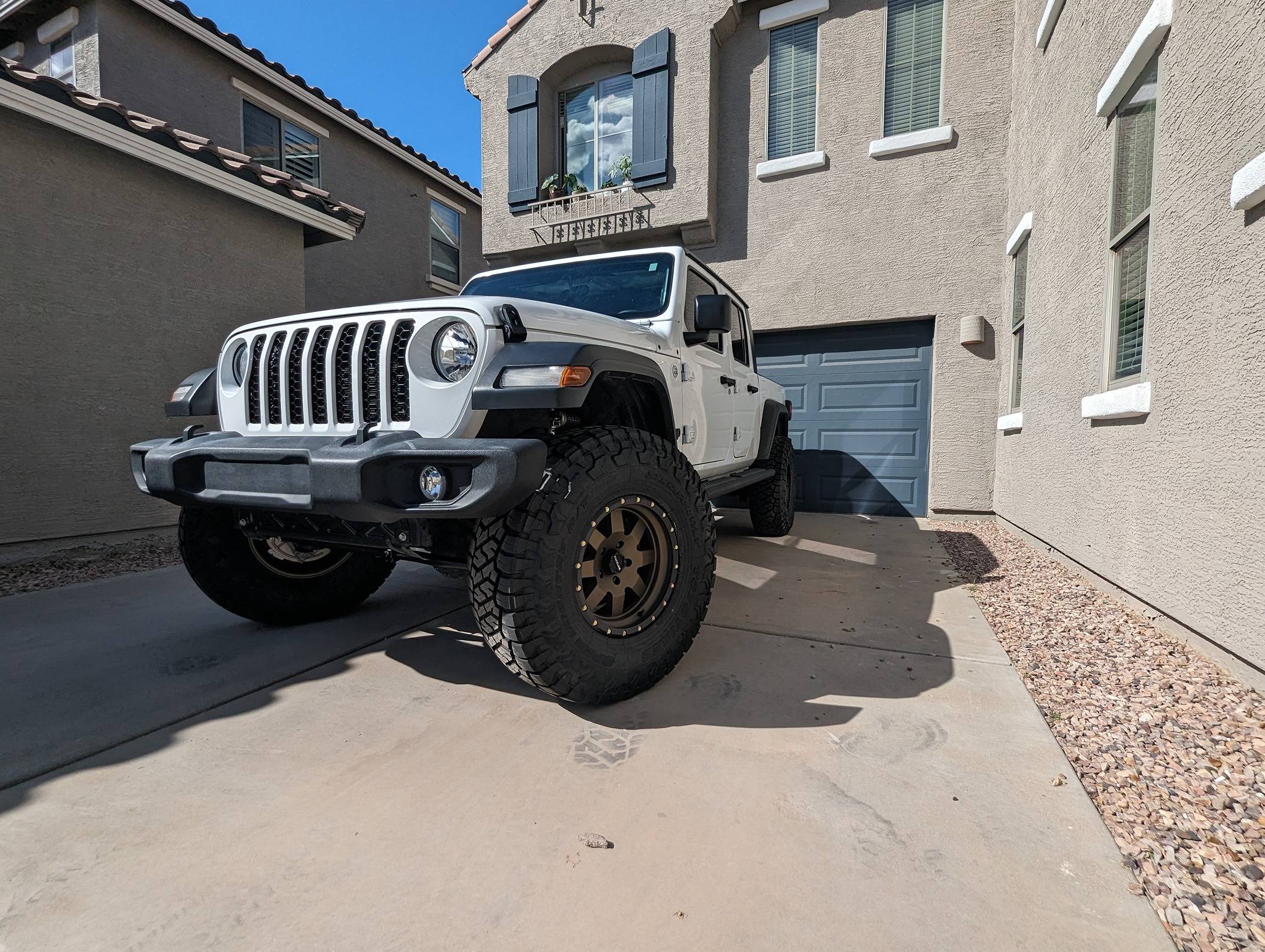

*J*
Jed
Mar 1, 2024
Gilbert, Arizona
2020 Sport S

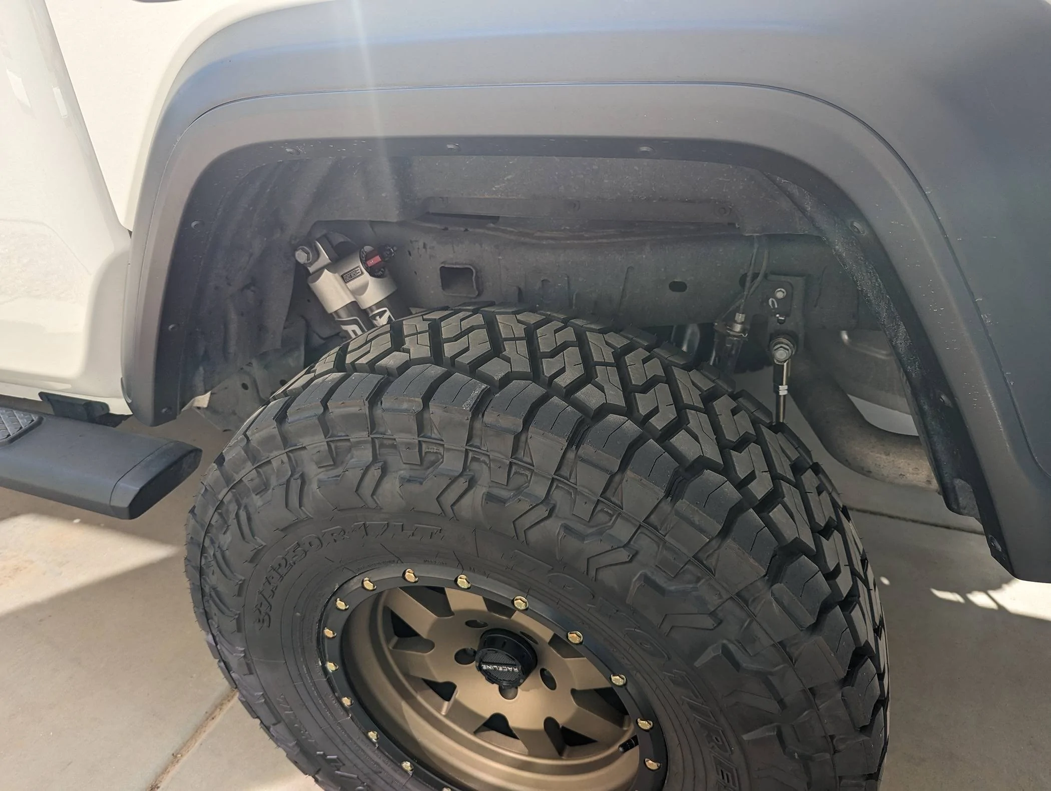

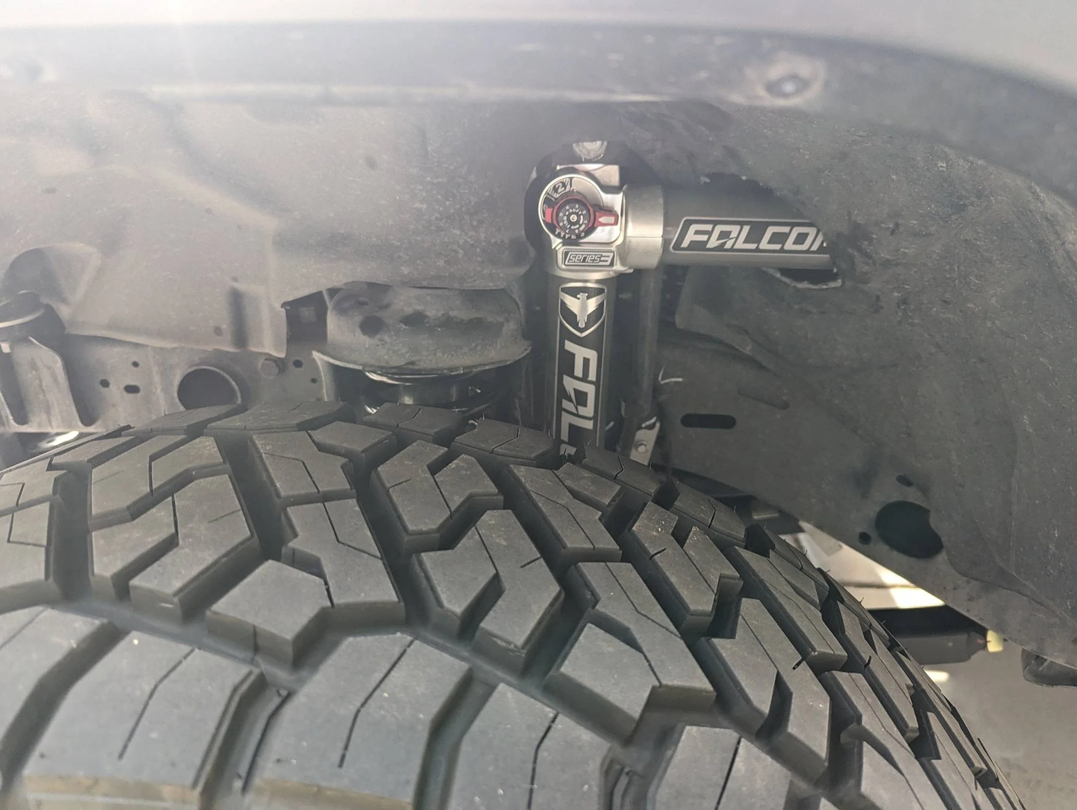

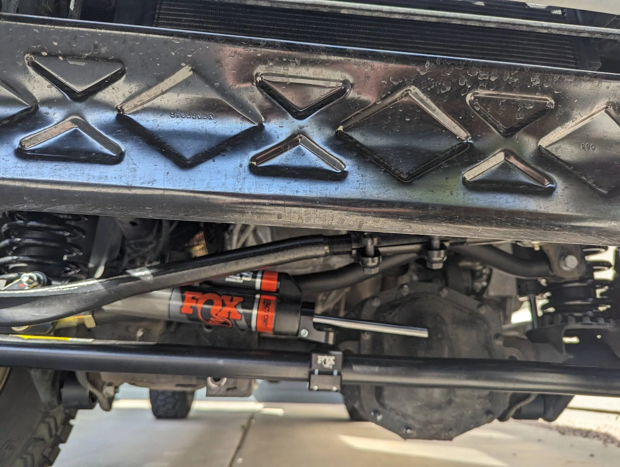

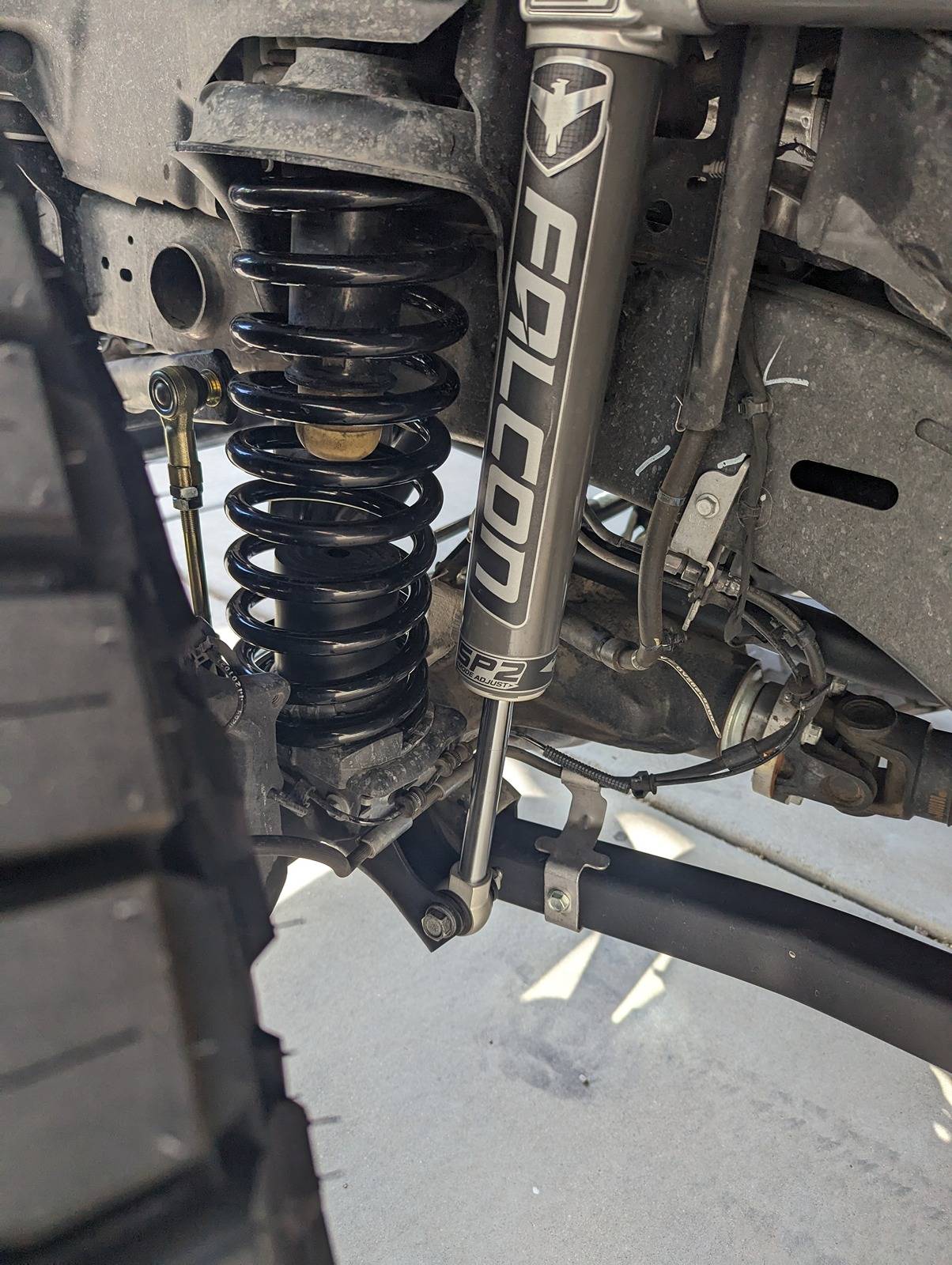

Finally got everything all installed. Funny enough I put the 37's on prior to the lift kit and other components being installed and it ran fine outside of some rubbing on the stupid piece that connected from under the turn single to the bumper so I just removed that and it no more rubbing except at full lock.
I'll take everyone's suggestions and get the lockers for sure and consider a regear after taking it out a couple times, but for now it seems to drive fine.
