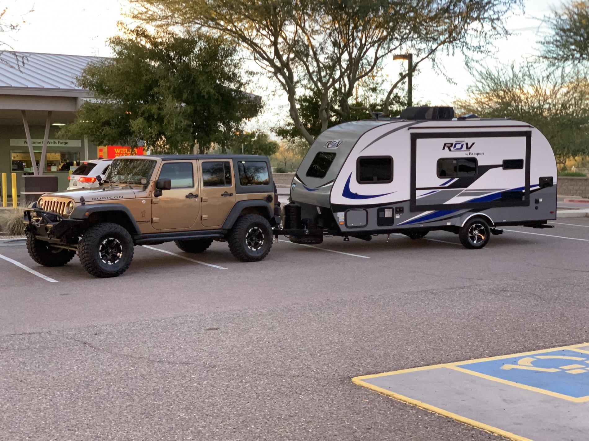

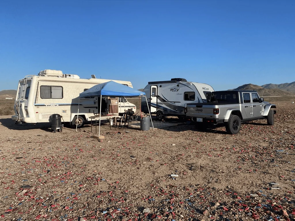

It's a 2018 Keystone Passport 170RK or 170RKRV (same thing). It's also sold under the R-Pod name, identical except for an upgraded fridge and stove, but much more expensive. It's 3k dry, around 3500 calculated full weight, possibly a little more with a heavy load. There's a queen bed up front and the dining converts to a smaller bed. Wet head and decent sized kitchen.
The weight distribution is absolutely necessary for a Wrangler, and really, on the JT you should have it too. The Gladiator pulls it SO SO well. Just awesome. My first trip with the JT and this trailer was from Phoenix to a shooting area North of Barstow CA. Lots of mountains, lots of road time. The pull was fantastic, and the adaptive cruise did such a perfect job it was so relaxing to drive for hours.
