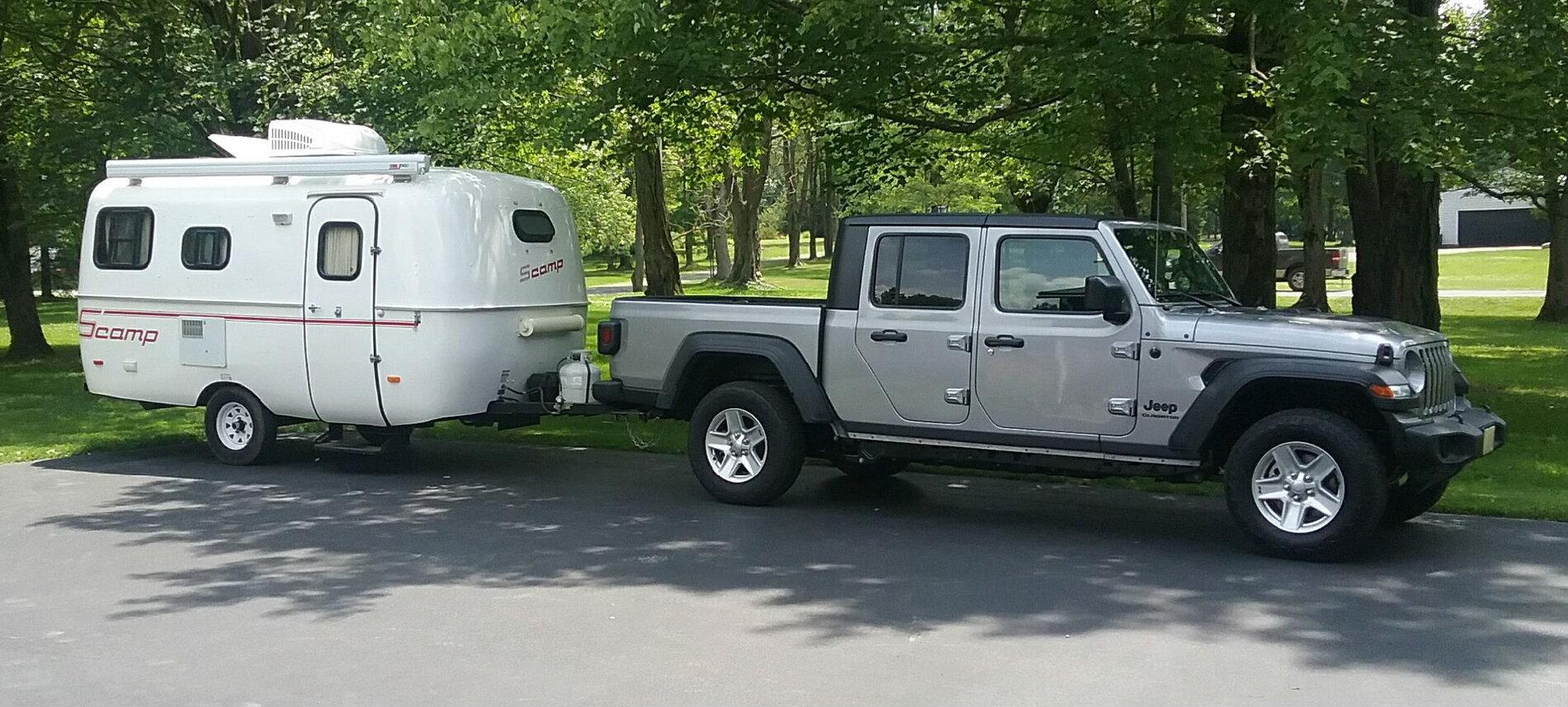

It looks good! You'll be fine. I doubt if you would need towing mirrors.
I couldn't find if electric brakes are offered but if it is an option get them. It's the perfect size trailer for easy traveling.
