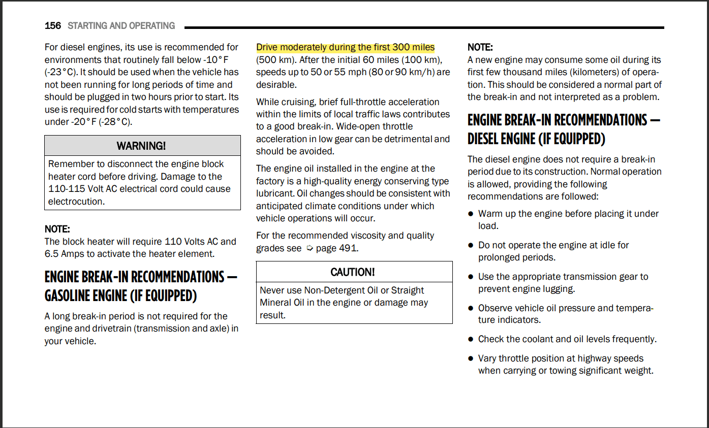

after 300 miles you should be fine

Yup - I'd go 300 or 400 VARYING the speed, a few high load accelerations up to about 55 and then high vacuum decelerations and use it like you plan to.
You want to vary speeds, no sustained high OR low speed driving, but don't ram-rod it for a couple hundred.
The idea is to let the rings flex against the cylinder walls to wear down the peaks and even things out.
But technically speaking, they are "broken-in" when you get them.
Besides, you are talking a light load as far as these things are concerned.
I wish I wouldn't have put my book away as I was going to scan and post a page from Dana/Perfect Circle on ring break-in from the 60s - you'd be amazed! Basically, after someone like me builds an engine and puts it in the car and does my test drive, and followed their procedure, it's broken in, give it to the customer, it's ready.
