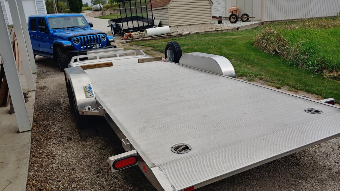

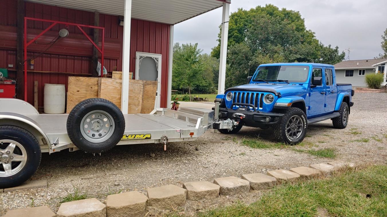

This is about my real-world experience finally towing a real load over a distance and some long hills (I80 between Des Moines and the Mississippi and back again.
Trailer -with spare tire, straps, tool box and some simple emergency supplies (for in case I lose a bearing, etc.) comes in at 1600.
My car - I thought it was 3200. I did more research and found that to be the base model 4 cyl car. Mine is a 6, loaded Sport, and comes in closer to 3276 with the I6 and T5, Sport spoiler, etc. I'll call it 3300 since I've learned what people report an SX4 as weighing is incorrectly based off the base model 4 cyl.
That means 1600 plus 3300 for a total of 4900 pounds tow load.

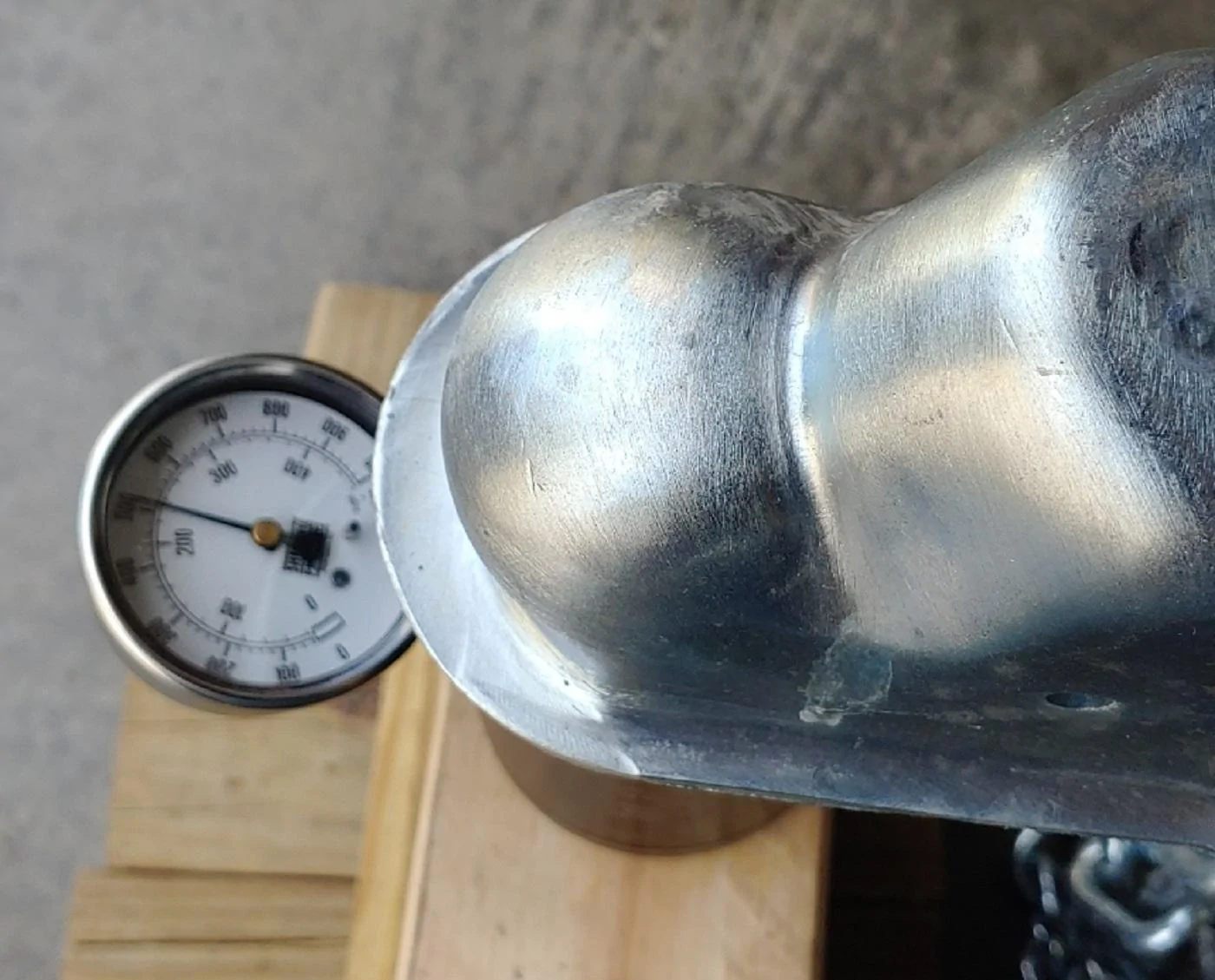

I weighed the tongue with the trailer setting level like it would when connected and got a tongue weight of 520 pounds.
Aluma says their ALL aluminum trailer should have a tongue weight of 10 to 12% That means mine should be running between 490 and 588. I'm running just shy of 11% tongue weight.
I have the Overland. Those are geared at 3.73:1 and it has the 8 speed automatic. They are rated to tow 6,000 pounds and the payload on mine is something around 1060 give or take.
So my tongue weight took about half of my payload. That means I'm down to about 540. Take away for the bumper and winch I put on - I'll call it 150 total to cover the added equipment on my truck. I still have roughly 400 left.
Not a biggy - I travel light - sleeping bag, tent, cooler, all of my gear isn't more than about 100 pounds.

I measured several times, it always settled to 520 pounds tongue weight.

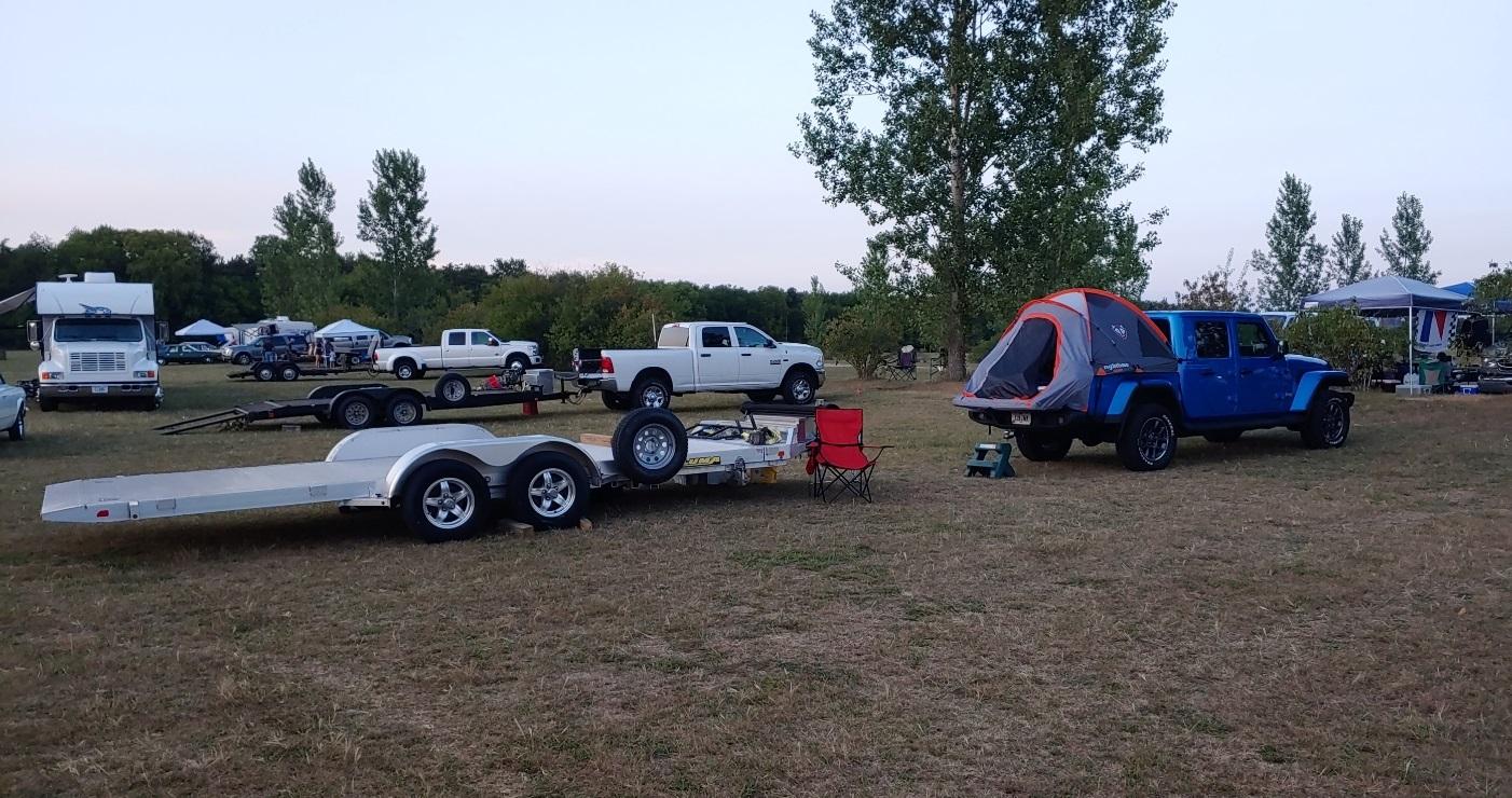

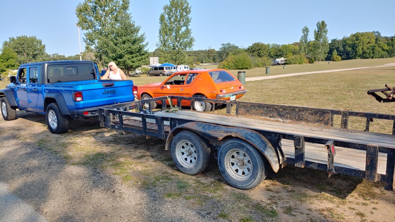

I stopped at a rest stop to stretch my legs (LOVE THE Hooke Road DEAD PEDAL!) and to check the looks of the tires, feel the sidewalls, trailer bearing area, car straps, etc. - all was fine.
Oh, mine wasn't the only Gladiator there! They hauled that Gremlin over from a town only 30 minutes south of us.
I'm glad I'm only 5'8" A taller person would have had their feet sticking out over the tail gate but it worked out ok for me. I took a ratchet and TORX bit to remove the tonneau cover before putting the tent up. Made a huge difference and those covers come off in under 5 minutes - less if you hurry.
And back home again, ready to unload -

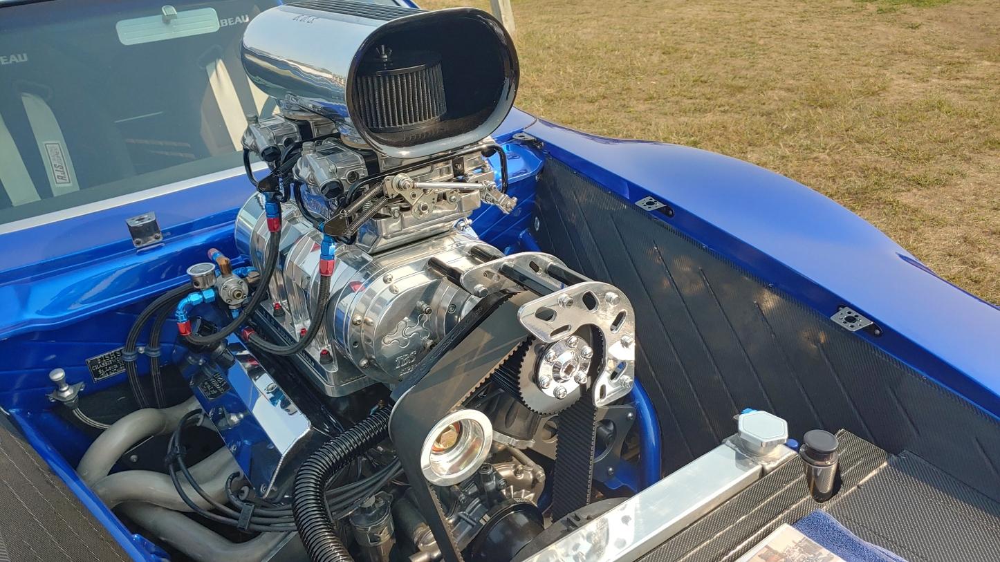

Any Jeep owners with power needs can always consider something like this, I guess........... you may end up having to cut the hood, though. There's a clearance issue.

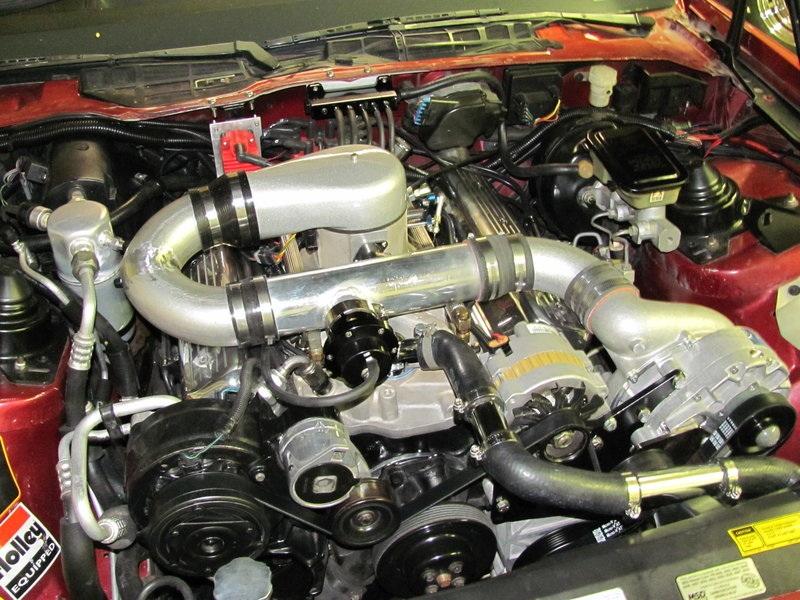

Oh I love me some huffers

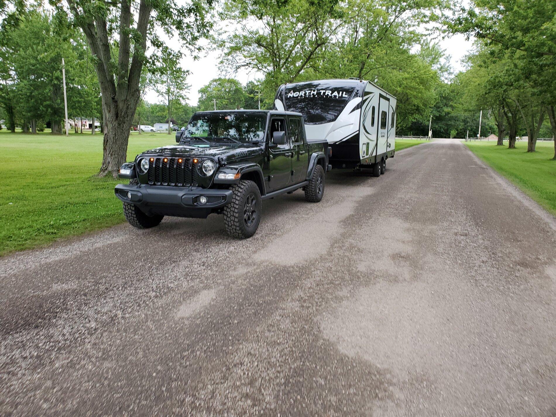

I tow damn near 6500 lbs once a month with my sport willys. 5400 trailer, 2 kids wife dog camping equipment. Only time I couldn't hit 70 mph with ease was in Pennsylvania on a 25 mph backroad. Had to take it at about 10 mph in second. Other then that I set it cruise to 70 mph amd get around 11 mpg.

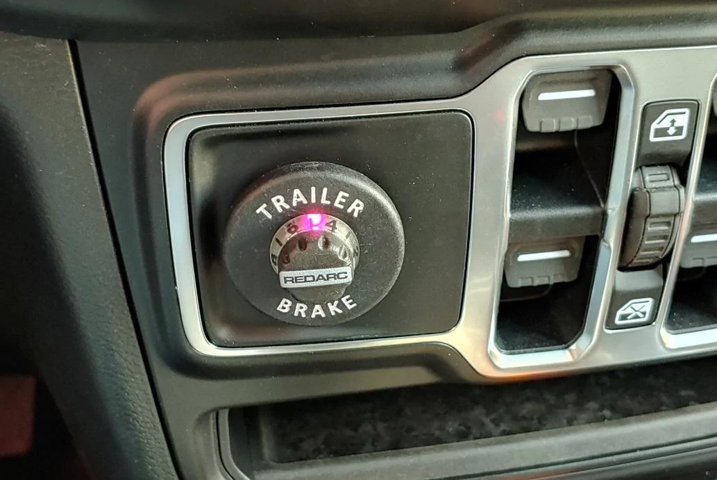

As far as brake controller - your options are wide open - Redarc, Curt, MOPAR, they'll all fit sand wire in fine because ALL Gladiators have the wiring harness for towing taped to a harness next to the left kick panel.
The only advantage the MOPAR controller has over any other is that it looks like it was put there from the factory - the design matches other center dash items. Otherwise, some of the others could be a bit easier to install in the end. I've installed both the Redarc and MOPAR. The Redarc was actually slightly easier to install and won't interfere with any dead pedal installation later. Some dead pedals mount in the same area as the MOPAR controller.

I have the 240 amp alternator - the purpose for that was to handle the huge fan draw on these.
I had the tool. I had the Redarc in the exact same place the MOPAR dial installs.
But the rest was easier. The box was a piece of cake - didn't have to reach clear up under the dash and crawl on the floor and undo harness ties and get to a corner.
As I found out, not all trucks have exactly the same parts in the same places and mine was extremely tight in the area where the MOPAR controller "box" installs, and I had to tweak my truck's wiring harness for clearance.
The Redarc was simply a lot easier to install - and in some ways I like it better (It's dual function and a lot easier to access where I installed it)

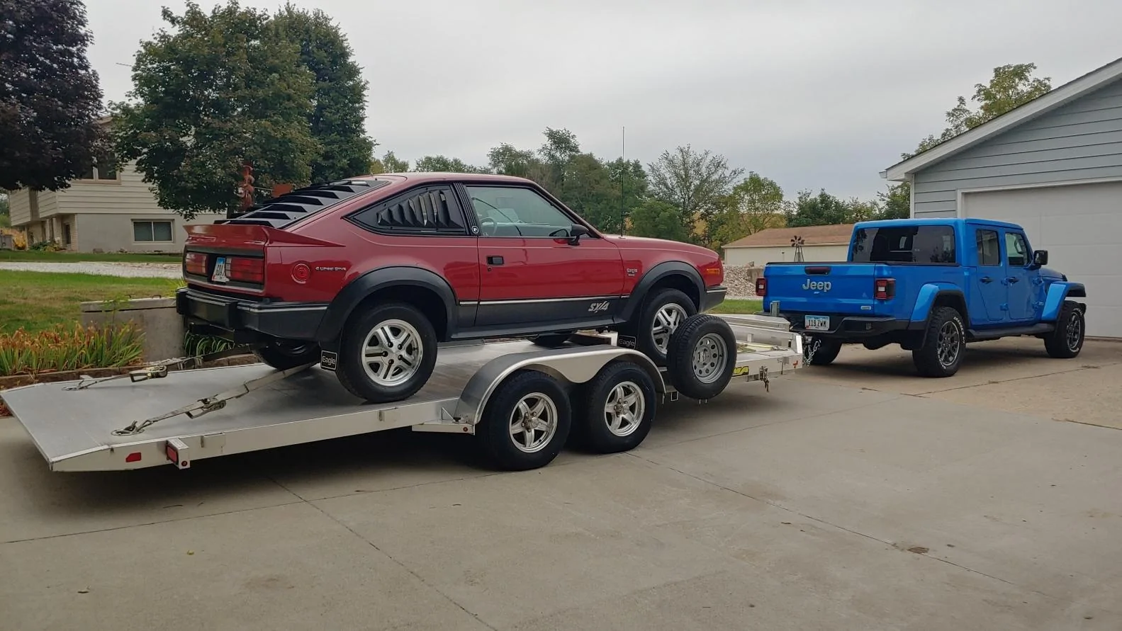

82
The SX4 was only made 3 years - 81-83
I have an 83 in my shop I've been working on off and on for a while for someone else.
My first was an 84 wagon my first wife and I ordered,
She got that in the divorce (it would handle car seats, etc.)
I bought a used 81 SX4 as a daily driver after that.
(can't remember what I did with that car - I must have sold it when I bought my Comanche)

Also had a slightly scary glitch where the brake controller would conk out every time the lights went on (like auto headlights on through a tunnel). Cleaned the contacts and cycled everything a few times and seemed to go back to normal.
Probably brought back 50 lbs of mud!
