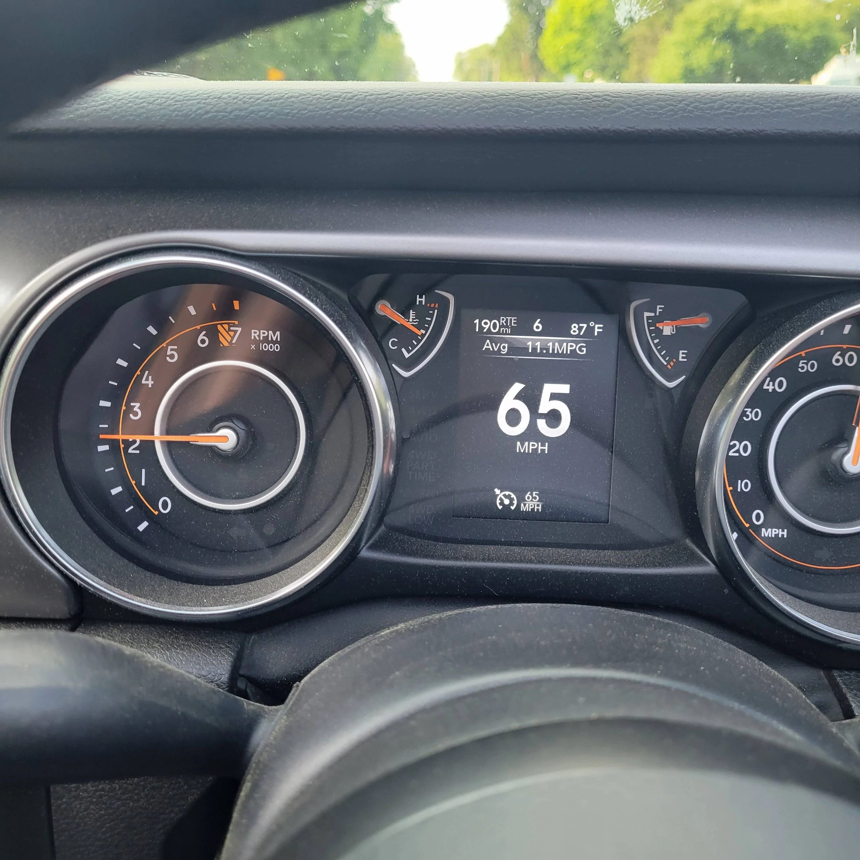

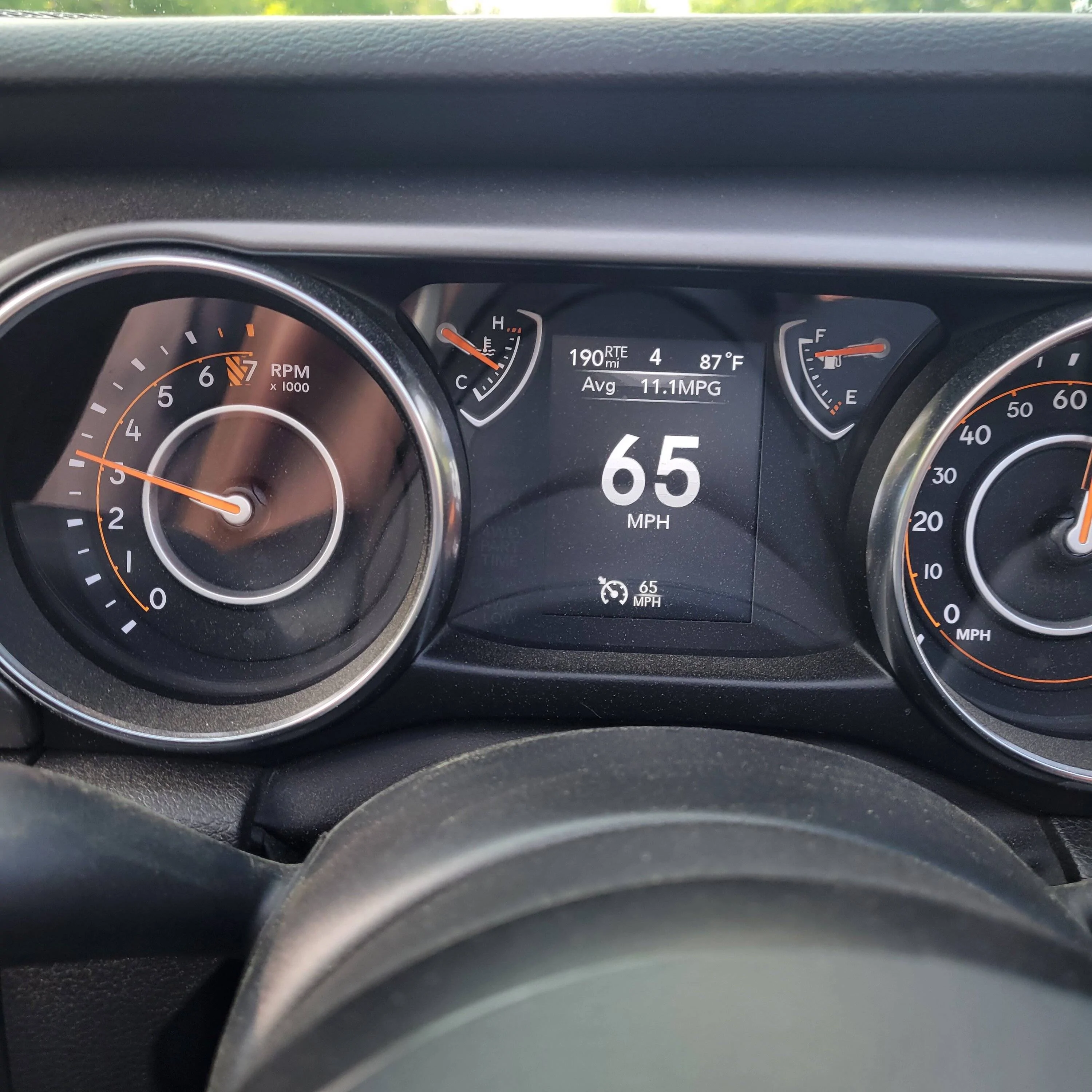

Here is the real world 6th vs 4th on flat ground cruise was set for each. So the majority of my trailor pulling was in 4th at 3100-3200 rpm.
I agree that is to the low side of optimum for power band, but it didn't make any notable difference if I ran it in 3rd at 65mph. I'm just summarizing she just don't got it. I am going to have my friend with a stock max tow hook onto it, because I'm not buying that will hold 65mph on a grade, and, if it does by some miracle, I bet it's at 5k rpm or better. That's just my theory, yet to be proven.
If it's really no better in 3rd, something has to be wrong to be pulling that much power.
