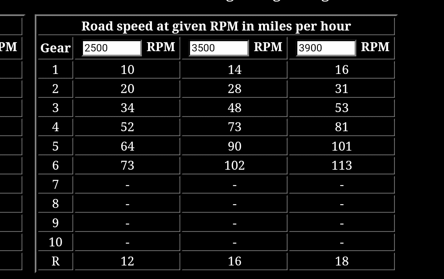

Clutch slipping? Using a true 36" diameter tire as a safe calculation, these are the speeds you should be running with the D478 tranny, 1:1 transfer case ratio, and 2500rpms. Pending this calculator is correct (which I assume it is since its what everyone uses), your speed vs rpm seems off. 37s and 5.13s, right?
I will verify tonight with pictures and post them tomorrow. The actual height of the "37's" if I remeber correctly is 36.2' when I measured. yes 5.13's If the clutch were slipping, it would have gave up the ghost on a 8hr trip. I never once smelled anything. I assume the calculator your posting is 1.1 in 4th, right ?

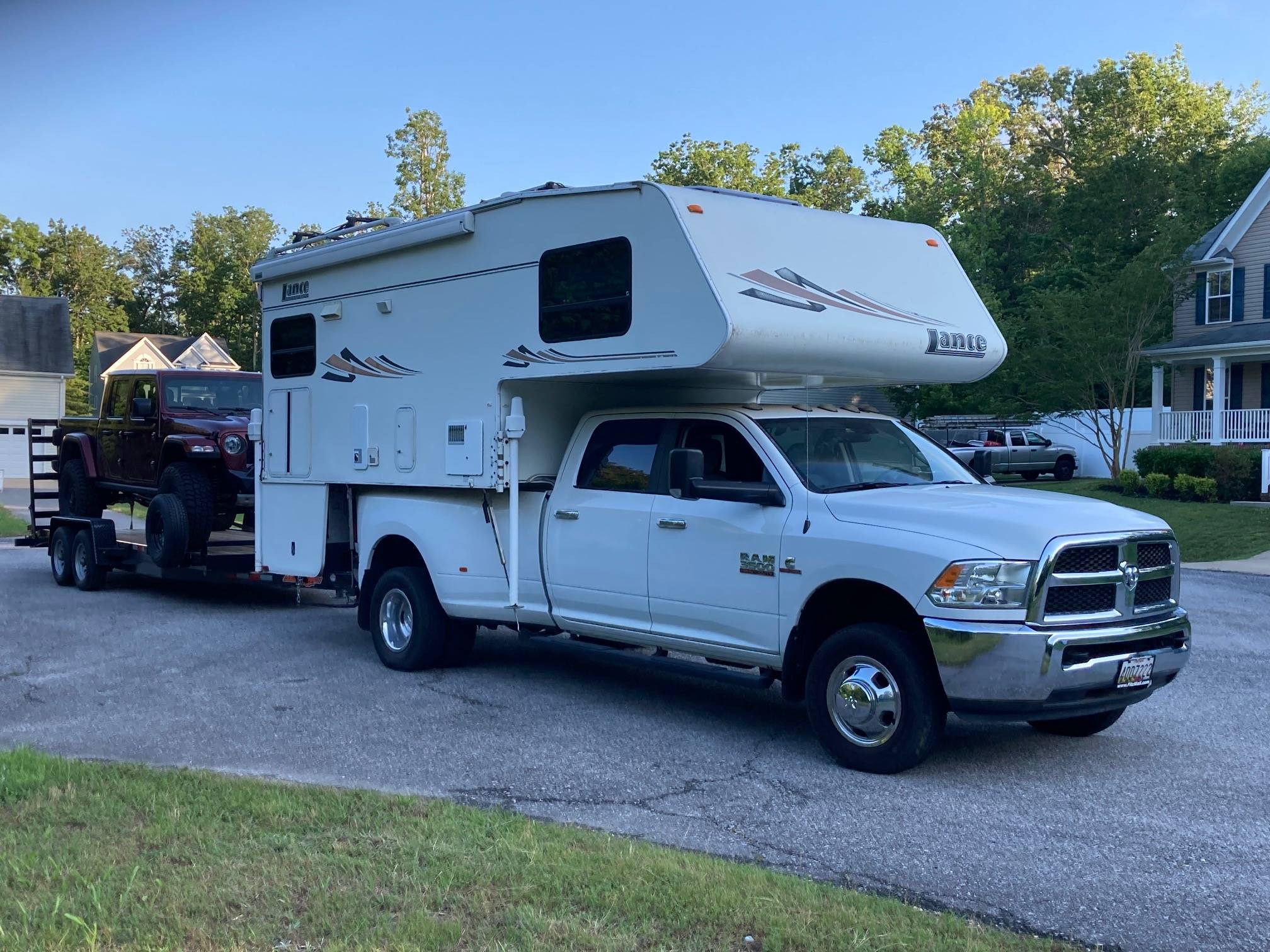

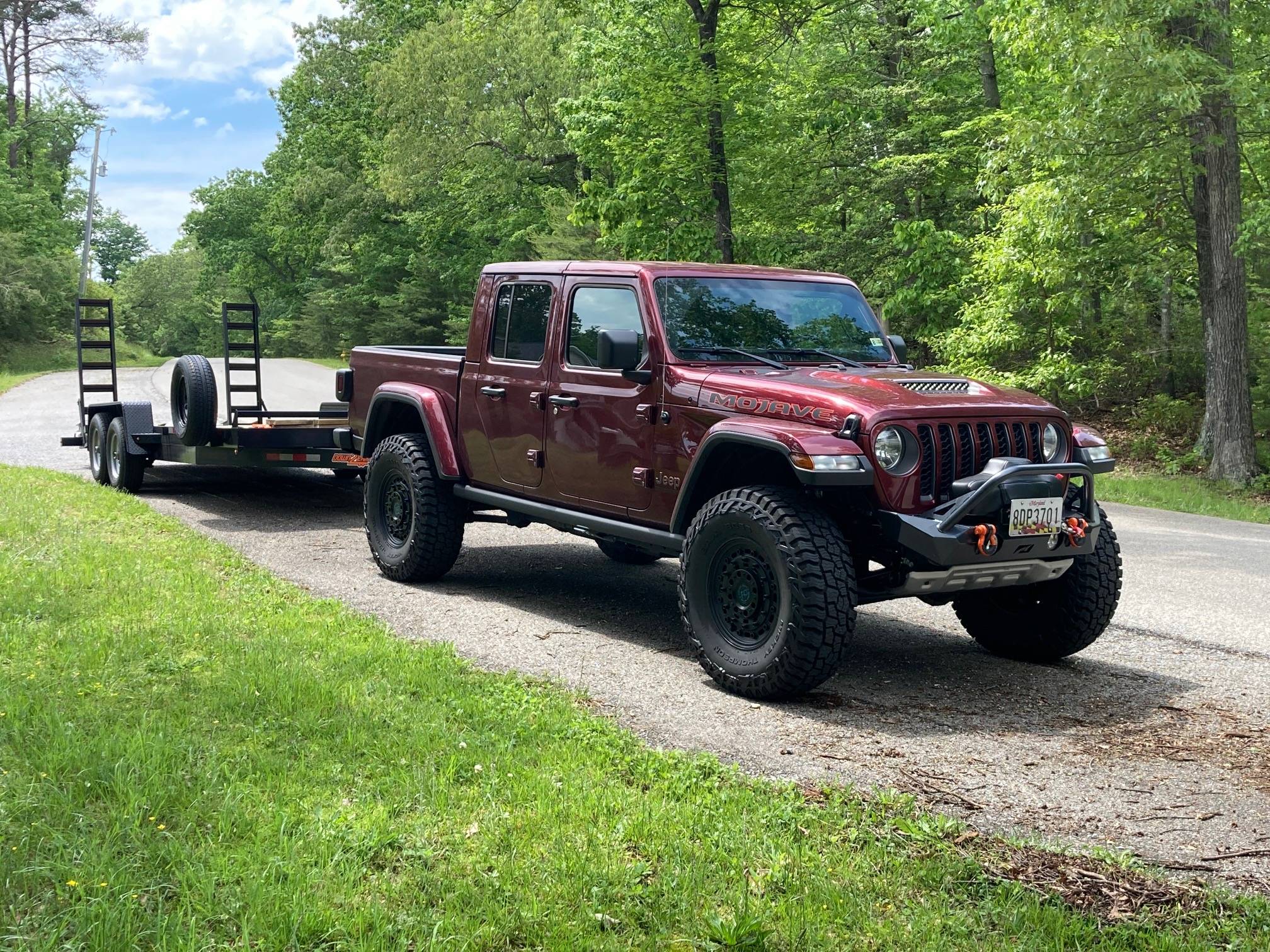

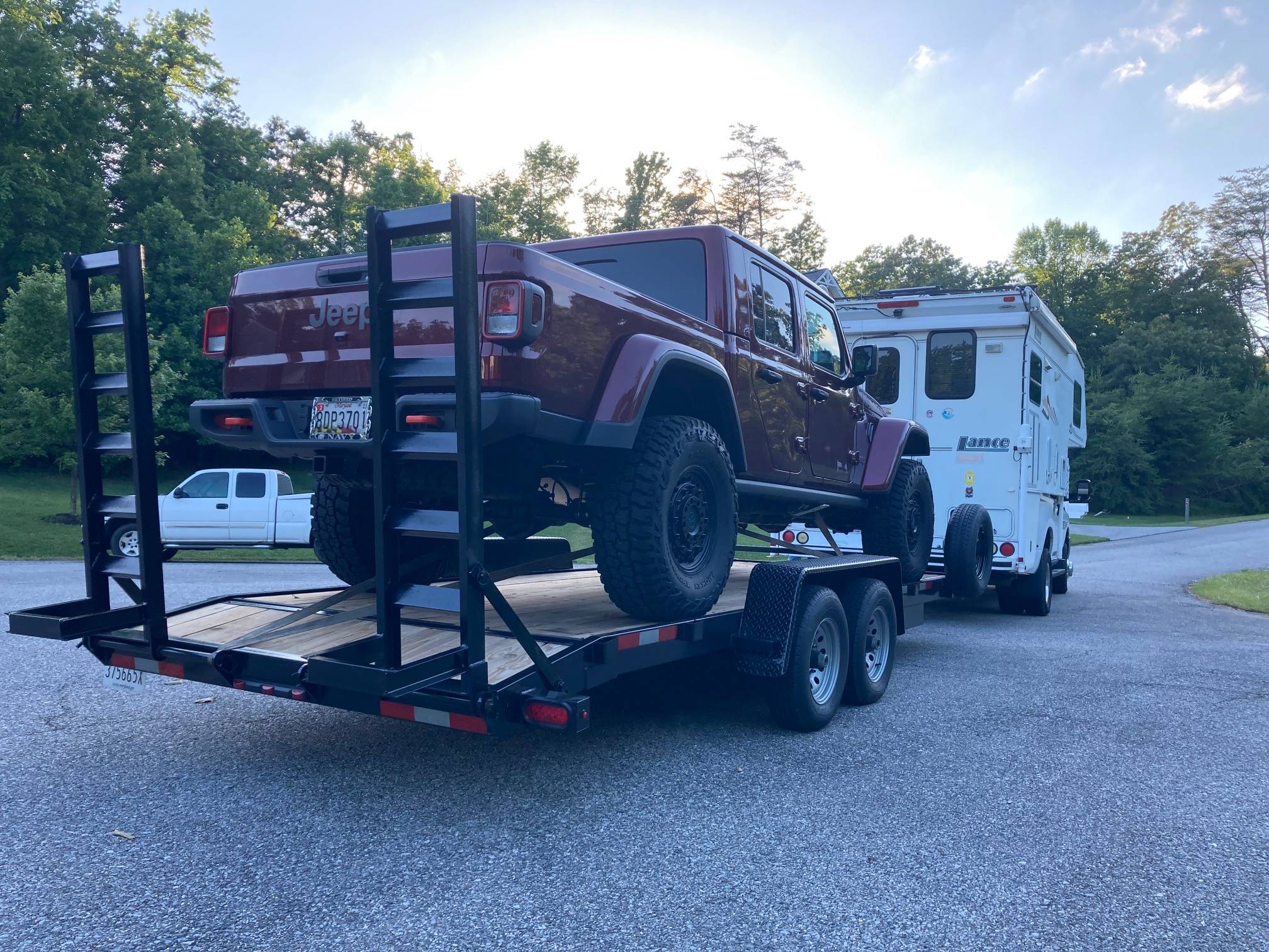

I picked up a 20' 6 lug 10K# GVWR tandem axle dovetail equipment trailer not long ago. I drove a couple hours in my low milage '21 JT Mojave on 37's & MT to pick it up. Regretfully, I still have stock 4.10 gearing.
The MT JT did NOT like towing this empty 2800# beast.
On the other hand - my 3500 4x4 6.7L CTD Ram with a 4K# camper tows the same trailer & JT with no sweat. :)

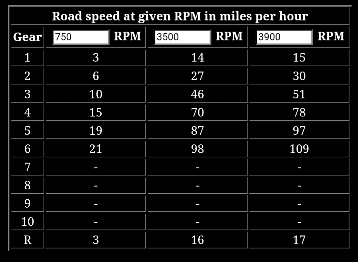

Oh, I believe you. I'm just genuinely curious why.
Stock on the left, your setup (theoretically) on the right:

Hopefully you can read the small print from my phone's screenshots.
