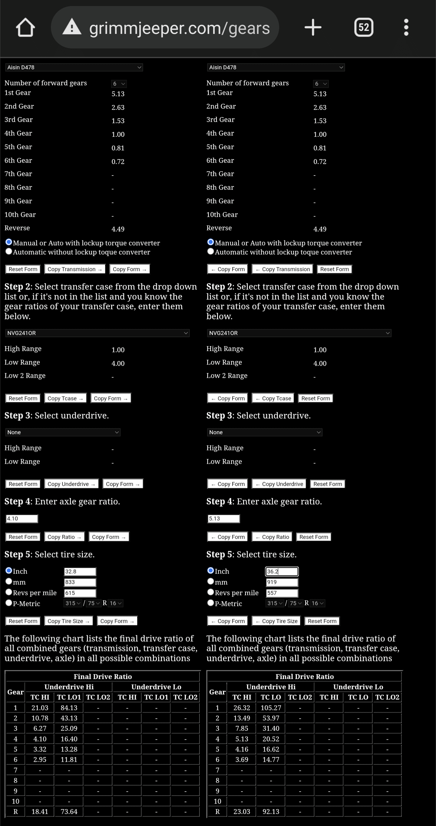

Stock on the left, your setup (theoretically) on the right:
Hopefully you can read the small print from my phone's screenshots.
You got me questioning myself now :). It was a long 8hrs haha. I dont think its that low at 70mph, but now I'm going to look lol. That looks like a solid calculator too.

Rolling resistance, ehh, I usually run 28psi to get a good contact patch, for pulling I aired up to the tires rated 50psi, again negligible. Gearing only moves your power band, it does not add HP, hence why I pulled mainly in 4th gear to hold 3500rpm, 67 was 3900. I saw zero benefit if I ran 3rd at 65mph to get the r's to 4500. Thats whats leading me to believe she is just plain tapped out. Again, not impressed, and I wouldn't bet 5$ that a max tow would do any better. But it is a mini truck after all.
37s add a significant amount of rotating unsprung mass.
Regardless of gear ratio and rolling resistance (that probably increased also).

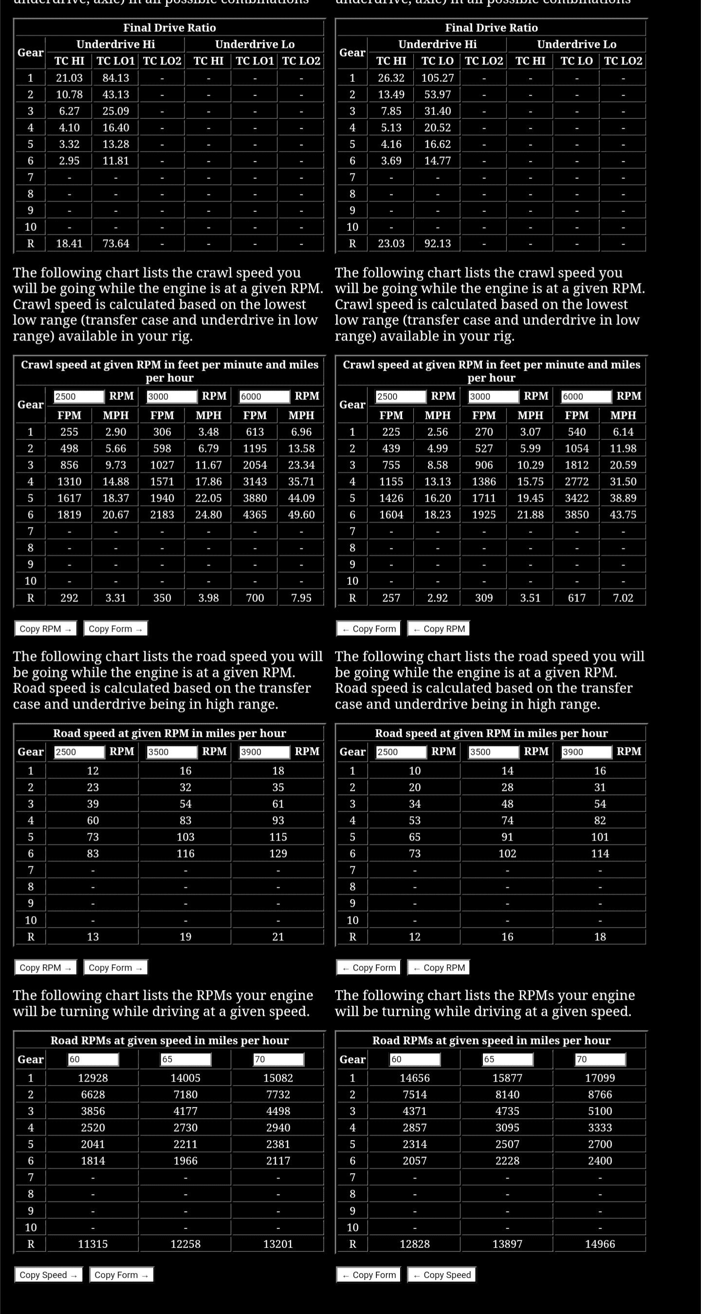

Here is the real world 6th vs 4th on flat ground cruise was set for each. So the majority of my trailor pulling was in 4th at 3100-3200 rpm.
I agree that is to the low side of optimum for power band, but it didn't make any notable difference if I ran it in 3rd at 65mph. I'm just summarizing she just don't got it. I am going to have my friend with a stock max tow hook onto it, because I'm not buying that will hold 65mph on a grade, and, if it does by some miracle, I bet it's at 5k rpm or better. That's just my theory, yet to be proven.

Wow, with my stock Overland automatic, I could take the 2% grades at 65 and 3300 rpm fine, and the other grades it dropped down and hit 4300 rpm or so to make the hills, but settled back down, and on the level it was in the mid-2,000s.
Something is really pulling the power back on that.

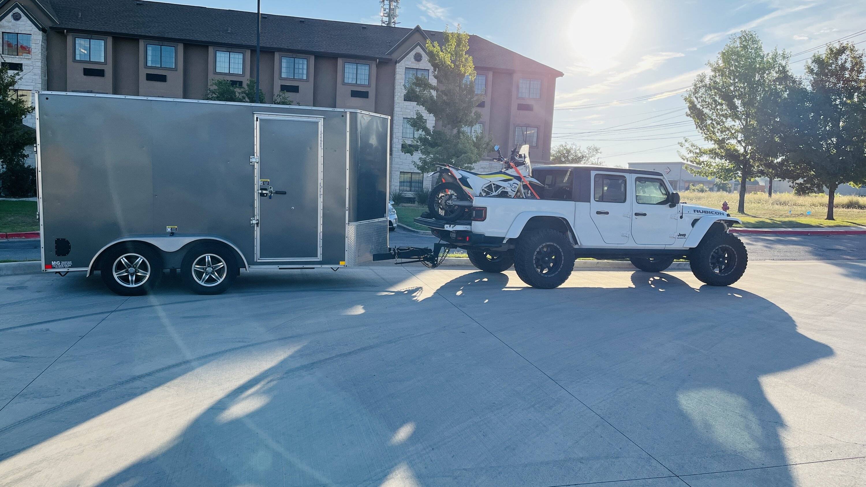

Northern MN to the very southern tip of Texas in South Padre Island averaging 75mph. Never had an issue, averaged 14mpg with the VERY heavy 38x13.5s on stock 3.73 gearing. Go Ecodiesel!!
