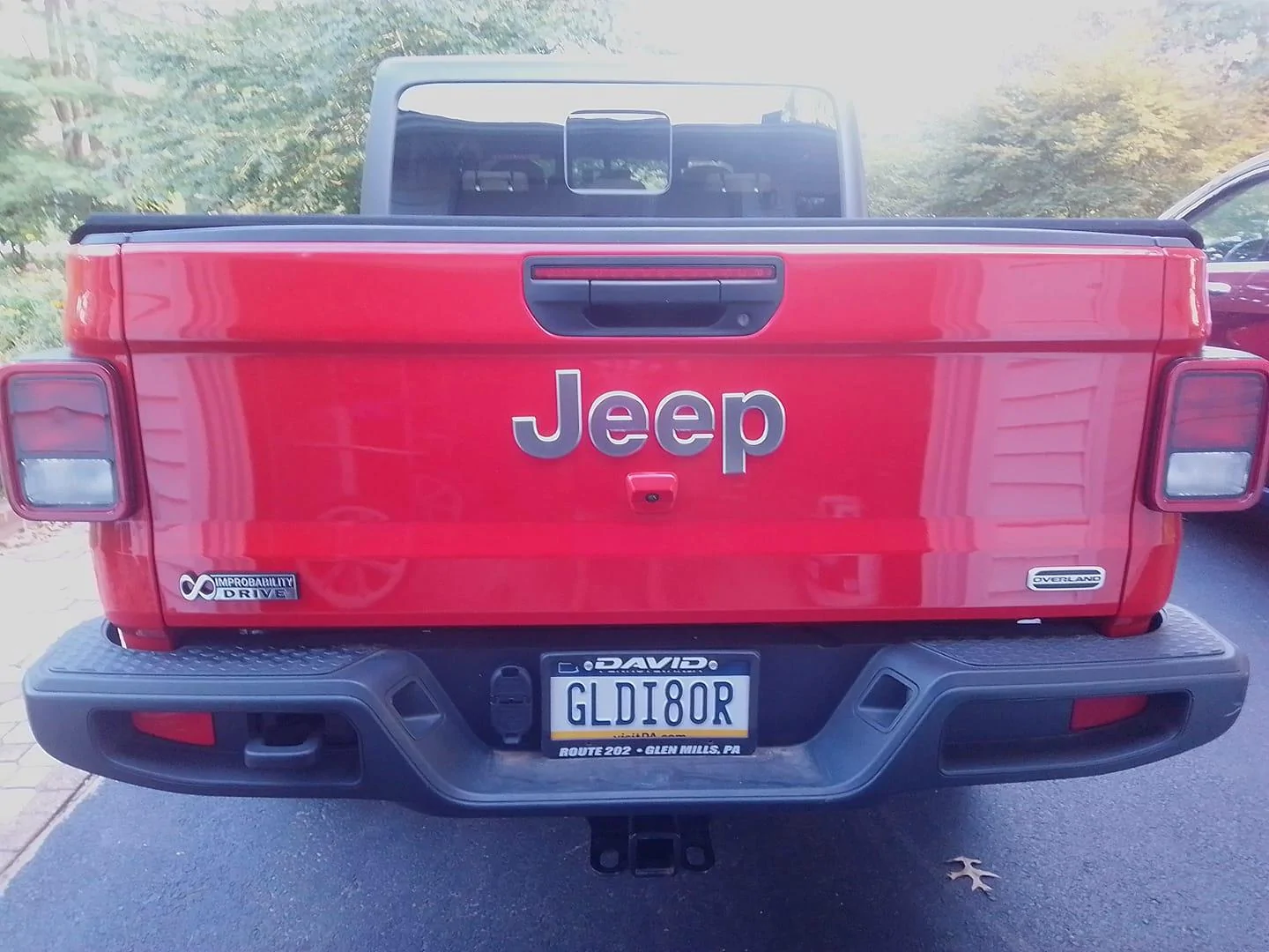

Well, I just totally increased the towing power on my Gladiator Overland by re-powering (some may get it, other's may not...) :CWL: :CWL: :CWL: :CWL: :CWL:
Jeep Gladiator First REAL towing with the Gladiator Overland --  4900 pounds tow load Repower
Where did you get the Improbability Drive badge?
