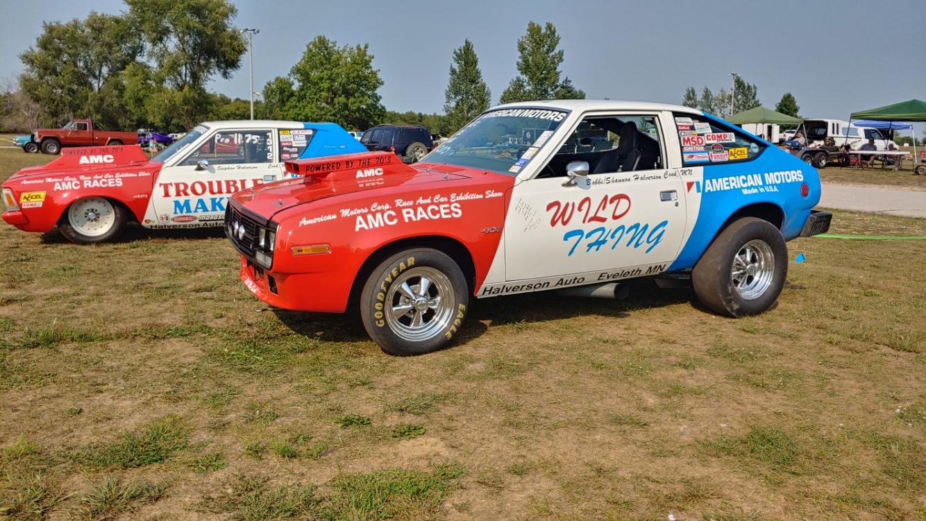

Too funny. I used to drive an AMC Spirit in highschool. Jacked it up with rear shackles. Traction bars. Wide rear tires. Skinny fronts. 258ci 6 cylinder was strong. What memories.
40,514
54,044
The SX4 is mostly based off the Spirit platform. The fenders are different (wider openings because of the steering knuckles and CV joints up front) and the floor pan is different for the transfer case clearance. Otherwise a lot of parts interchange. Rear differential on the SX4 is mounted under the leaf springs where on the Spirit it sits on the leaf springs.
Since my SX4 sits so high (because it's 4 wheel drive) it sits high on the trailer, and stands up higher than the roof of the Gladiator.
Here's a fast Spirit -

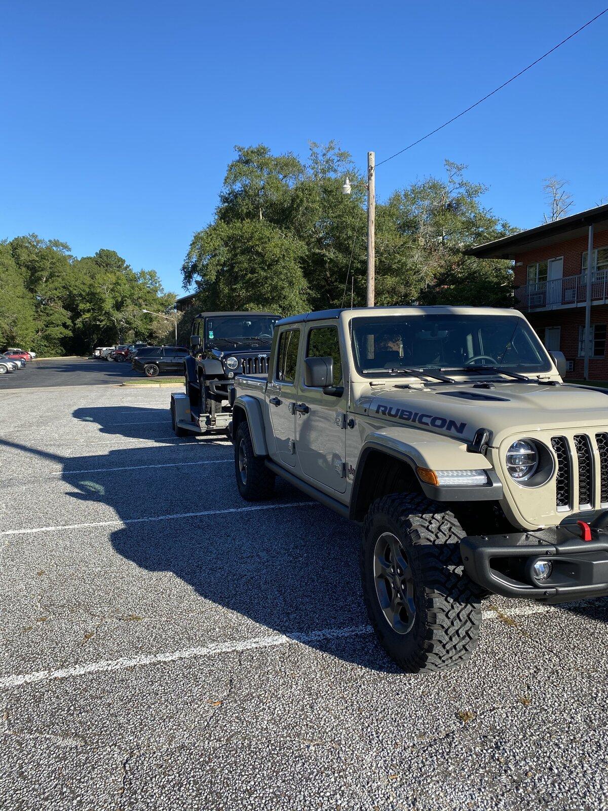

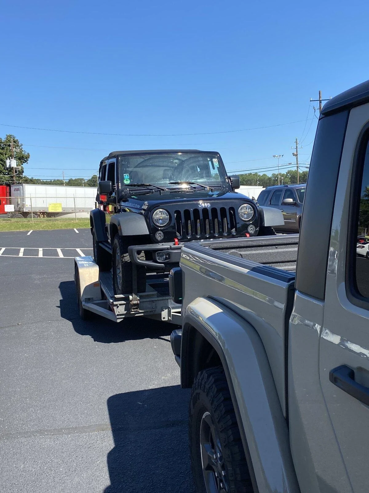

First time towing with the JT and it was hauling my 2015 Rubicon JK straight off the boat from Europe. I will say the 9mpg average wasn't great, but the JT did its job well. Smooth, good braking and plenty of highway power. I am more impressed with this Jeep every time I drive it. Bittersweet ending to the JK at the end of the day delivering the trade in, but I'm sure it turned some heads having a Rubi tow a Rubi :)

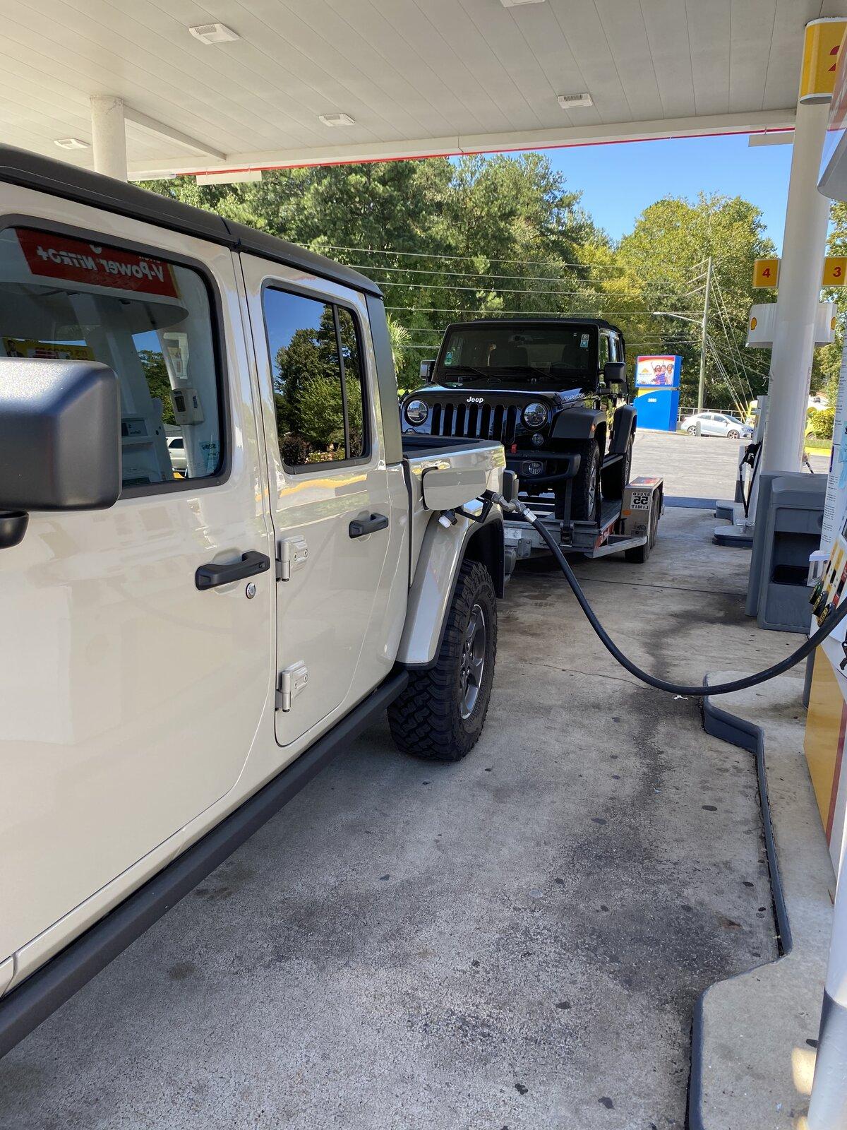

There was a shell station not far from the events, so on the way back I stopped there and filled up with their 91.
The FilIUp app on my phone said I did 13.94 mpg average but I may not have pulled the trigger the same so perhaps I could have gotten a couple of tenths more in it (gas was expensive in IL)
