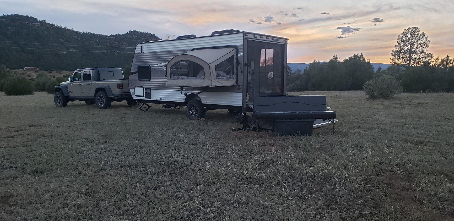

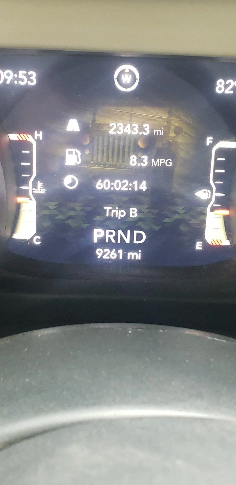

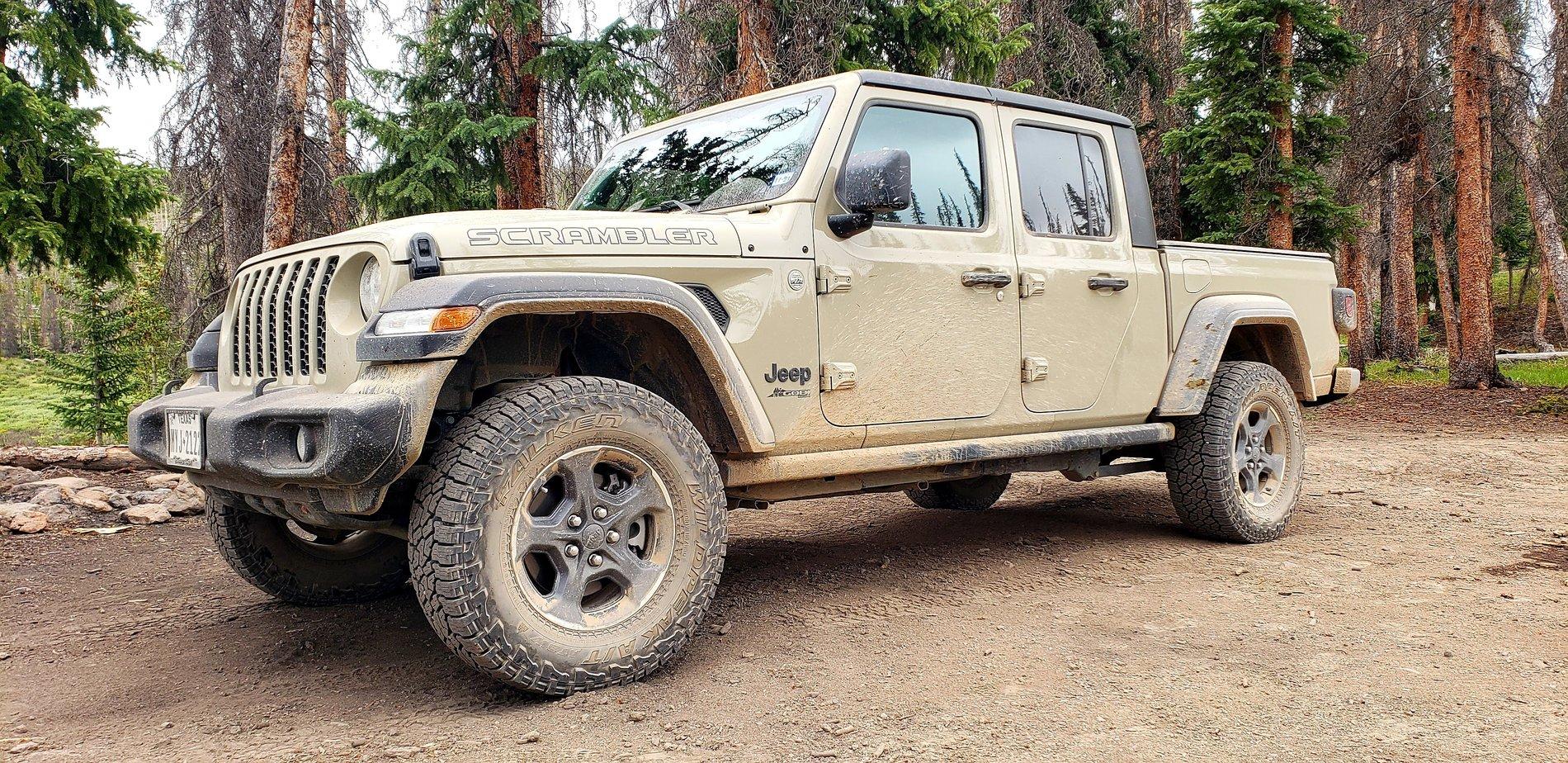

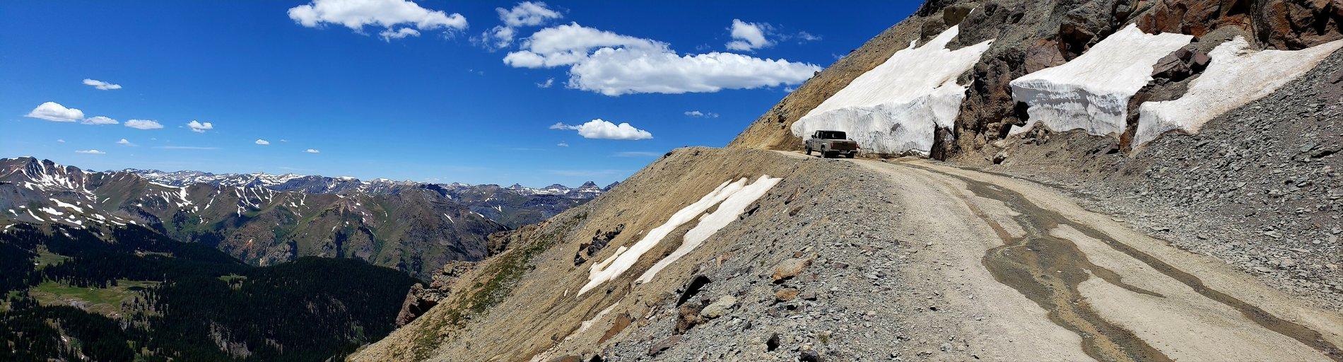

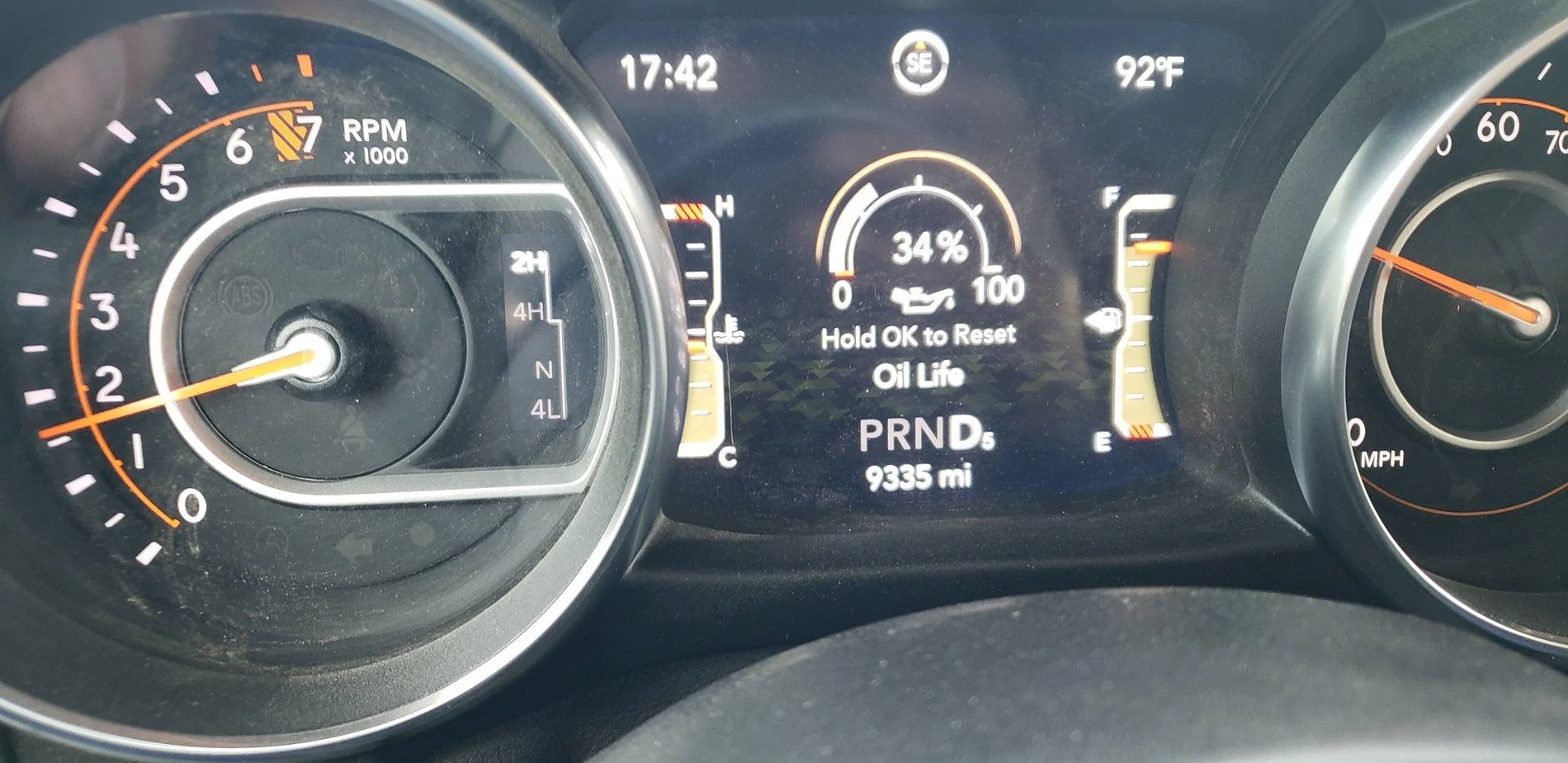

Just did a trip from Austin to multiple places in NM and CO. Went over so many over 10K passes that I lost count. Did Eisenhower, Leadville and Cottonwood passes in just 2 hours.
Head wind both ways . Over 2K miles. Took it off road on Alpine loop and Carson city (did excellent, Tacoma tore off their footsteps on both sides). Towed around 5K pound toy hauler the whole 12 day trip.
Did burn up alot of my oil life meter. Changed the oil right before the trip.
Max tow with Rubicon lift, wheels, tires.
