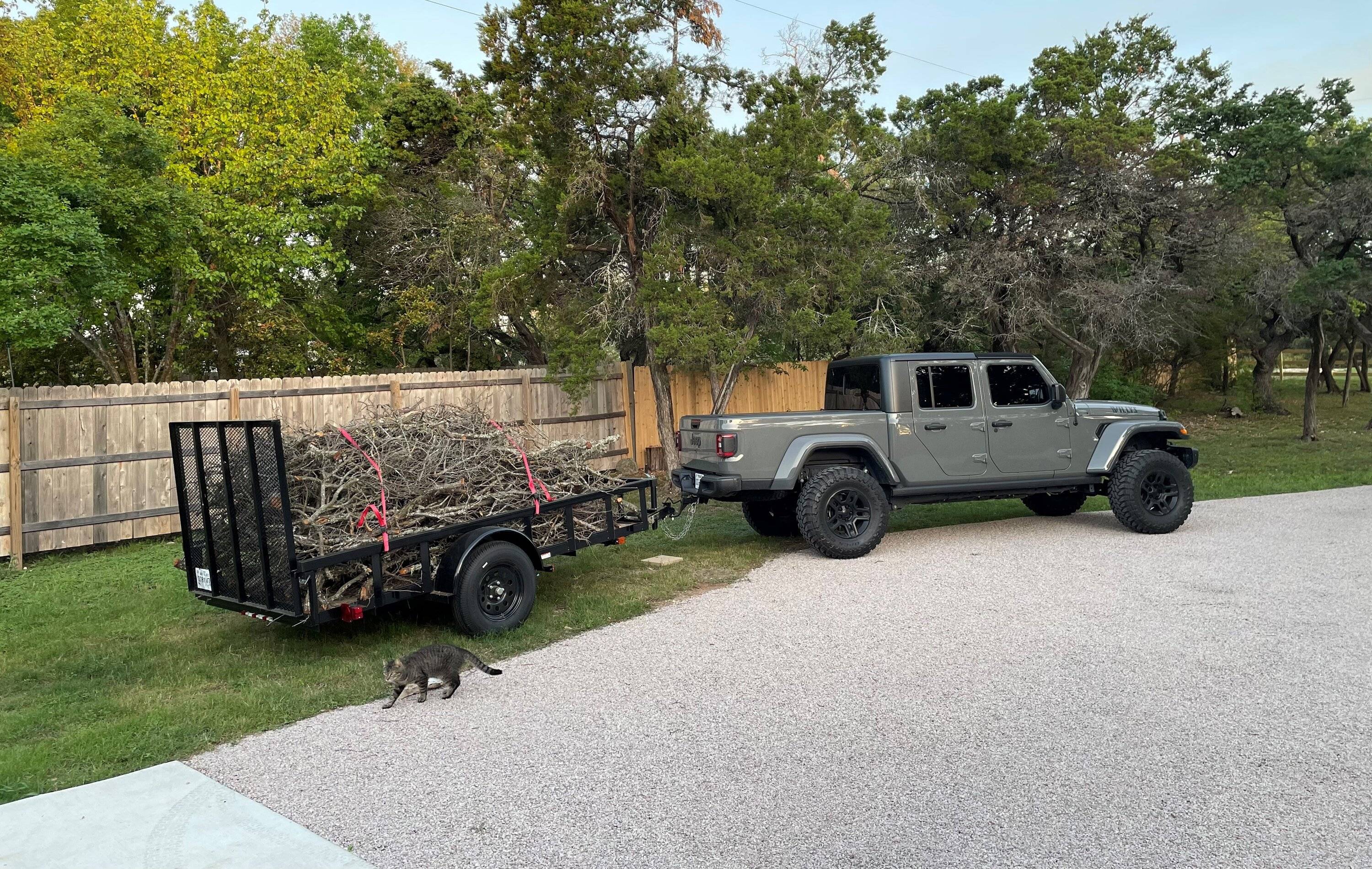

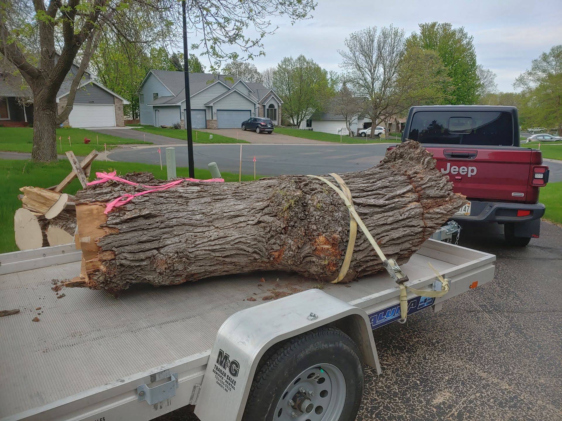

I feel like the weight is less of an issue than frontal area of the trailer though it doesn't help. I was able to tow this setup which i estimate was about 3,500 lbs (log and trailer) no issues. It clipped on the freeway at 70 just fine. Mostly flat land but i went over a few overpasses which are kinda like hills for MN at least. JT is almost completely stock, or completely stock depending on your stance about mud flaps being a mod :)
