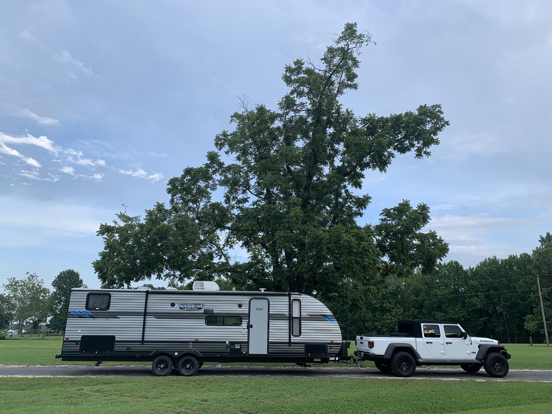

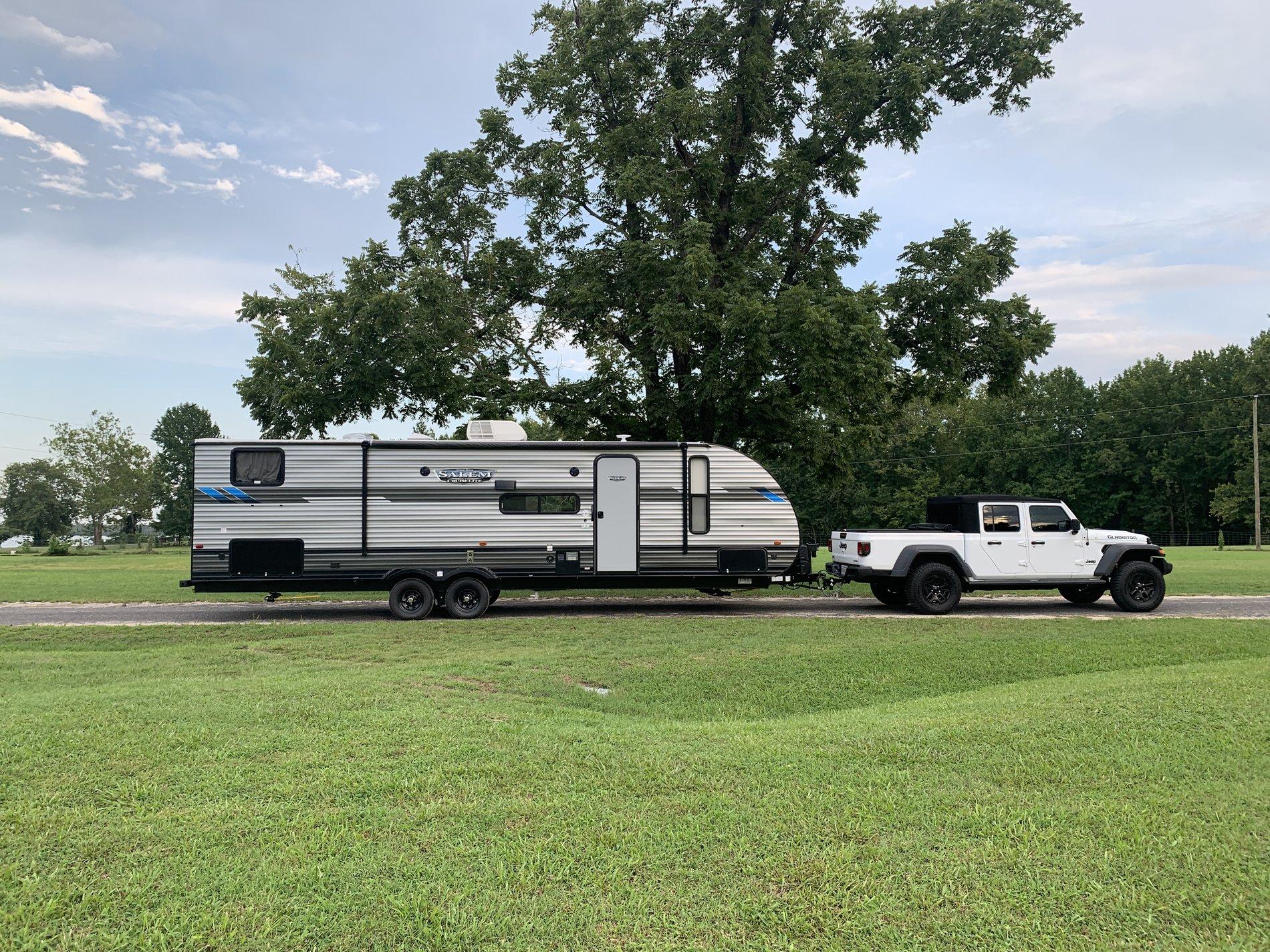

I have a forest river travel trailer... is around 6000 dry, 6600 loaded. About 725 tongue weight, REDARC brake controller and weight distribution hitch w sway control. This week did a trip 100 miles round trip, did great! Got 11 mpg. Wouldn’t do it without the wdh or brake controller, but compared to my tundra was slightly shocked how well it did, especially the mpg. I did keep it between 55-60.

danielspivey
Daniel
Sep 7, 2019
52
1,074
1,162
Central Virginia
2020 MAX TOW MAX TOW MAX TOW, 4.10s w 1583 payload
Damn that is scary.
what is that an expedition? Isn’t their towing capacity like 5500-6000?
That is a dual axel trailer, 25-28 foot long.... a weight of probably close to 5kish, no WDH much less sway control, guarantee no brake controller, probably running down the interstate at 75-80... add that with unknown weight in the tt and inside tow vehicle... I guess that’s what happens.
there’s a reason they put tires w a max of 65 mph on these trailers. I don’t think I’d ever go faster that 60, try to stay in the 50-55 range.
eaglerugby04
Oct 14, 2019
1,789
1,271
Northern South Carolina
Network Security
Thats about identical to my setup from two weeks ago. 6200 trailer with maybe a hundred or two or so lbs of items in there. Redarc and WDH. Even got 11.6mpg. I was all on state routes the way. There were times I didn't even notice it back there. There was just one very steep hill where the kids could hear the engine and were like "why did you slow down if your going fast"
All that said I am going to enjoy the carolinas with this, but I do not see myself venturing cross country with this thing, but it may be an adjustment. I was crapping my pants the first time I had a 16ft landscape trailer on my van, now 5 years later I can roll with that thing like it is nothing.
Your right. Probably put all the cargo at the back to "help" with the squatting issues. I am sure that it has a slew of issues in there. Done a ton of research on these things since before I got mine. Lots of things you need to know that I am sure half of all owners don't even research.
