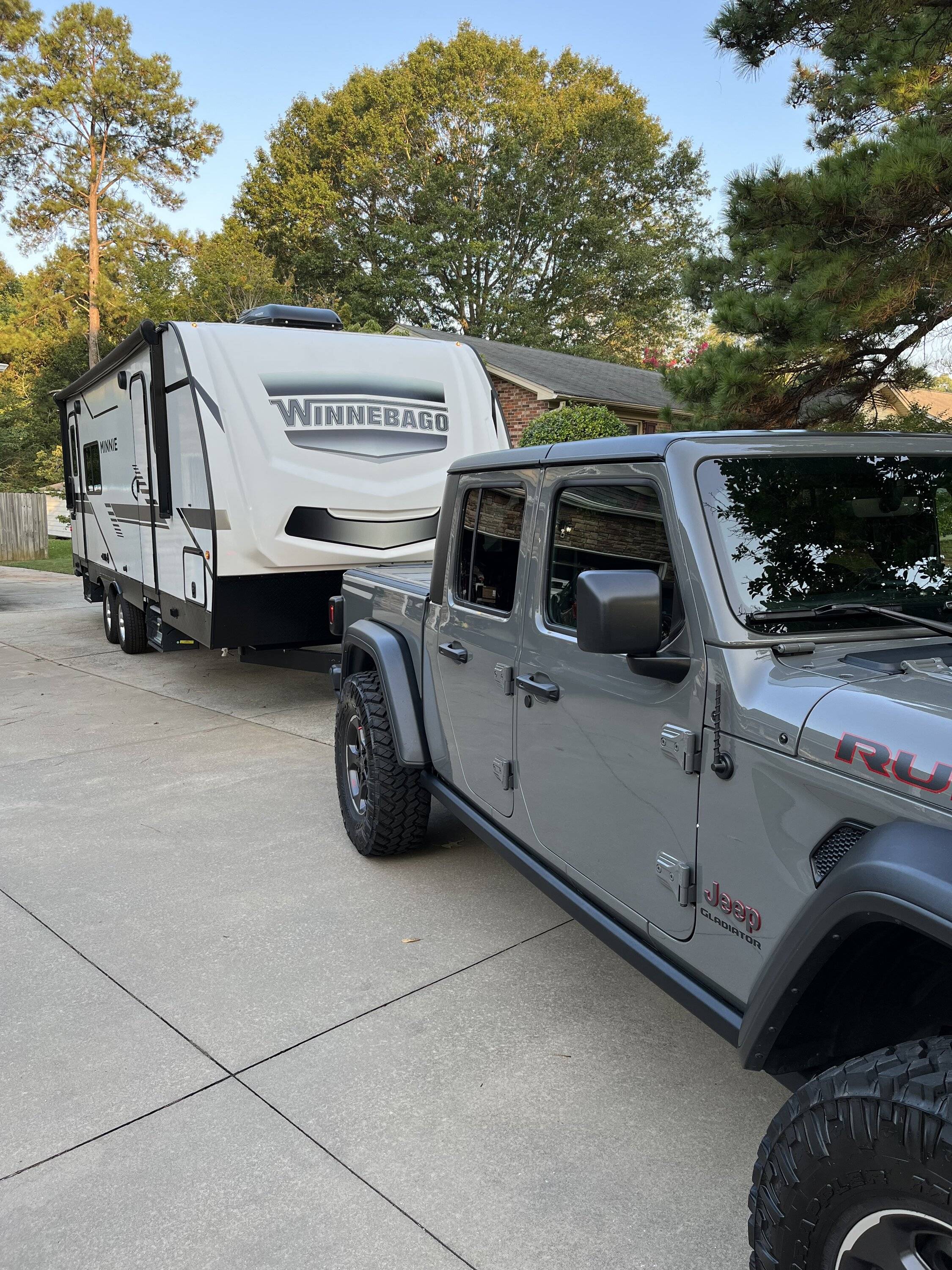

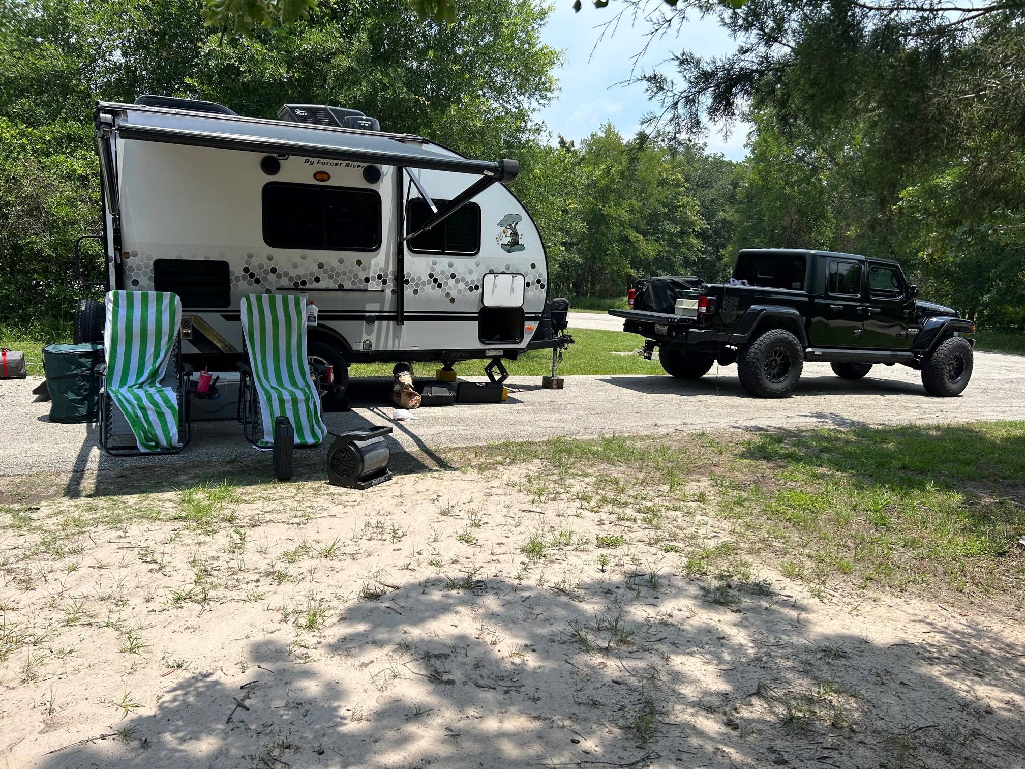

I pull a 6200 lb empty weight Winnebago with a 2022 Rubicon Highly recommend a Reese sway cam system. They will sway above 60 mph

I have the BlueOx WDH/sway control system for my set up...27' Vantage Sonic SN220VRB and Overland.
Works great. No sway, even at 65 MPH and minimal to none when getting passed by a semi like I'm standing still.

Nice trailer but I don't think you will like towing it. Pretty easy to load up a camper to gross and it is big.
Start adding up realistic numbers for a 3 day weekend….
Actually weigh your stuff, you'll see it adds up pretty quick.
375lbs water, 40lbs propane, food, beverages, bottled water, clothes, bedding, toys (adult & kids), camp comforts. Should ask if listed tongue weight is dry or gross.
Course some can be carried in the JT… but you have to watch weight there too. People, 155lbs gasoline, WDH weight, any mods or add ons, tools, recovery gear.
The frontal area of the trailer and aero drag take their performance toll too.
Where and for how long drive should be considered. Turnpike vs secondary. Elevation and grades.
To much trailer and weight really takes the fun out of it.
If it gets ugly and your over gross your insurance company will stop taking your calls….and lawyers will be calling.
Thats my free opinion.

Get a good weight distribution hitch with sway control. I use a Curt. A good trailer brake setup that works and mirror extensions. I tow a similar load with my 2020 Rubicon. I do have Max Tow.
