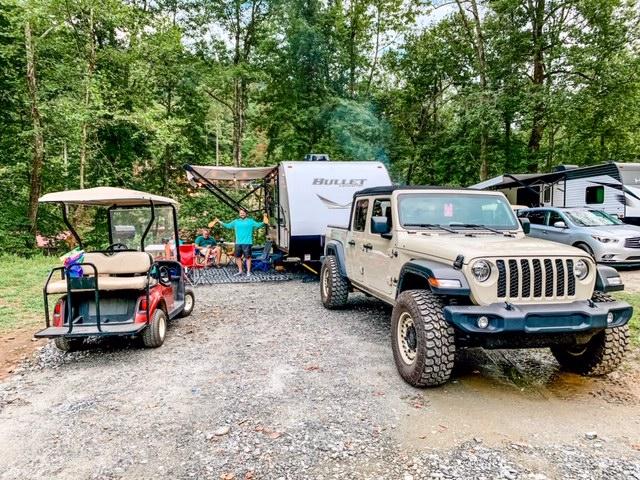

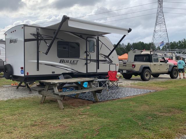

Ok, time for an update. We've towed 3 times with no issues (knock on wood). The camper is 3380, so I'm probably around 3900 loaded up. The break controller is a big help, glad I added it. Getting around 10.5 MPG. I'm very pleased so far! We're having a blast!
