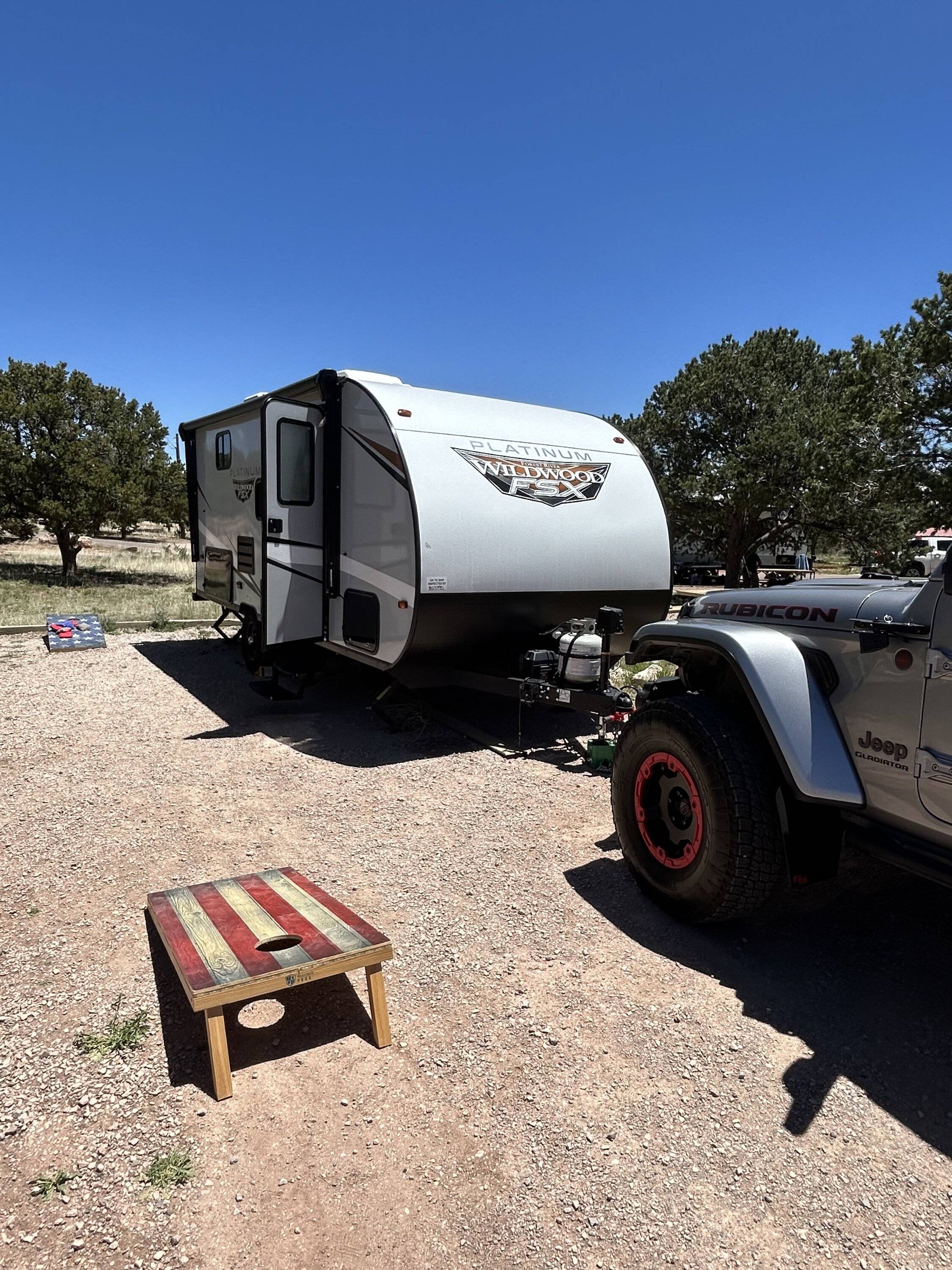

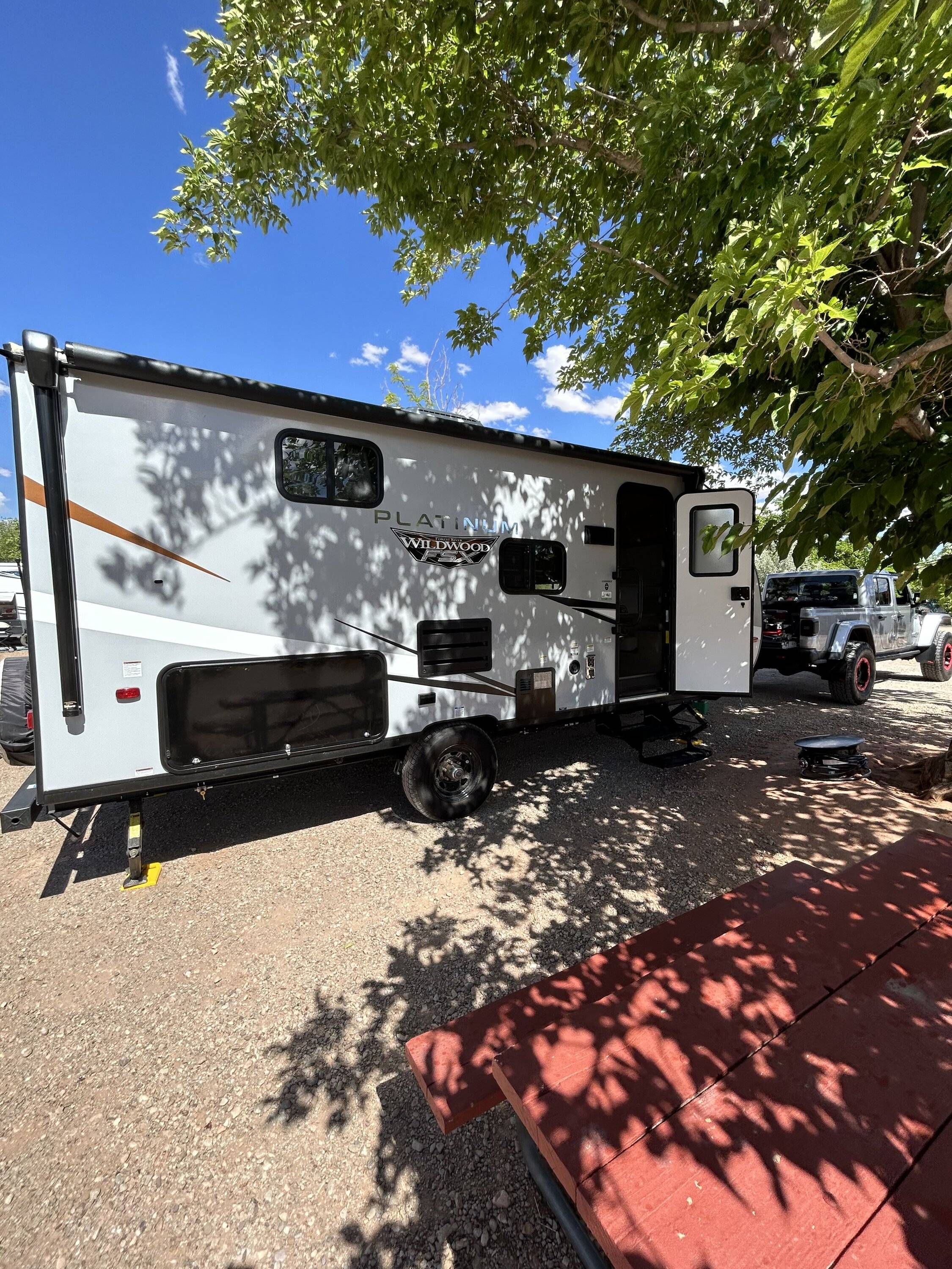

I have a rubicon with the 3.6. Tow a very similar weight trailer. I have a weight distribution hitch and mopar break controller. Tows fine on flat ground. hills were rough but I live at 5200ft above sea level. I recently upgraded to 5.13 gears helps a lot with hills. Slow and steady and you will be fine.

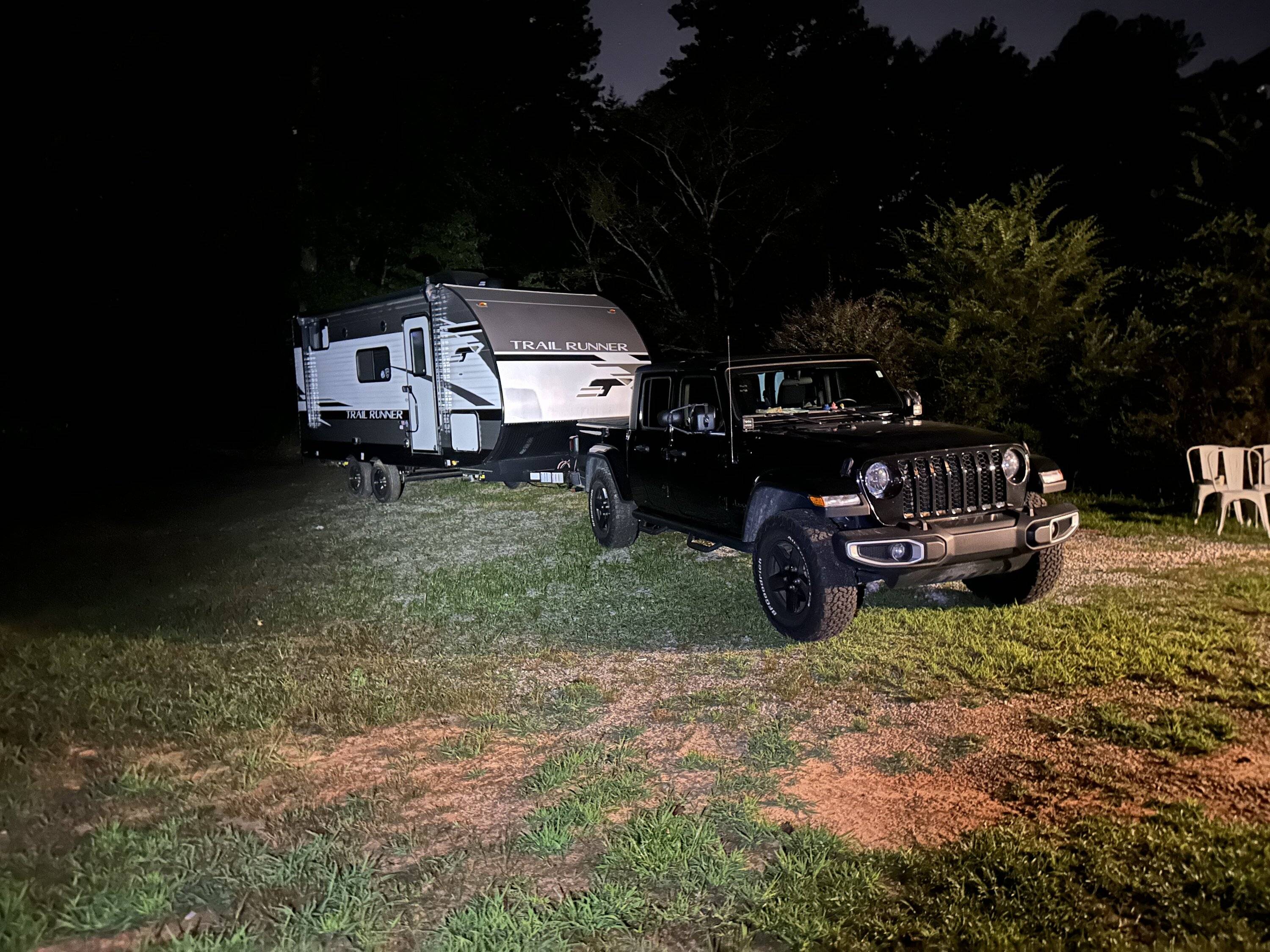

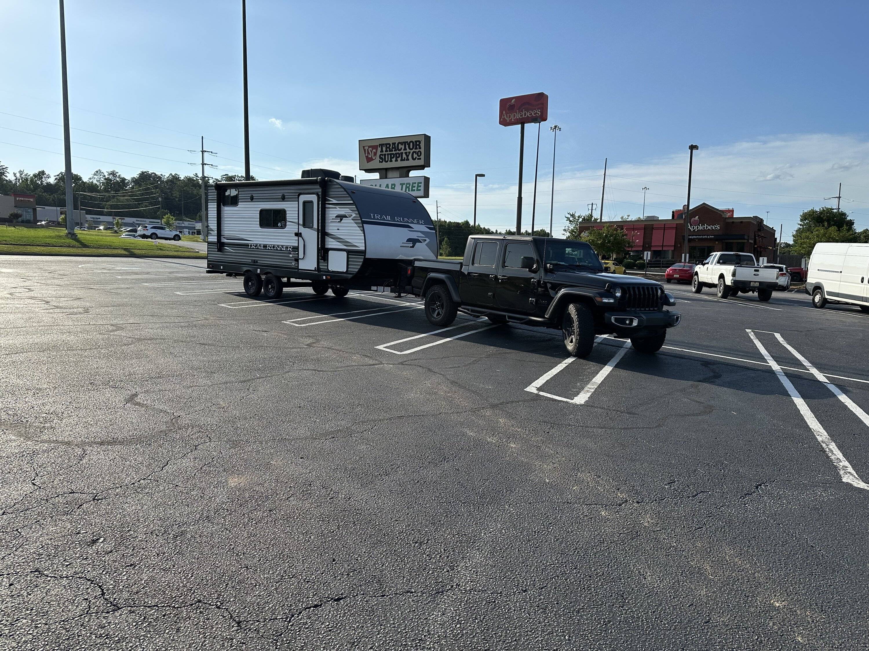

I think you'll be just fine. I have similar setup, 4200 dry. Got about 11mpg Chicago to Nashvile and back a couple weeks ago. Set the cruise on 65, usually got to 70 when passing slower semis, gladiator handled the whole trip very well.

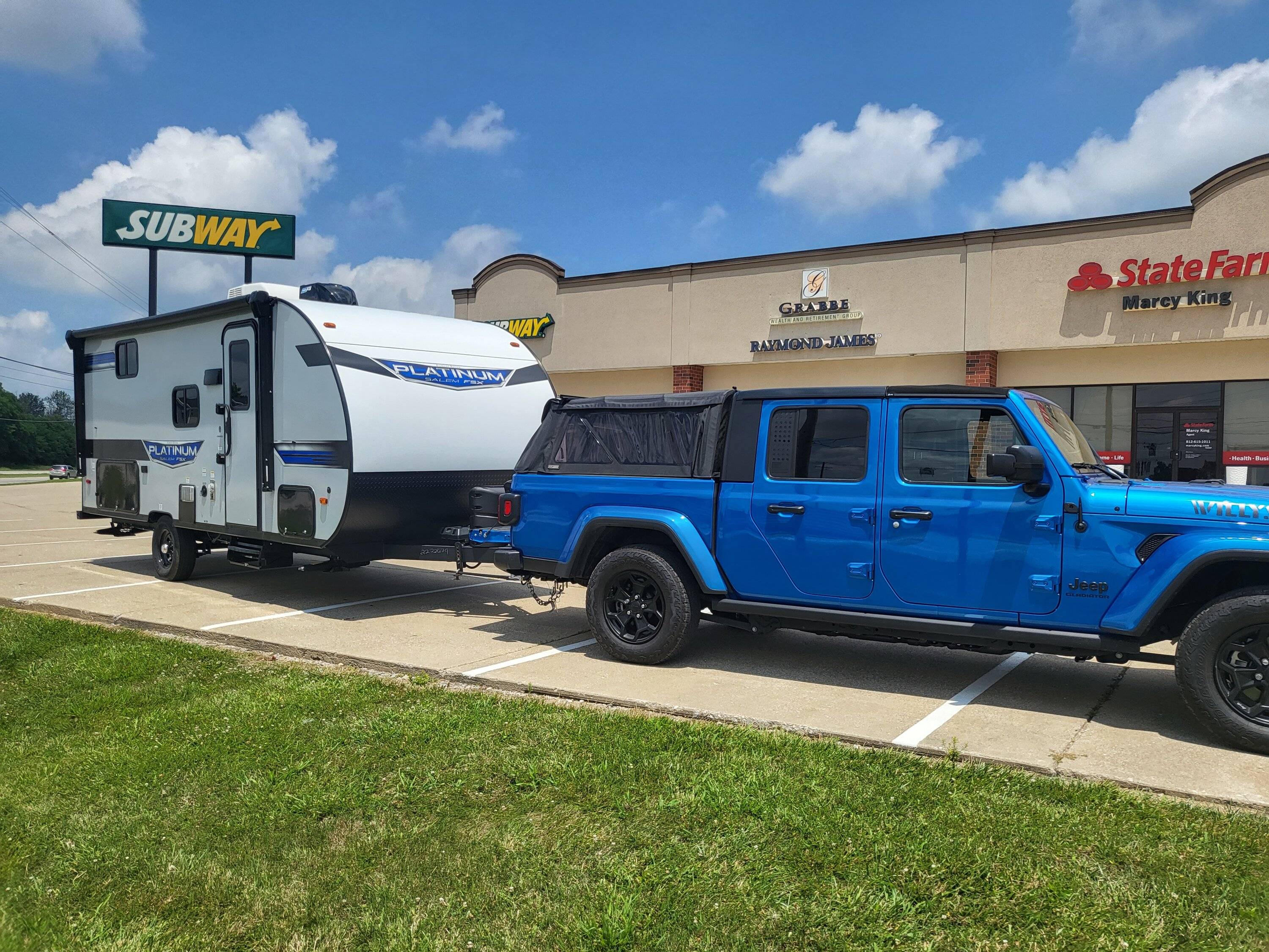

Nice camper you got! I like that rear storage fold up bunk. Had a similar thing on the driver's side in our old camper, but it didn't open to the whole camper like that. Pretty slick. New one is very similar layout to yours, but a murphy bed in front and dinette is on a slide. The curved front is noticeably better from the wind resistance aspect. Our old camper was 1000lbs lighter but very upright in front. The 4200 might actually tow better with that more aerodynamic frontal area.
Happy camping, enjoy!

I have that same trailer! Just a a different color pattern.
