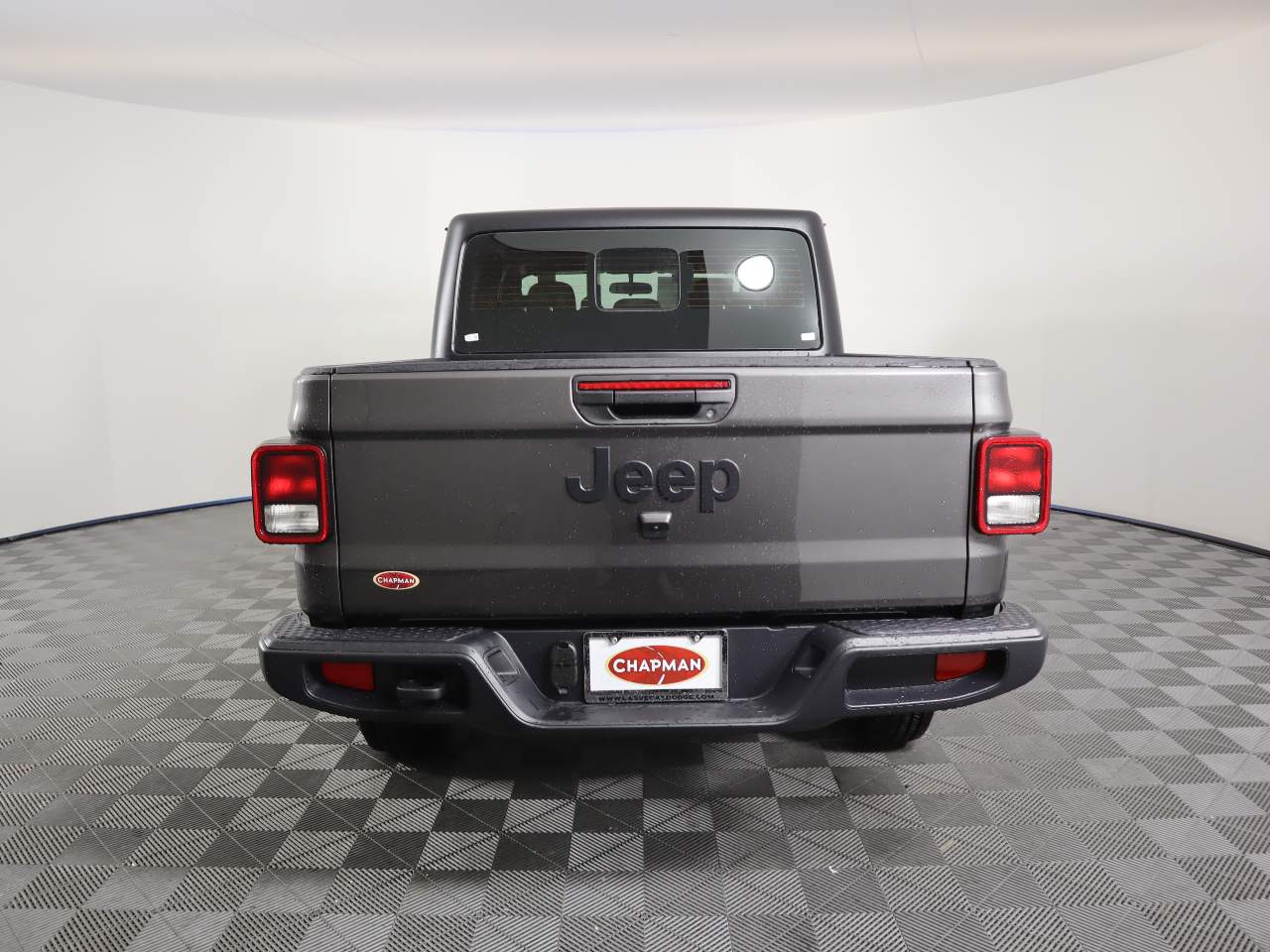

Alot of things getting tossed around here, so I wanted to offer some clarity:
No-tow package: Every gladiator has the option to pop a hole in the bumper and install a trailer ball, good for 4,000 lbs. Every gladiator has the 4/7 pin connector as well as built in anti-sway control.
trailer-tow package: All of the above, plus a class IV receiver, and "HD cooling" (which is just a bigger fan and subsequent alternator to run it). good for 6,000 lbs
max-tow: All of the above, plus springs with a different rate, wide-track Dana 44's, and 4.10 gearing (with LSD). good for 7k and change.
NONE of the above have a sticker on the door or otherwise that inform anyone what their tow ratings are. Hence all the confusion.
I added the class IV to my willys, wouldn't hesitate to tow 5-5500 lbs with it. 6k maybe on a very short trip (like from the lumberyard straight home or something).
