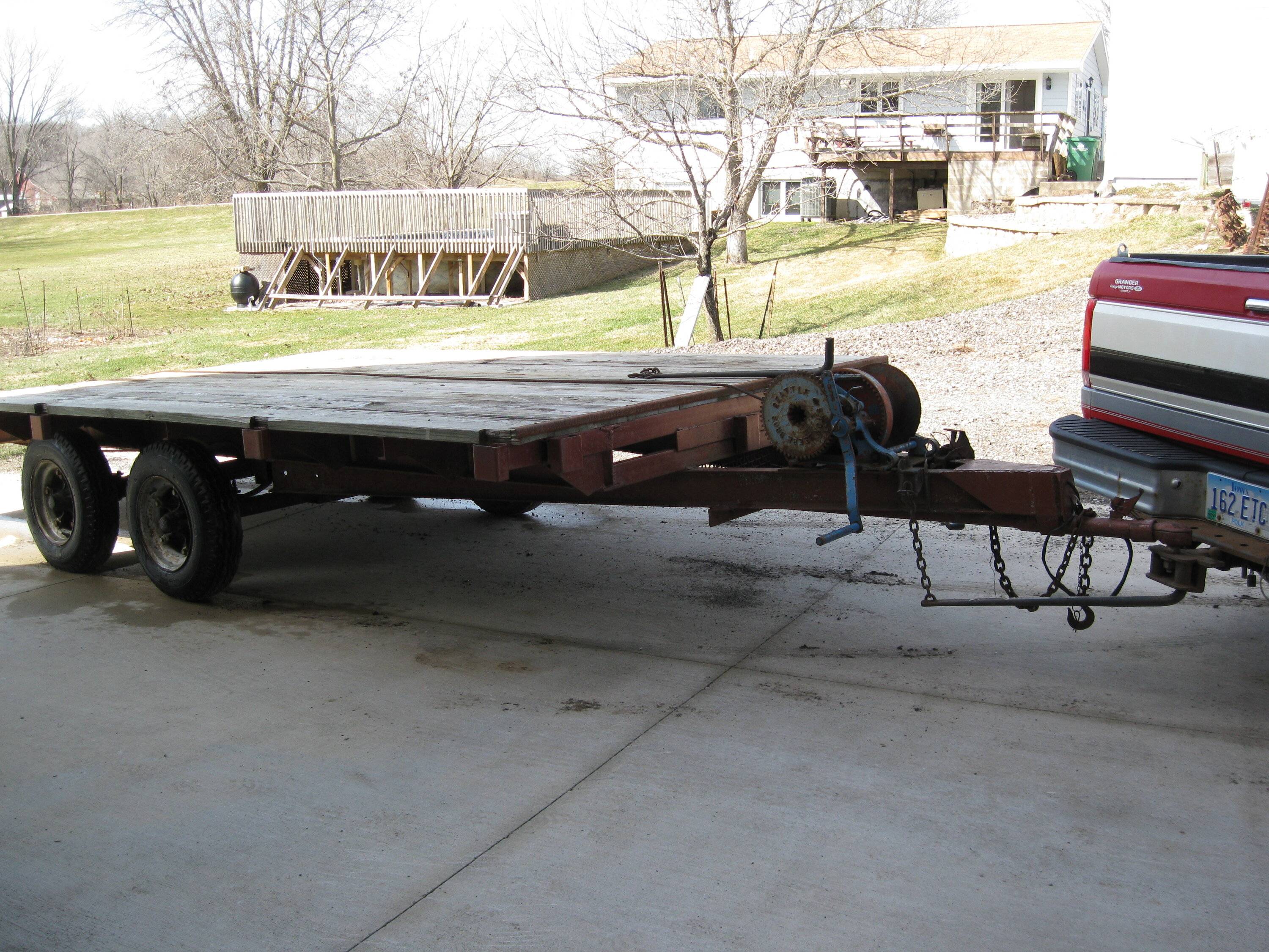

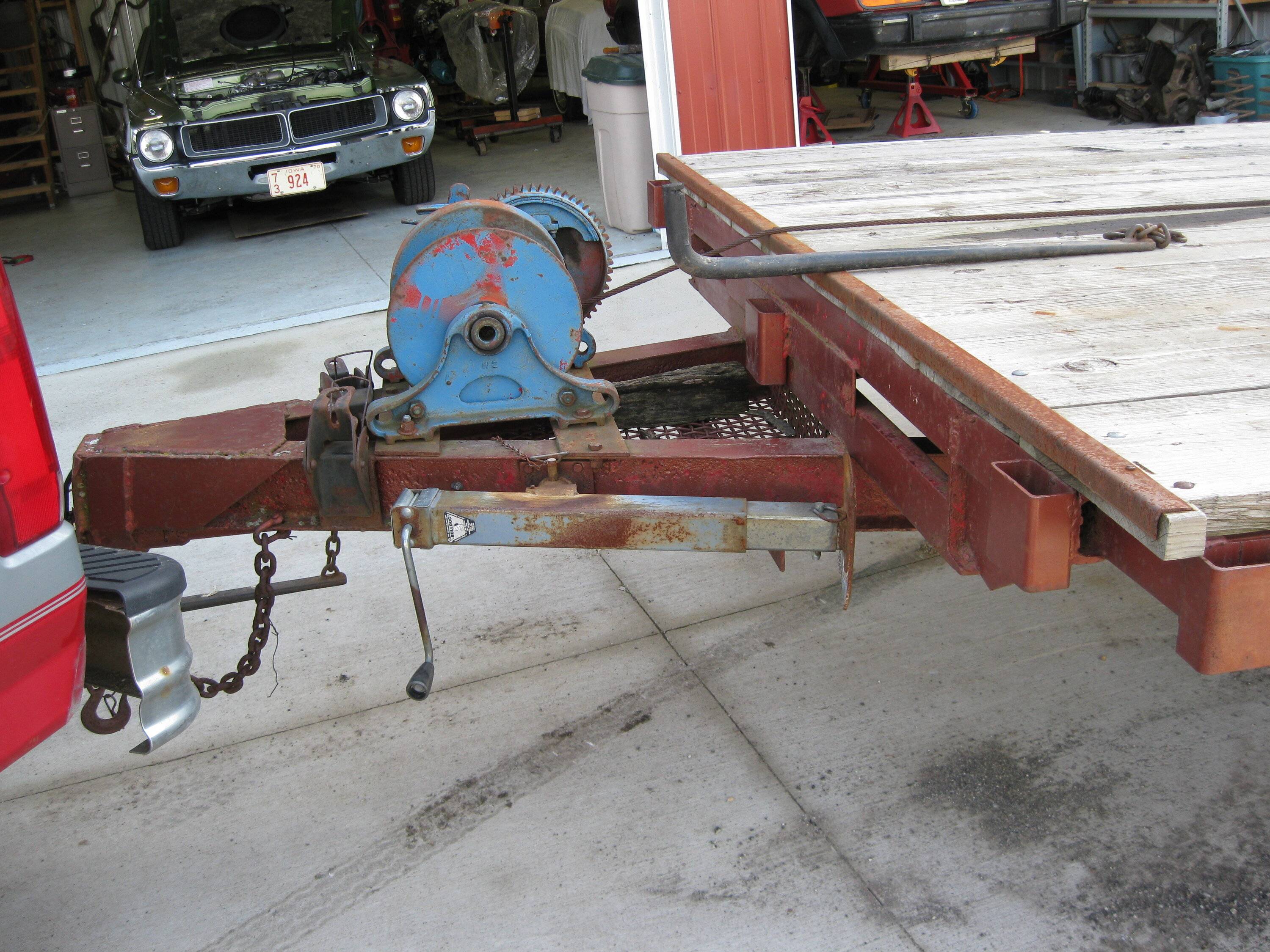

My first flatbed trailer was a 3,000 + pound home-made rig I traded for from a farm equipment scalper. He hauled tractors and he showed me a picture where he had 3 disks stacked up on top of the trailer hauling the to his place for sale. You needed a stout truck just to hook the trailer up it was so heavy. NO BRAKES because it was exempt as "farm equipment". I hauled my F20, an IH 656 utility tractor with loader and other stuff on it.
Took two of us to mount my winch on it as the winch was so heavy. A friend called it a rail car on tires. The ramps were almost 100 pounds each, channel iron. We moved the axles back after I traded for it because it was too well balanced - not enough weight up front.
Note the truck - you base your tow vehicle on what you need to tow and base what you want to tow on your tow vehicle.
Note the stupidity of the single safety chain.

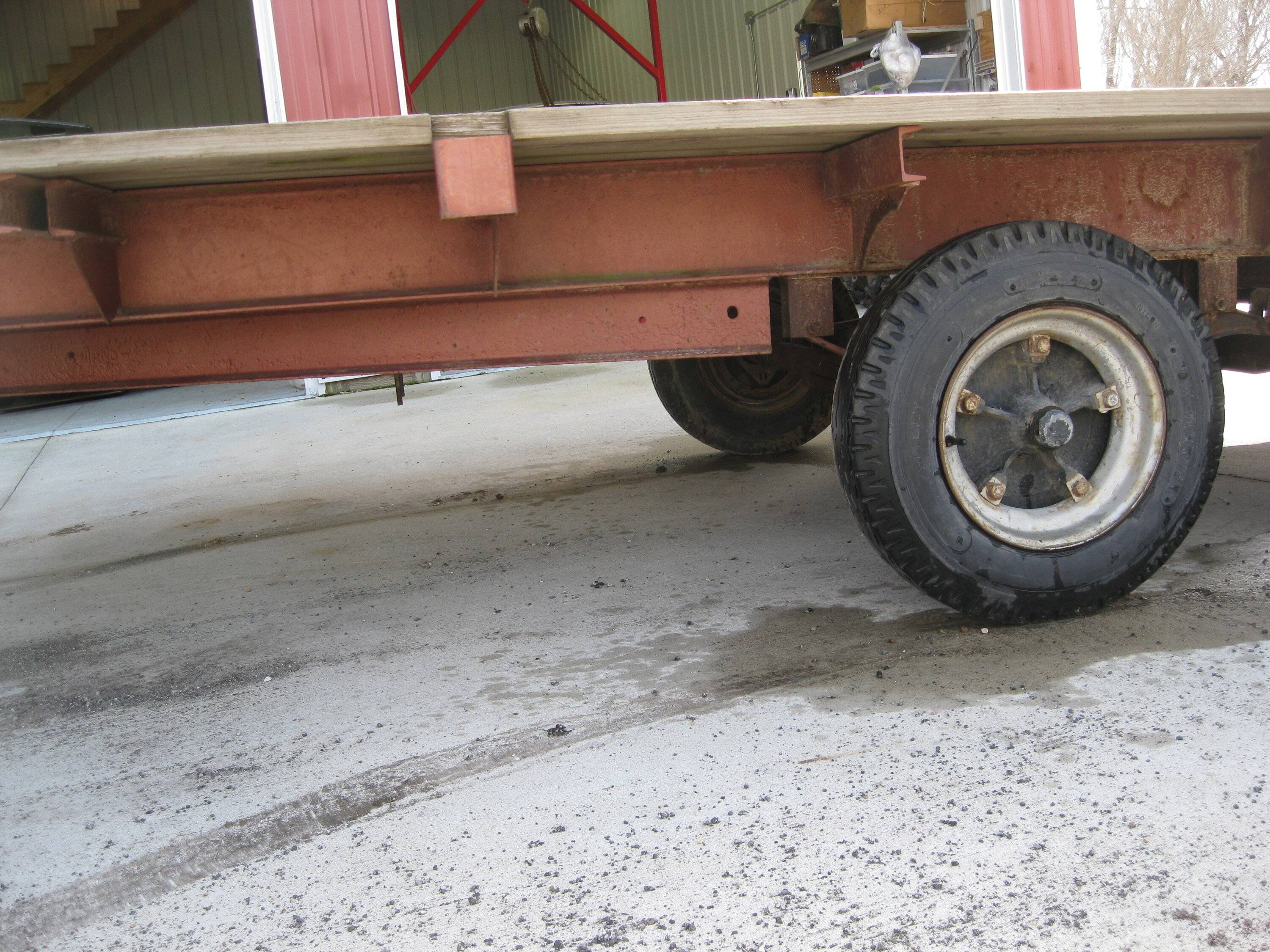

I-beam frame, maybe it started like as a mobile home chassis?

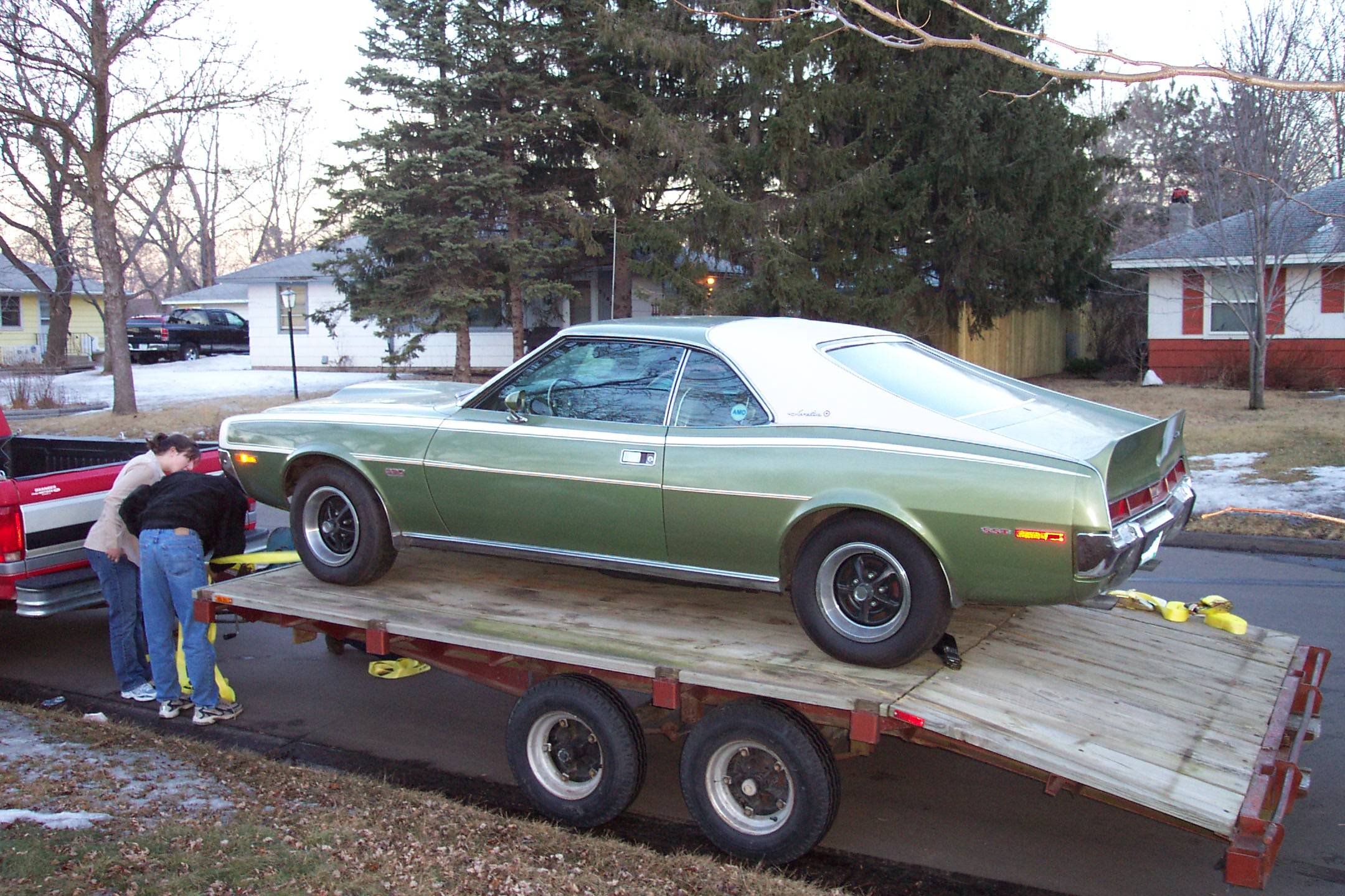

North of Twin Cities picking up my 2nd Javelin on that beast of a trailer - in the winter.

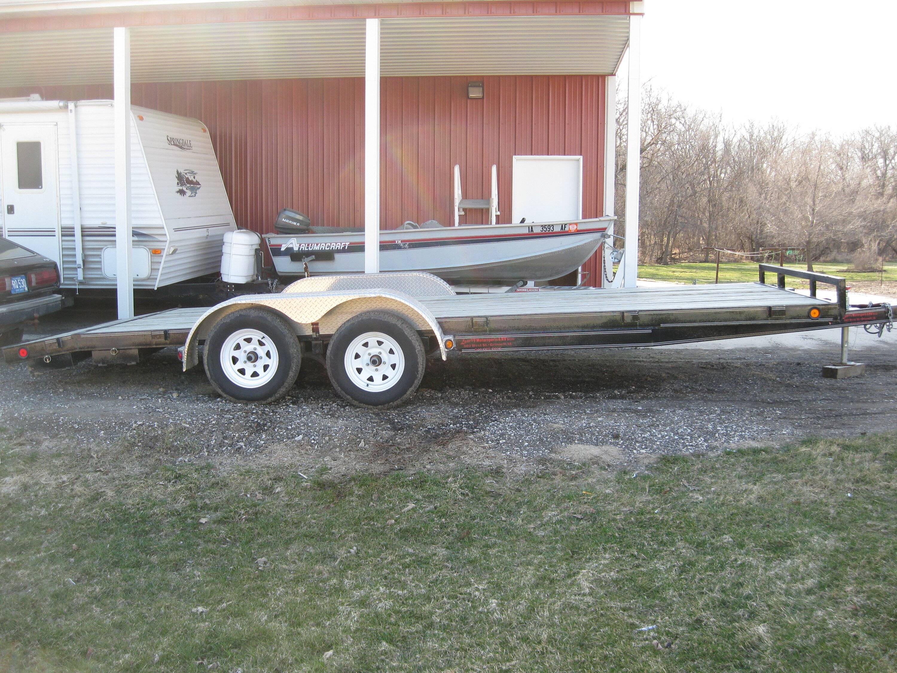

This was my second flatbed - axles back stupid far IMO, crazy tongue weight, had to keep the car so far back the rear wheels were almost on the beaver tail if the car was longer than a sub-compact. But it was a nice trailer. Just heavy, too heavy for a JT so I traded it for my Aluma, on the advice of my wife LOL.
