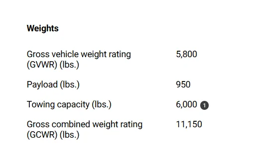

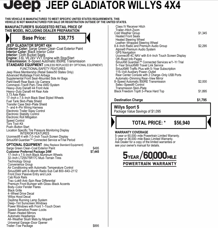

So how accurate is General RV?
Jeep Gladiator Towing Capacity of 2024 Gladiator Willys 1774823435602-p8
Jeep Gladiator Towing Capacity of 2024 Gladiator Willys 1774823462808-ka
40,496
54,011
Jeep Gladiator Towing Capacity of 2024 Gladiator Willys 1774823540420-s3
The above from Jeep.com
Willys, apparently based on Sport, would obviously match the Sport with tow package. Almost everything is 6,000 pounds save for Rubicon or any level with max tow. And if you don't know whether or not you have that - I could say something but it might tick off Jay.

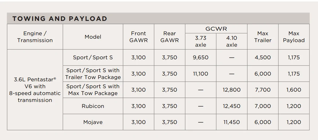

This is 2023 -
Jeep Gladiator Towing Capacity of 2024 Gladiator Willys 1774824004795-ky
From a buyer's guide on the internet -
Jeep Gladiator Towing Capacity of 2024 Gladiator Willys 1774824160024-ei
If someone knows how to use logic and extrapolate and knows which models are based on what, there isn't much you can't find. But it takes an ability to think. People want things handed to them these days.

That just looks like they have it set to best case scenario that will allow them to sell you what is the most profitable from that printout it shows 6 speed manual way over rating. Setting all the back and forth aside i would trust the 6K Willys and Mojave when you consider the GCWR and other numbers on the Gladiator. The only concern i could see with a manual compared with an automatic is the manual it is up to the operator to avoid shock loads on the components the automatic has the cushion built in to avoid it.

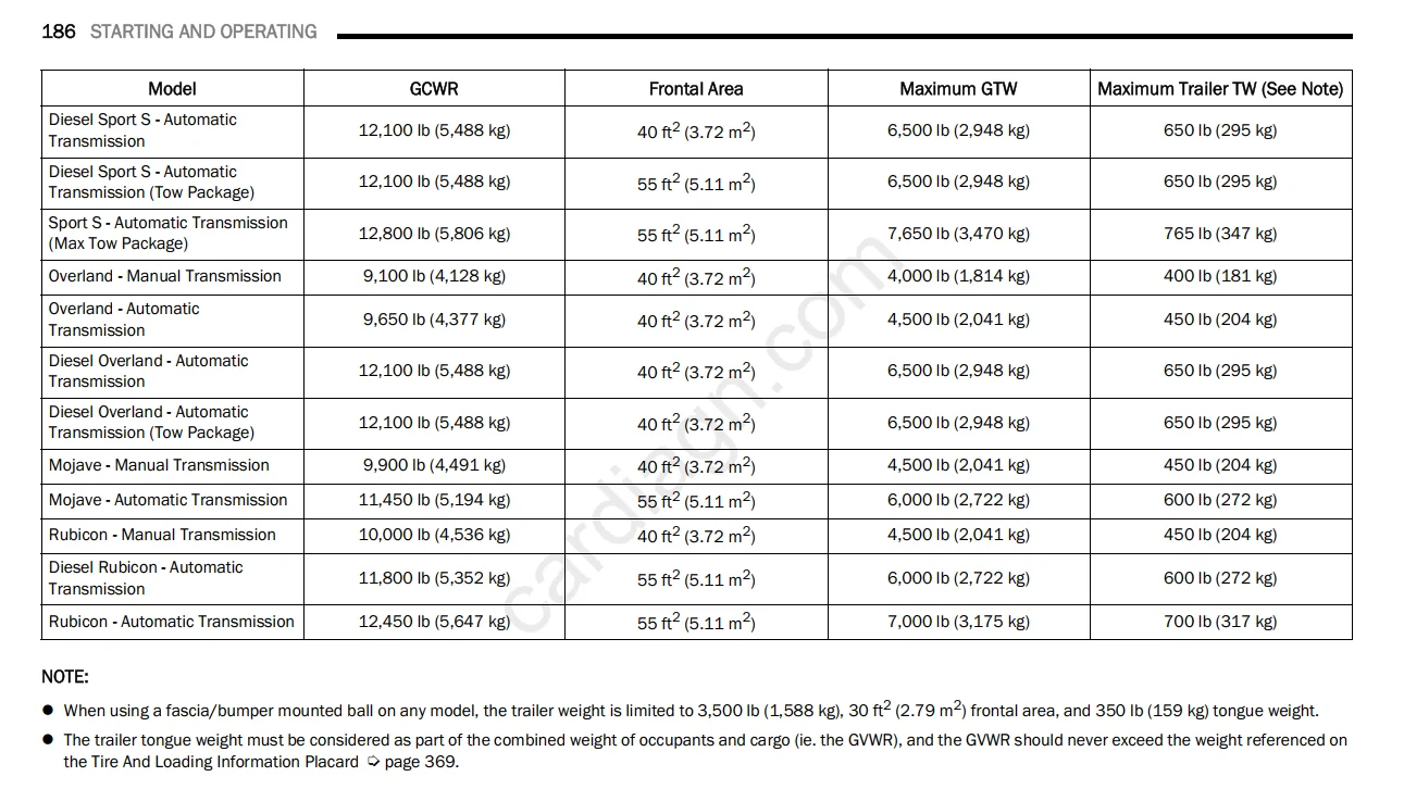

And what do you know, we immediately have a good example of somebody that has a question about the tow rating of their vehicle and we have an online reference that provides the wrong answer. Shocker.
Earlier owner's manuals included tables which broke down the tow ratings based on the options that the vehicle came equipped with. Later owner's manuals do not have that info in them. In both cases we still have owners that are confused about what the correct tow rating is for their vehicle, for some reason or another. The problem is worse with the later manuals which do not contain the tow information and instead refer to a website, with predictable results.
At the very least Jeep should put the tow tables back in the owner's manual where they belong. No more trying to dig through webpages and try to discern which ones have reliable information and which don't. It'd be nicer still if they'd lead the way and do the courtesy of putting the "as equipped from the factory" tow rating and/or the combined gross weight rating on the door jamb sticker like they do for the payload figure.
