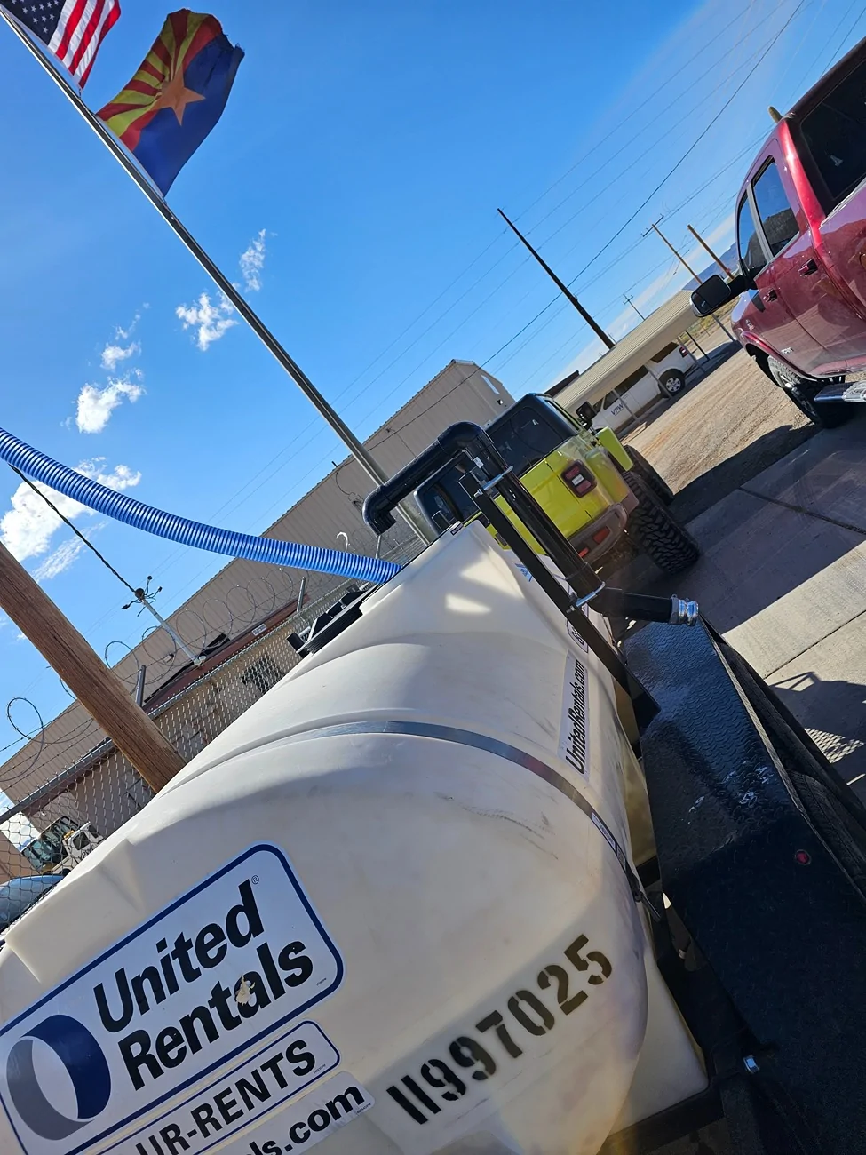

Jeep Gladiator Towing Capacity of 2024 Gladiator Willys 20260212_143813
40,496
54,011
On occasion I'll hook up a 7k+ pound trailer and not worry about it for a second., despite the 6k pound factory rating.

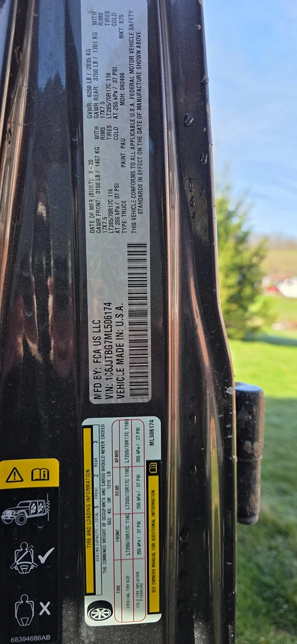

Post up a picture of the sticker on your door frame, I'd love to see where it shows the tow rating or even the CGWR.
Mines got axle weight ratings and nothing else. Not even the GVWR. And if you add the axle weight ratings it's 6,800lbs combined. 1 more reason nobody is ever ticketing you for numbers that are hidden somewhere in the manual.
Jeep Gladiator Towing Capacity of 2024 Gladiator Willys 1774791219410535613541721527233
40,496
54,011
Every one of mine has shown the GVWR.
Just not combined weight rating

Looks just like every other JT's door jamb stickers: no tow rating or combined gross weight info. Kinda pointless to tell somebody asking about tow capacity to open their door and look at the sticker huh? ;)
40,496
54,011
They never have shown the towing capacity. Ever.
The payload is shown ONLY because it varies with the specific combination of accessories and options. That's the one and only reason. Otherwise they could simply say "look in the book".
Tow ratings do not vary with specific factory options, payload does, thus, they print one and not the other.

Yep mine says 6250# its right there in the picture. Took it this morning
