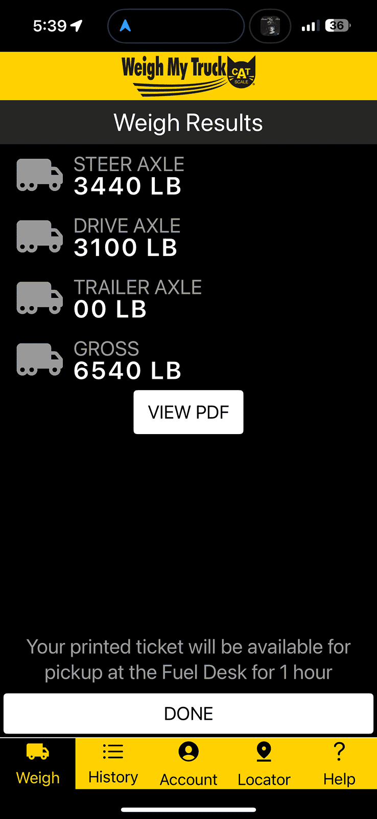

So we’ve concluded that the max weight I can tow in its current state is 5,910lbs. Got it.
Now, how about tongue weight? Tongue weight seems to contribute to payload, right? With the max payload being 1,245lbs and the max tongue weight 700lbs, it seems like a bit of a sliding scale. Meaning that for every pound over 545 pounds of payload, that’s one reduced pound of max tongue weight. Right?
if that’s true, and the actual payload of the modifications (not including wheels and tires) + people + gas + stuff is 815lbs (for example), then the max tongue weight is now 430lbs… right?
Is the 1,245lbs payload you mentioned from the yellow door jamb sticker? Wheels and tires count against your payload also.
Per your CAT scale results, you have no payload left for tongue weight: 6250 GVWR - 6540 actual weight = -290 over
You could tow 12,450 GCWR - 6540 actual weight = 5910 lbs if you find a way to shed weight and free up payload for your tongue weight.
yes! 100% correct.

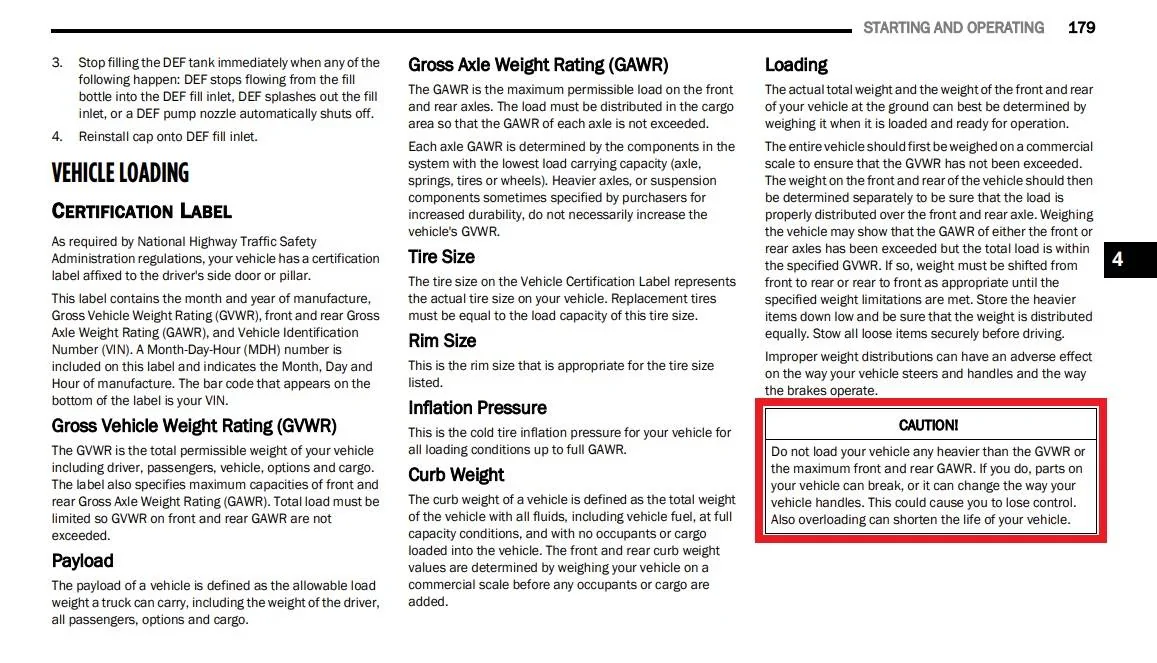

Factory payload is based on GVWR minus curb weight.
Curb weight is the weight of the vehicle with all fluids, stock, from the factory, a full tank of gas, all coolant and oil levels where they should be. That's curb weight - it does include a full tank of fuel.
