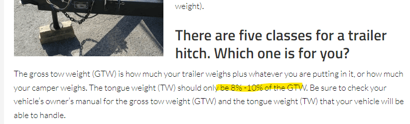

Well, I found one company that makes trailer stuff that supports what I read months ago - I was not remembering it incorrectly.............
Jeep Gladiator Mojave towing capacity? 1656017162316

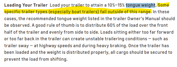

Here's another - I knew that the 10-15 was just too generic. Chevrolet says that doesn't apply to all trailers or trailer types.
I believe I saw a place that said with the front trailer axle xx distance from the hitch would be a different percentage. Chevy agrees - not all are the same. They say look at the book -
