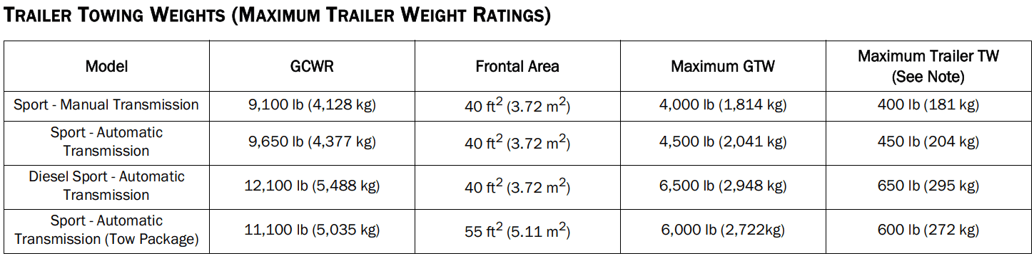

Looking for some help, as we all know the towing capacity’s are all over the board!! I purchased a 2021 Gladiator High Altitude, it did not come with any factory tow package, I’ve added the class IV factory hitch. As far as my research goes I believe my towing capacity is 4,500#. Does this seem correct? Thabks

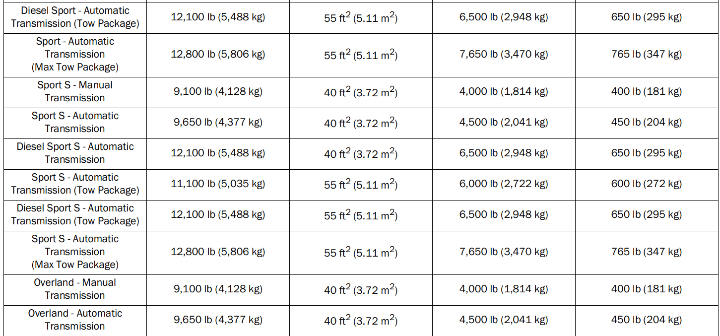

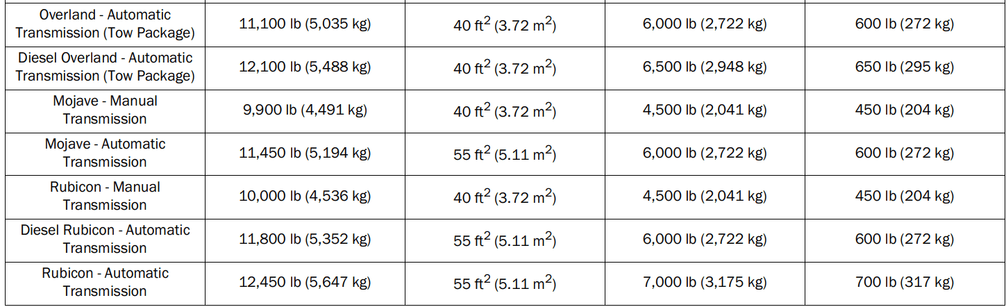

Ironically, this is from the 2022 Gladiator owner manual - and the High Altitude was definitely available to order in the 2022 model year so I'm not sure why it's not in the book.
All I can figure is that since the HA is an Overland at the root, they must have inherited the same towing numbers from Overland.
