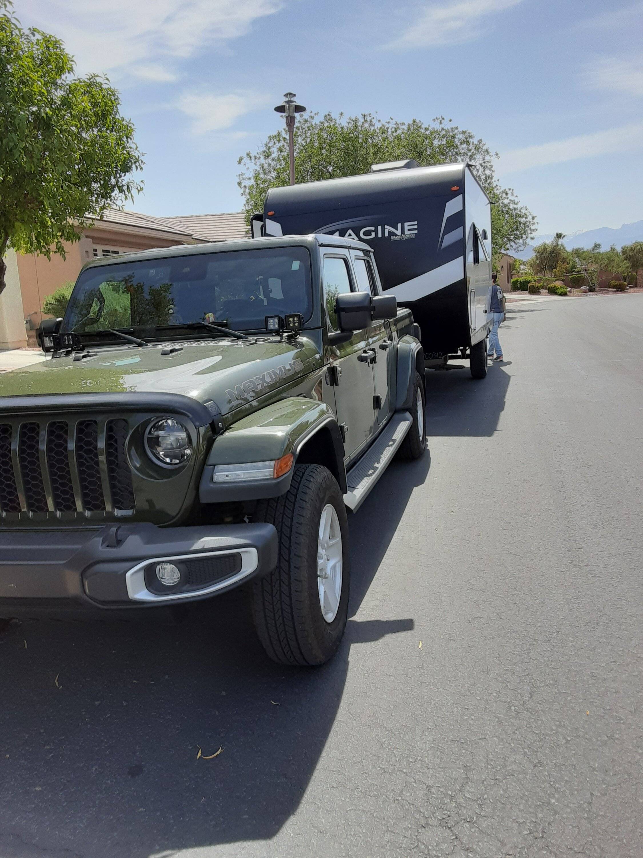

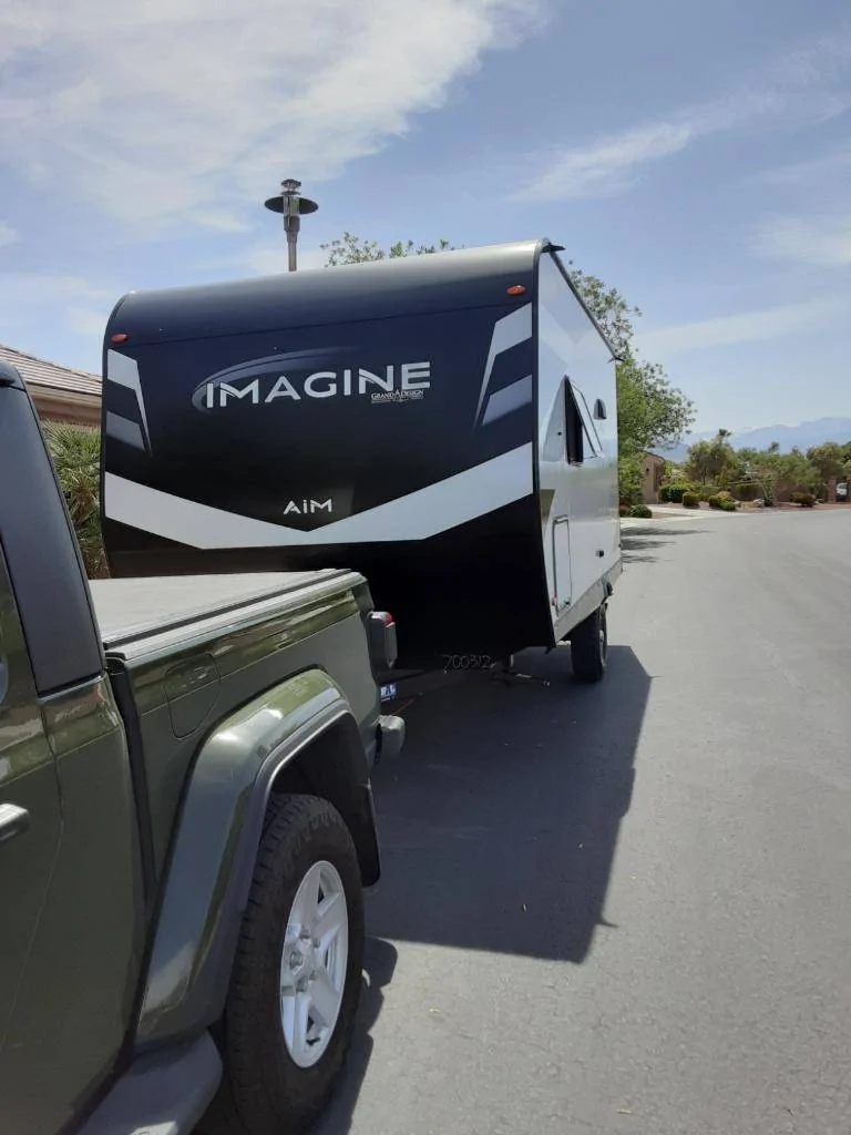

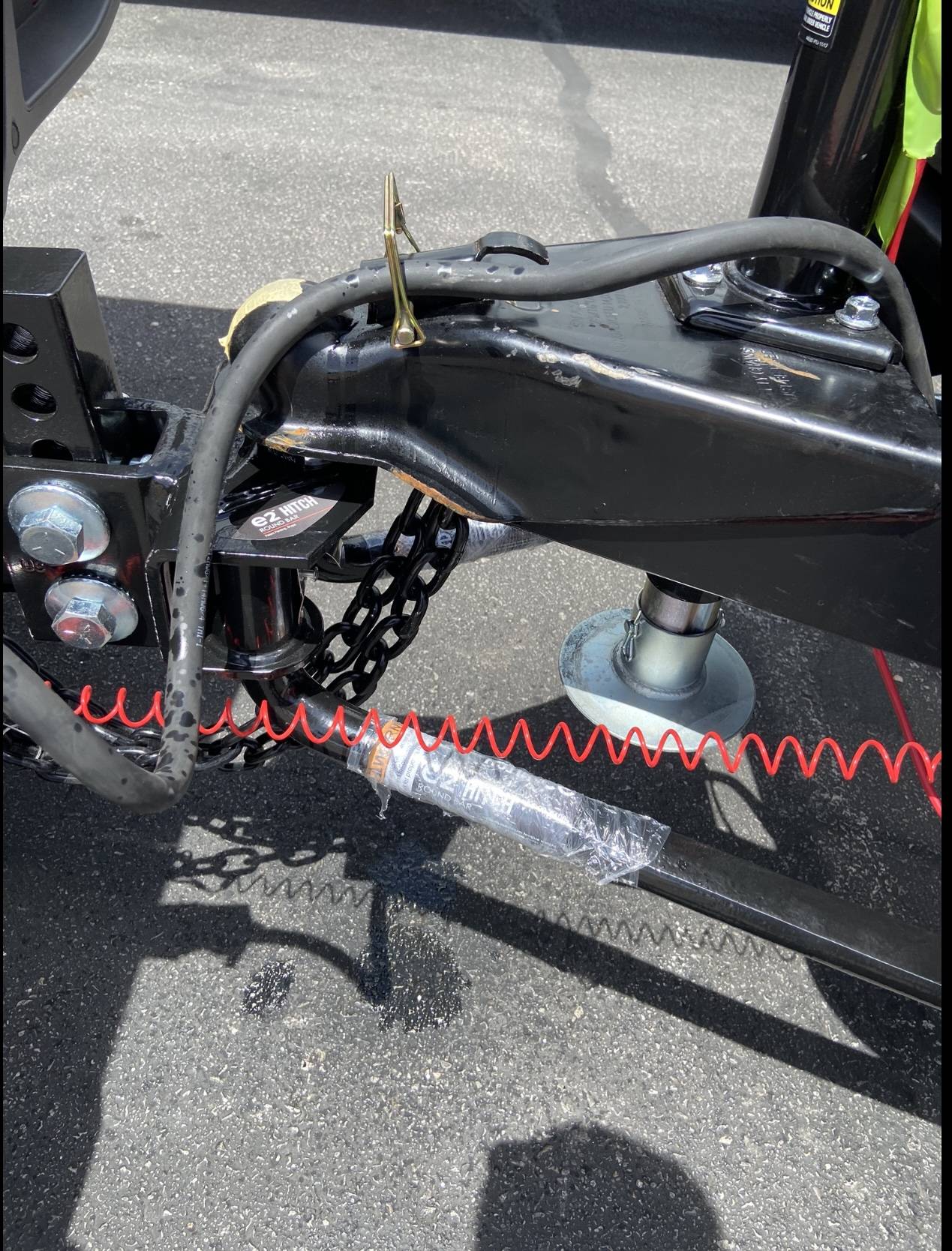

6K is more than enough for any GLadiator. I have the Max Tow Sport S and would not tow anywhere near 6K even with the 7650 capacity. The one time I did thin about it I regained my brain capacity!
My current travel trailer is a Grand Design Imagine AIM 15rb with a UVW of 3594 and GVWR of about 4795. Length 19’11 and empty hitch of 378 meaning even at 15% of GVWR on the tongue I am still well within my numbers..
The trailer is well below my tow capacity and even better well below the weight of my Gladiator.
Perfect couples camper. Towed it in 20 mph crosswind and it held true and straight with a WDH and sway control.
