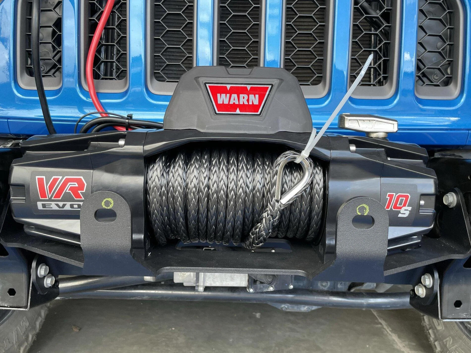

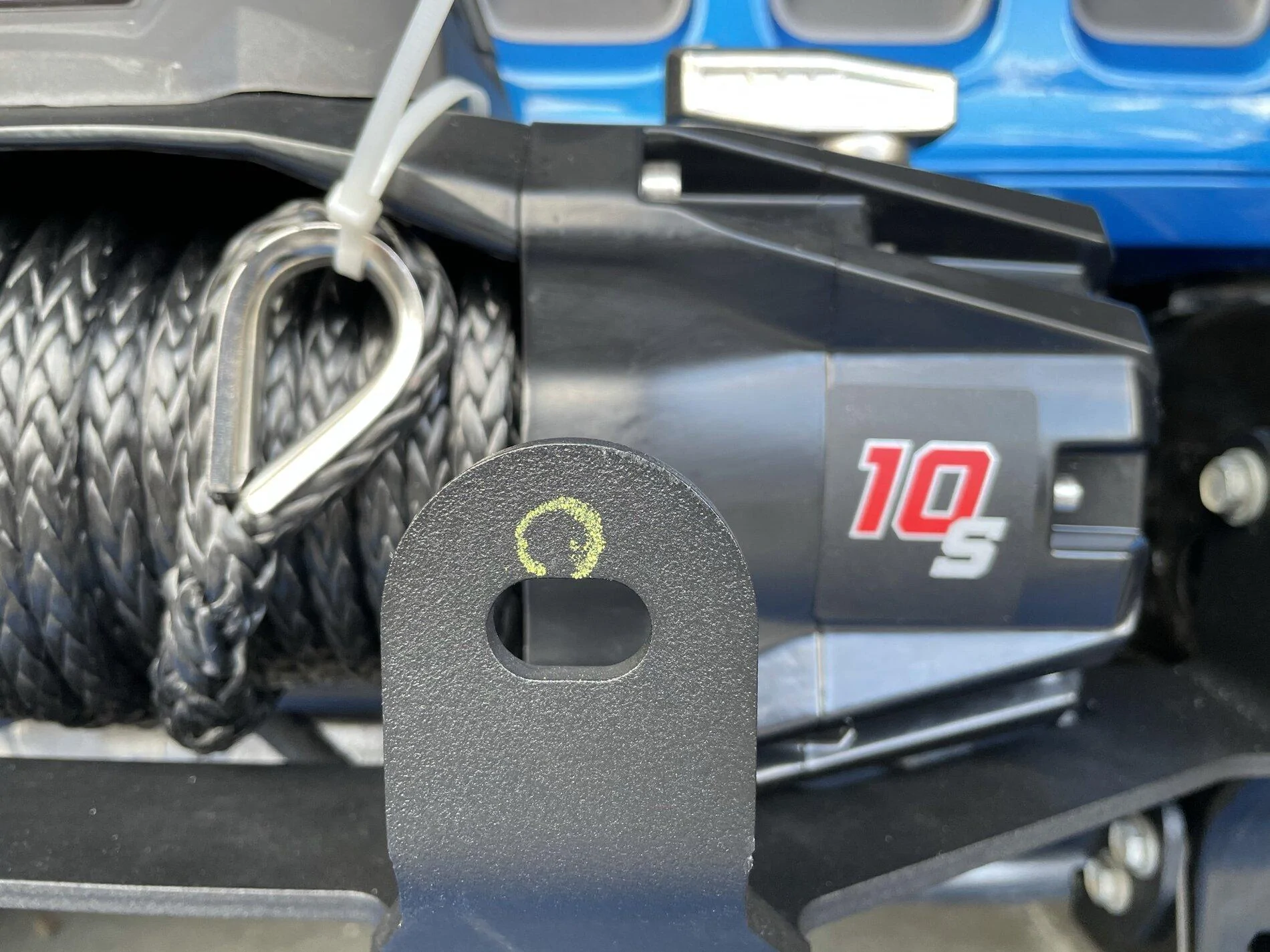

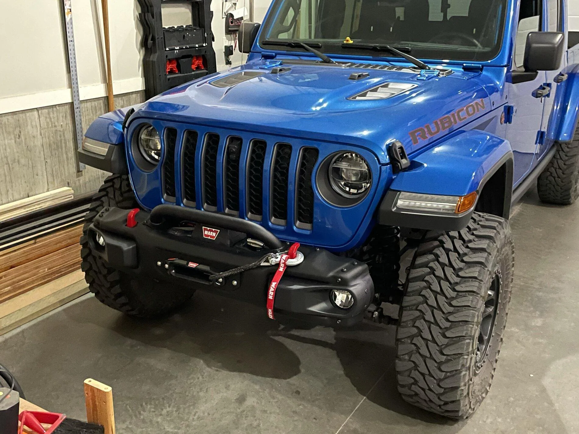

Today I installed a Warn VR Evo 10S winch. I used the new Grimm off-road Jeep steel bumper winch mounting plate. The reason I chose that winch mounting plate was strictly because of availability. However I have to say the fact that its a fare bit cheaper than the Warn one and like less than half the price of the Mopar one.
I guess I’ll start with the thing I like about the Grimm product. The fact that it was one piece was a huge plus, also that makes for a very light product compared with the Warn/Mopar varieties. I didn’t weight it but it couldn’t weigh much more than 10-15 lbs at best. I only measured a 1/4 inch sag so that gives you an idea of the weight savings! The install is pretty self explanatory and you reuse all the stock bolts so that was pretty nice. They even supply you with so loctite witch was nice.
The only negative I have with the Grimm product was that the fair lead bolt holes on the Grimm winch mount plate didn’t line up with the holes on the bumper. This will be a huge piss off for people that aren’t equipped or don’t have the skill to deal with it.
My install experience was so so. The paper instructions that came with the Grimm winch plate were pretty good. That coupled with the install video that Northridge 4x4 just posted on YouTube your pretty much covered. The one big piece of advice I’d give is if your going to route the wire according to the Northridge video MAKE SURE TO HAVE EXTRA FENDER TABS ON HAND. There are 11 tabs per fender and unless you take the time to remove the fender liner so that you can carefully pinch the backside of the clips so that they pop through without breaking, your going to probably break at least half of them. Unfortunately my local dealer only had 2 in stock and I ended up breaking 6 so I attached the fender back on 4 short.
TIP #2 DONT FORGET TO CLIP BACK IN YOUR LIGHT CONNECTION! Lol I forgot to re connect my light so tomorrow I have to un lip the fender and replug in my lights.
Outside of what I said it’s a pretty simple job you will need to buy a 18mm deep socket and a swivel attachment to get the bumper mount bolts back on.
Next up I’m going to install the Grimm off-road ARB Dual air compressor inner fender mount. I guess I’m going to take my own advice and order a bunch of fender clips before I go breaking a handful on the other side of the truck!

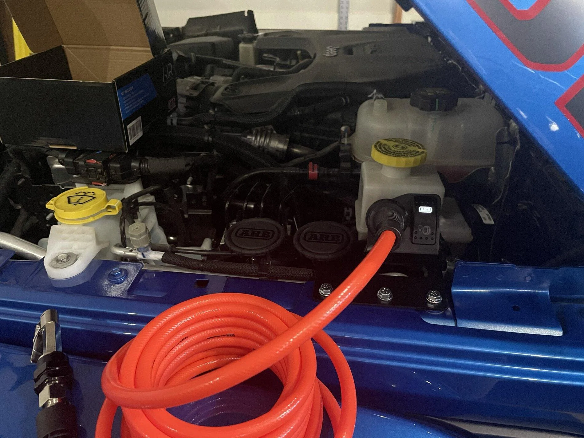

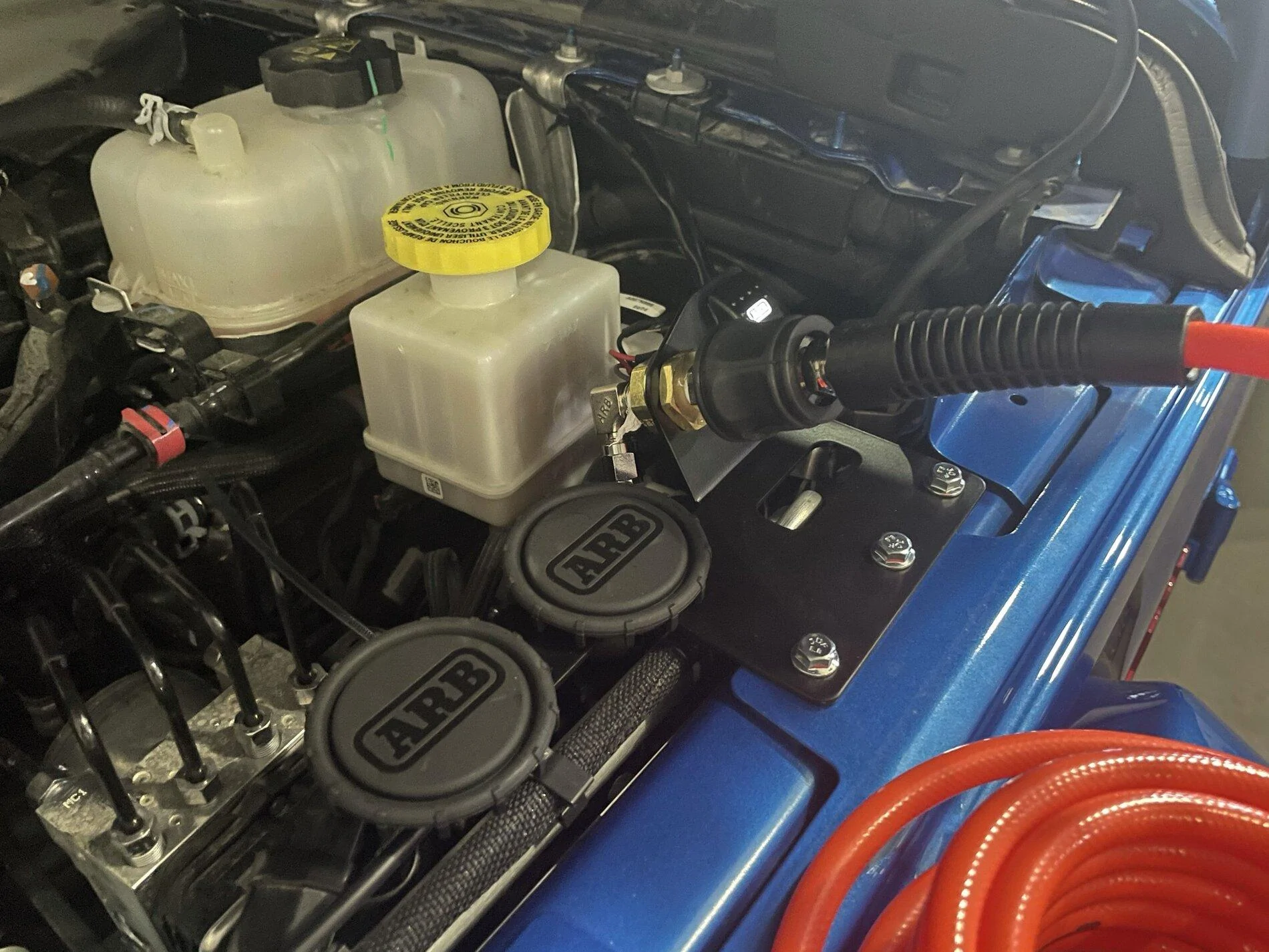

Yesterday I finally installed the ARB Dual air compressor with the Grimm off-road inner fender mount. I have to say that I am super pleased with both the compressor and the mounting kit.
The ARB compressor is no joke! I’ve worked in a machine shop for many years and have been around compressed airlines, this thing is a beast. Well worth the premium if you can afford IMO.
The Grimm off-road mount is also a fantastic kit! No surprises, everything went off without a hitch. Super clean install and looks great under the hood.
The only two tips I have is be sure to have ring terminals for the battery end of the connection. ARB Does not included them. Secondly and most importantly... DONT FORGET TO PLUG BACK IN YOUR FENDER WIRING HARNESS BEFORE YOU CLIP THE FENDER BACK ON!!! Two weekends in a row I forgot to do it...mother****er!

with this bracket would there still be a way to route a line underneath to an air tank with the hood shut?
NEWBWHEELER
NEWBWHEELER
May 13, 2020
355
564
BC
www.instagram.com
2020 Ford Explorer ST, 2020 Hydro blue Gladiator
Free loader
Yes. but the power switch is mounted there as well. You have to connect it to an Aux switch if you wanted to avoid having to pop the hood.
I should have taken a picture of the compressor mounted before I closed everything because there is even a spot to mount a small air tank for lockers on the the Grimm mounting plate.
The 13:00 mark shows the locker manifold mount location.

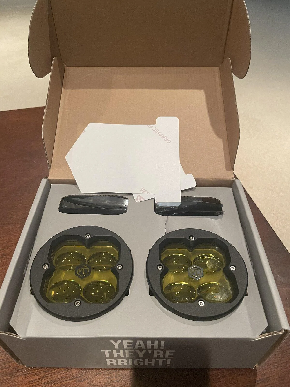

Well I’m not sure if any of you guys have heard of Vivid Lumen but they are a local company to me here in Kelowna BC and the make a pretty solid light. I picked up a set of amber fog lights today at a very reasonable $297.00 cnd. tax in compared to $550-$650 for the Baja design ones. I’ll install them this weekend and add more pics then.
I love them. One of them took on water because of a shitty valve. I called the and they gave me two new ones with the new designed valve.
