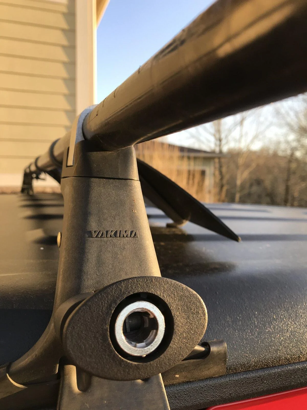

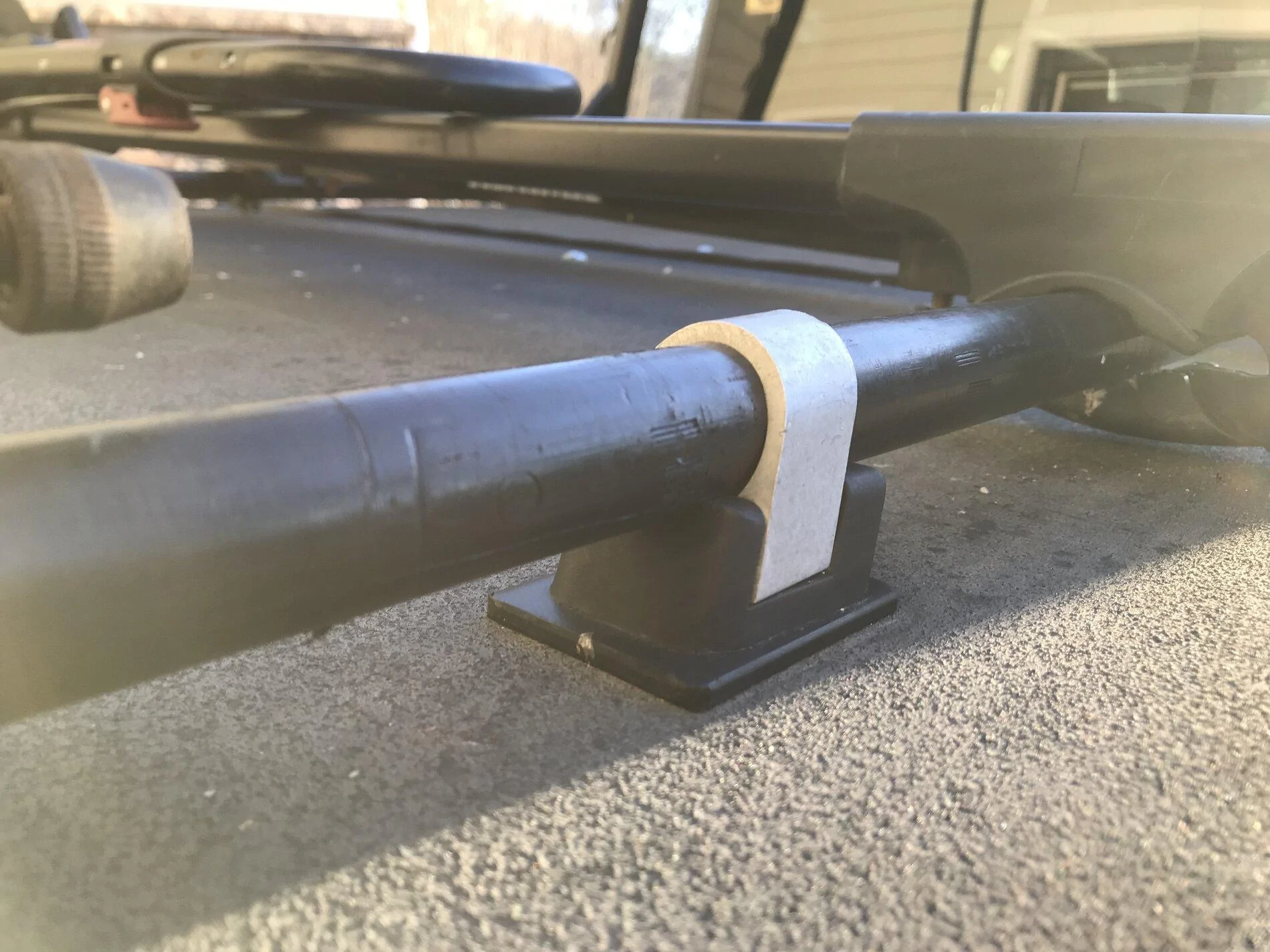

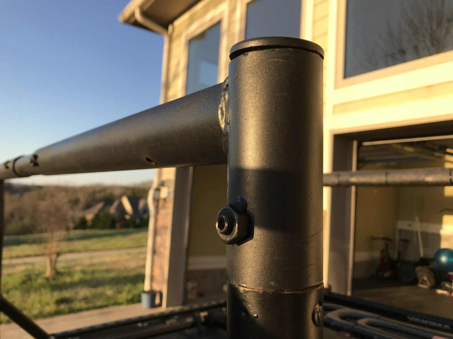

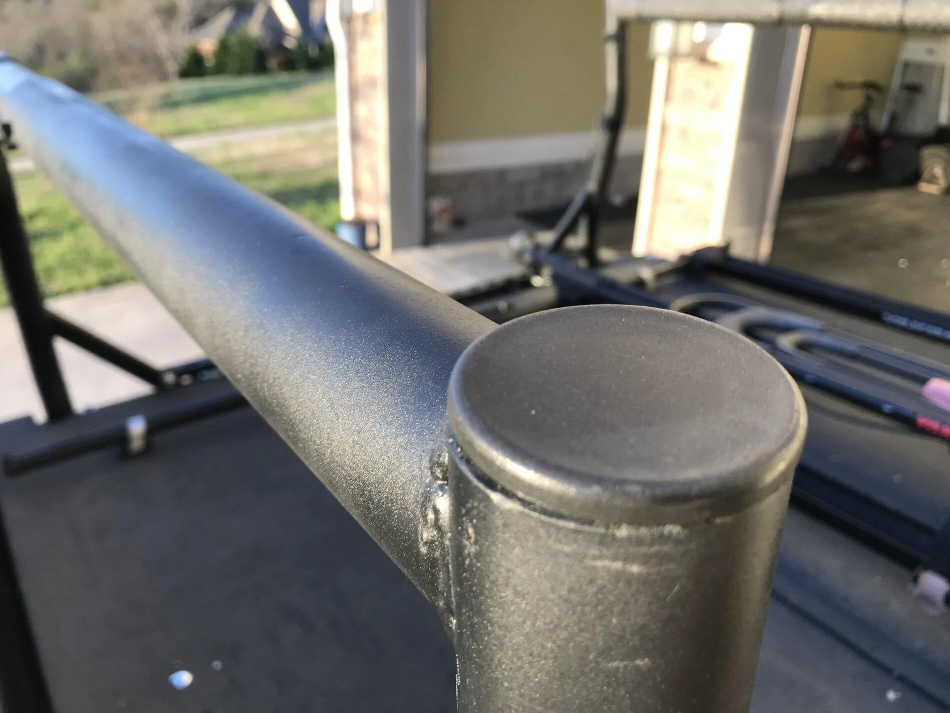

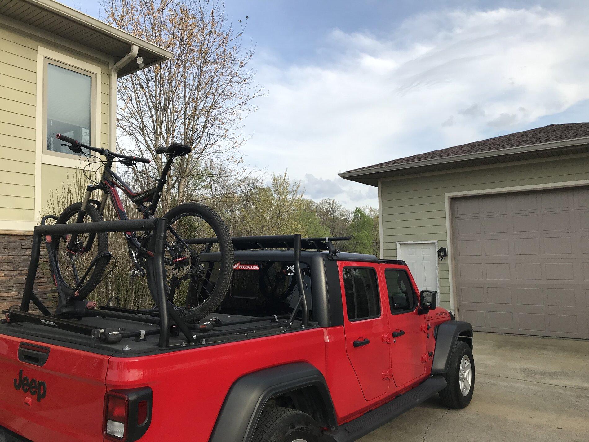

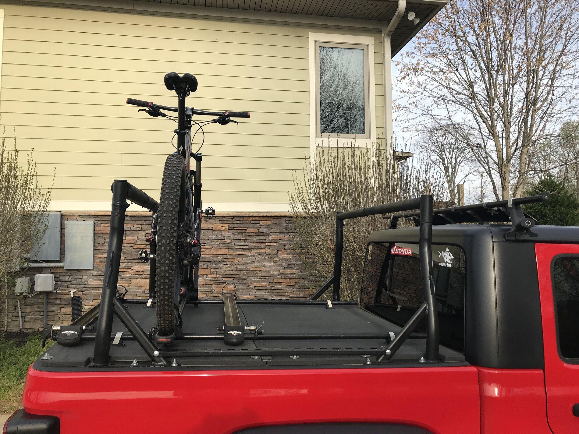

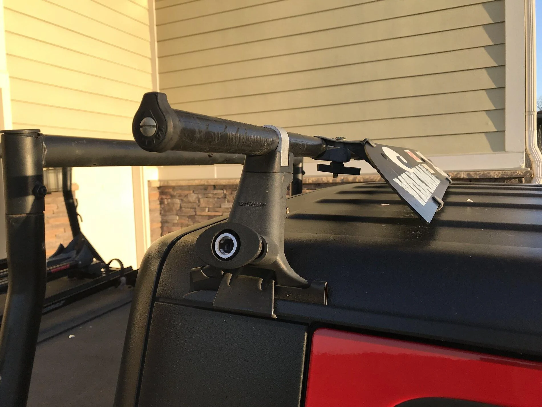

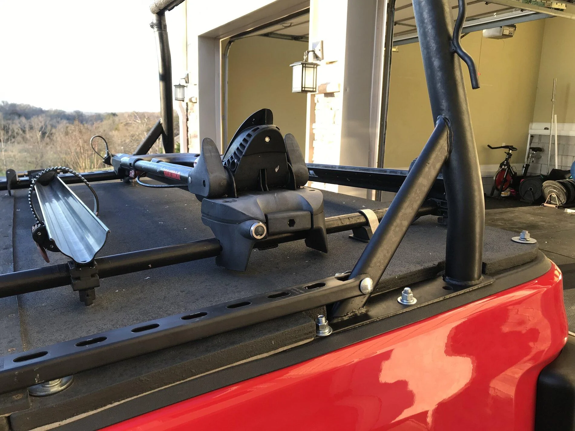

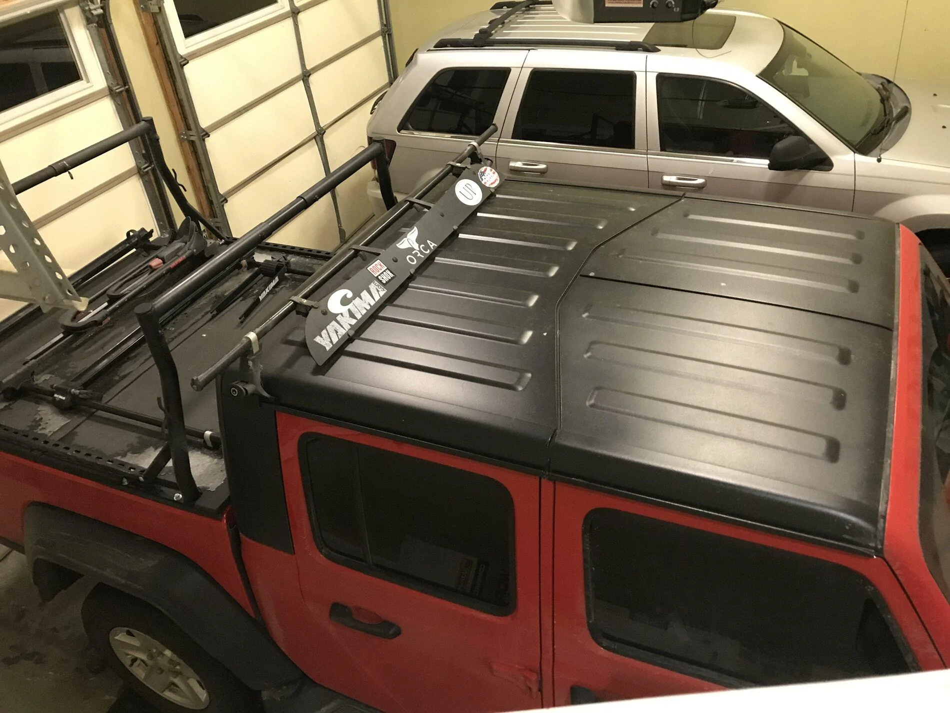

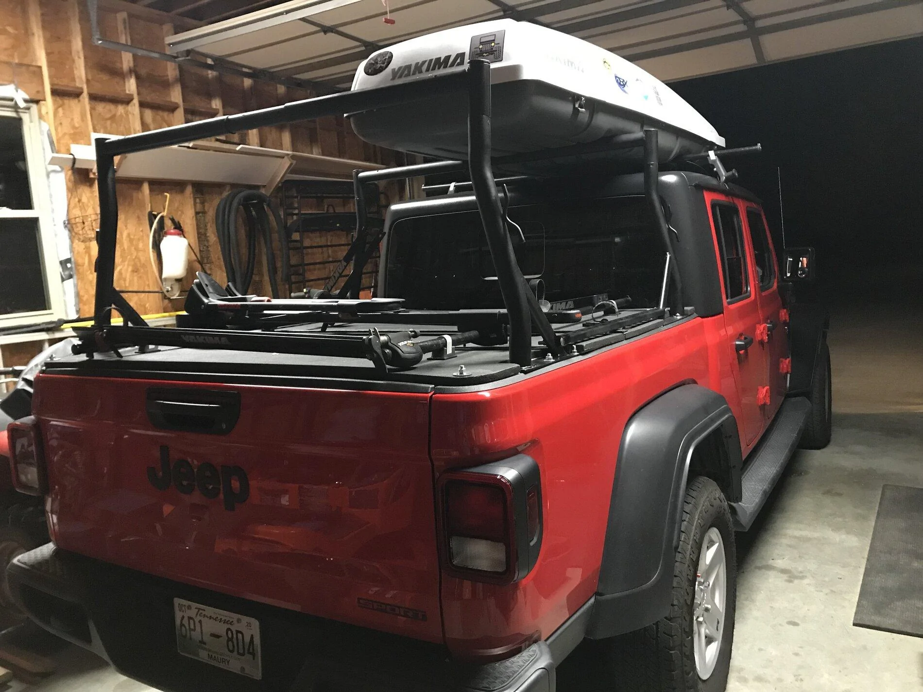

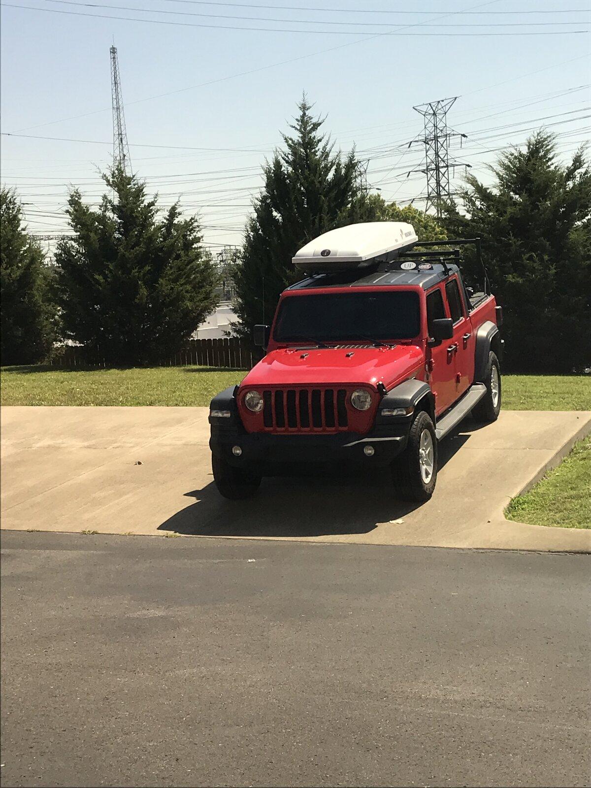

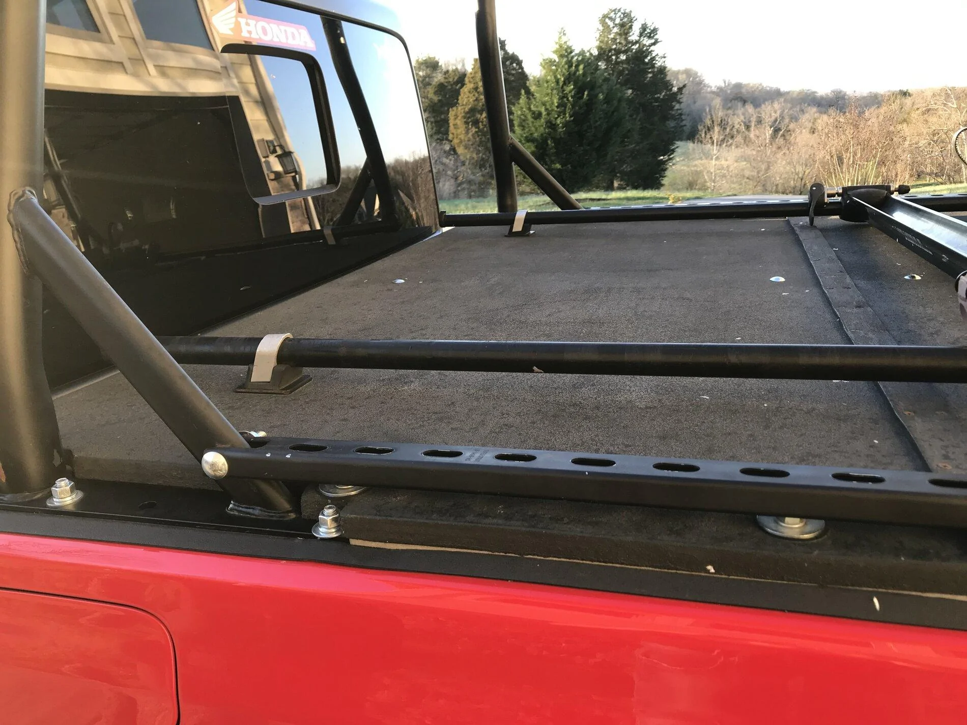

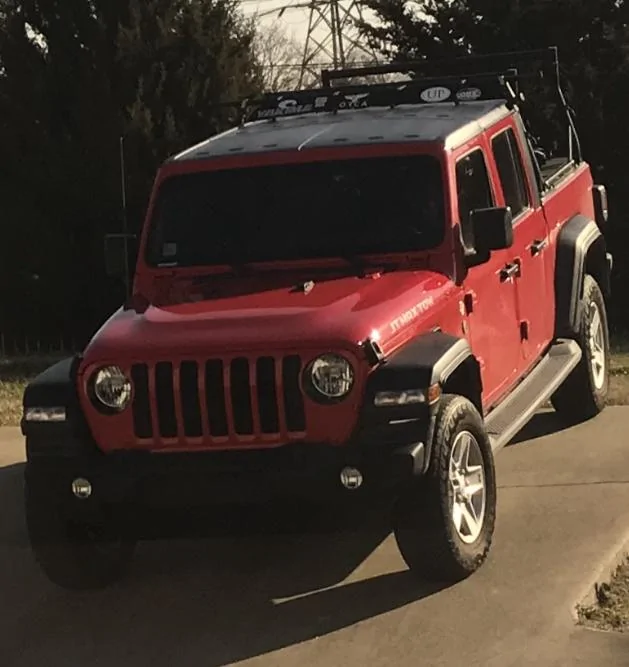

For your kayaks use a ladder rack set up, if you have a hard top (vs a soft top), get on FB marketplace and find Yakima gutter mounts with long load bars. I just use one with a cheap Chinese ladder rack on the bed someone gave to me.
Ladder racks are typically very tall and look awkward IMOP. The advantage of the Chinese rack is the ability to take the cross bars off and cut them down to match the height of the Yakima gutter mount attached to the hard top. I can slide the Yakima load bar forward to just behind the freedom panels for 16-20’ + (no problem with a mast) foot lumber, kayaks and my 7 foot Yakima skybox. I slide the Yakima load bar all the way back when I don’t need it which stops any noise from Yakima bar with freedom panels out.
Another thing to consider is the cold weather group as you live in the north east. You will have heated cloth seats and steering wheel which are awesome!
A tow package like Max Tow and I think standard tow package give you class 4 receiver hitch and heavy duty alternator and battery (again beneficial for your winters).
I can’t Say it enough...? (my friends here on the forum will agree that I am very vocal about the Max Tow package gladiator) the Max Tow is perfect for someone that wants a real mid sized half ton convertible truck. 1600lb bed capacity, 760 lbs of max tongue weight, and 7650 lbs of towing. You also have a rear view camera that has moving lines to back up for trailer hitch hook ups with a zoom feature to make trailer hook ups an easy one person job.
I understand that budget constraints may keep you from upgrading package but I also understand the desire to keep it simple if thatbis your purchase reasoning. BUT, roll down windows and manual door locks are a pain in the ass. A lot of reaching over to unlock or roll windows down, so the Sport S package that has the power group, is worth the price. If you plan on any lighting accessories or air pumps etc order it with the accessories switch panel.
I have $500 total in my Jeep accessories, I paid $42G in October of 2019 for my Max Tow Sport S. You should be able to do better deal with incentives now. The Max Tow With it’s wide track axles, HD Dana 44’s and 4:10 gears is a hoss for a mid size pickup when towing. I know everyone hates on the stock wheels and small tires but they are awesome. Quiet, good fuel mileage, still good traction ( I am not out rock crawling) and you could grab a second set with wheels and TPMS for $2-300 bucks. People throw them away basically. Of course you could upgrade to Rubicon or Mojave takes offs with limited change in the Max Tow’s abilities.

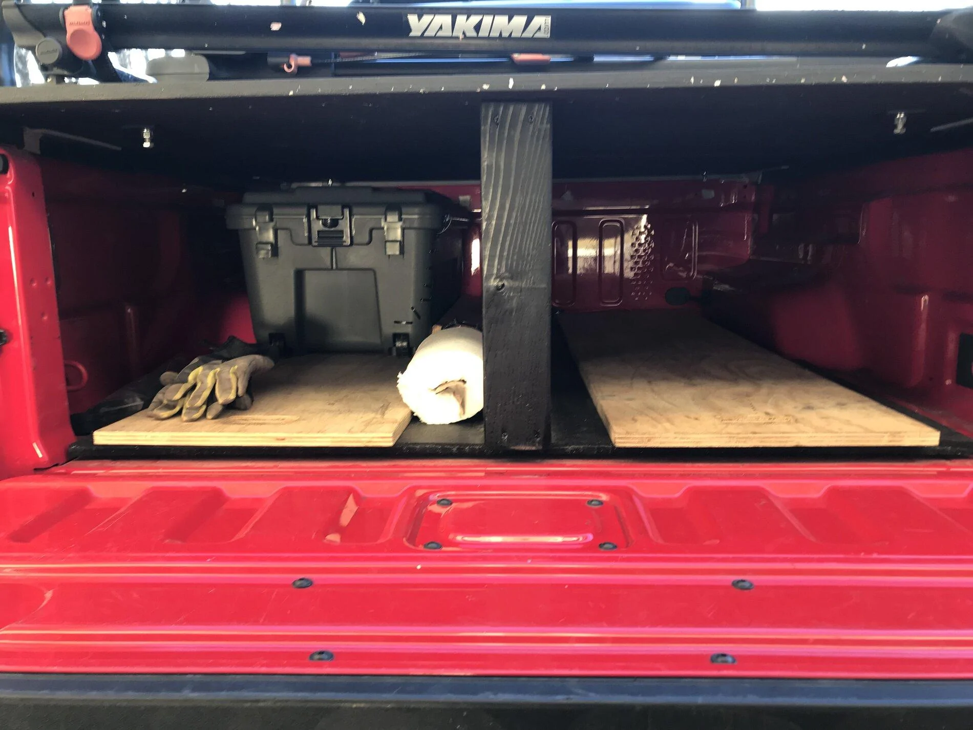

My bed set up is DIY, and I love it, very useful. Only needs a drawer system I will build soon. Everything on the trunk locks with the tailgate power lock. I can carry 4 kayaks, or 2 kayaks with 4 bikes sideways on hard bed cover and Yakima skybox.
