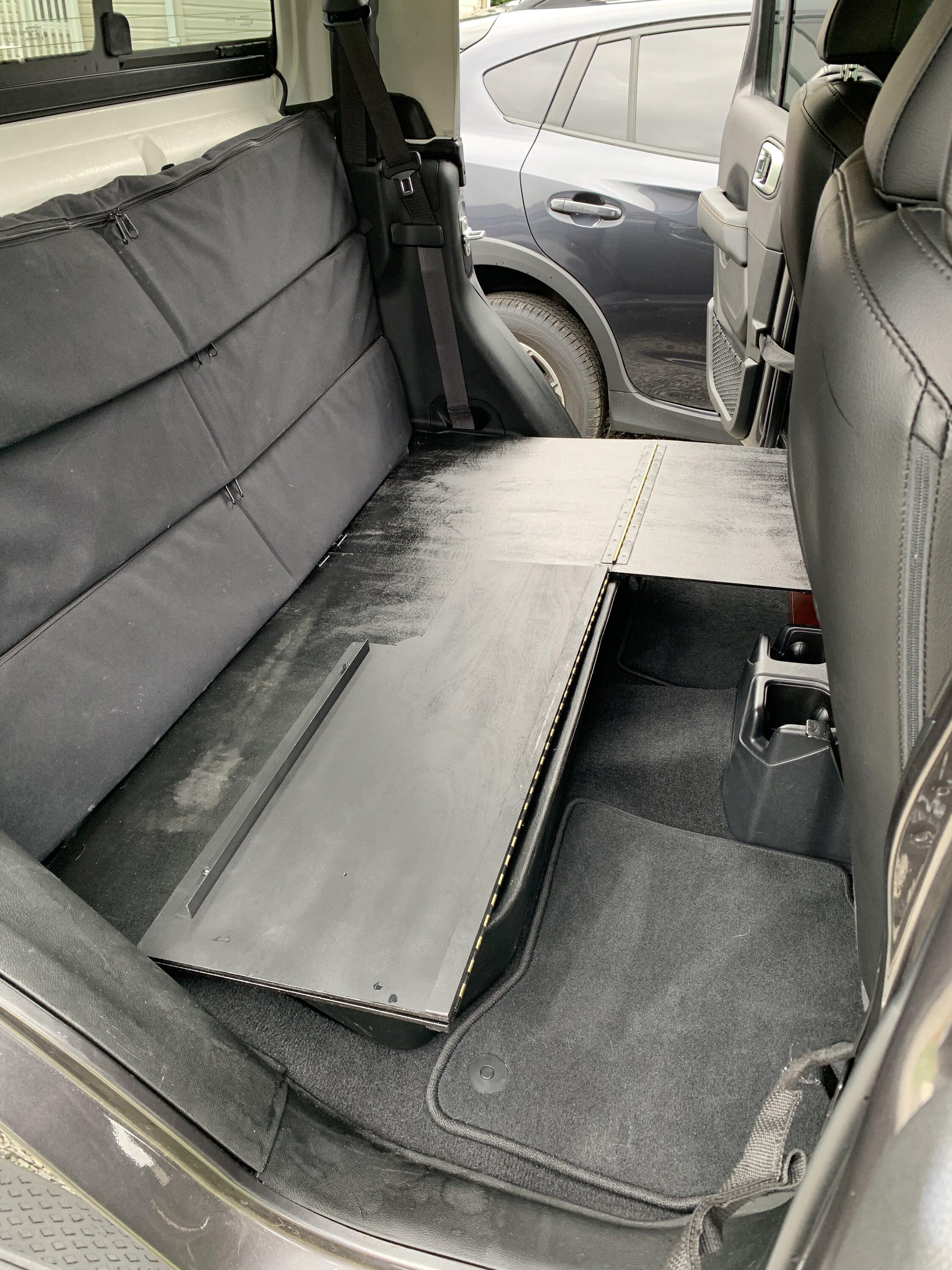

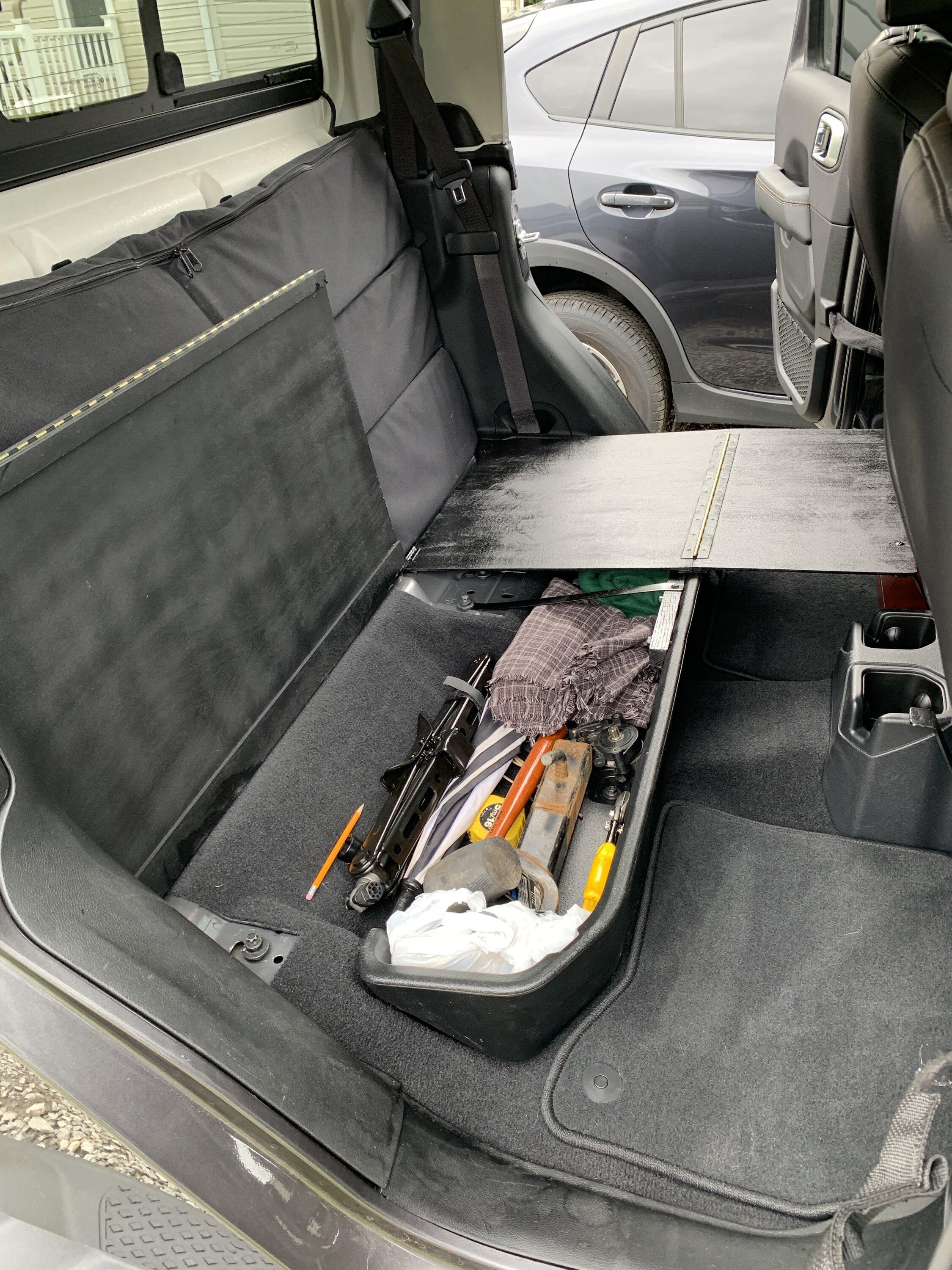

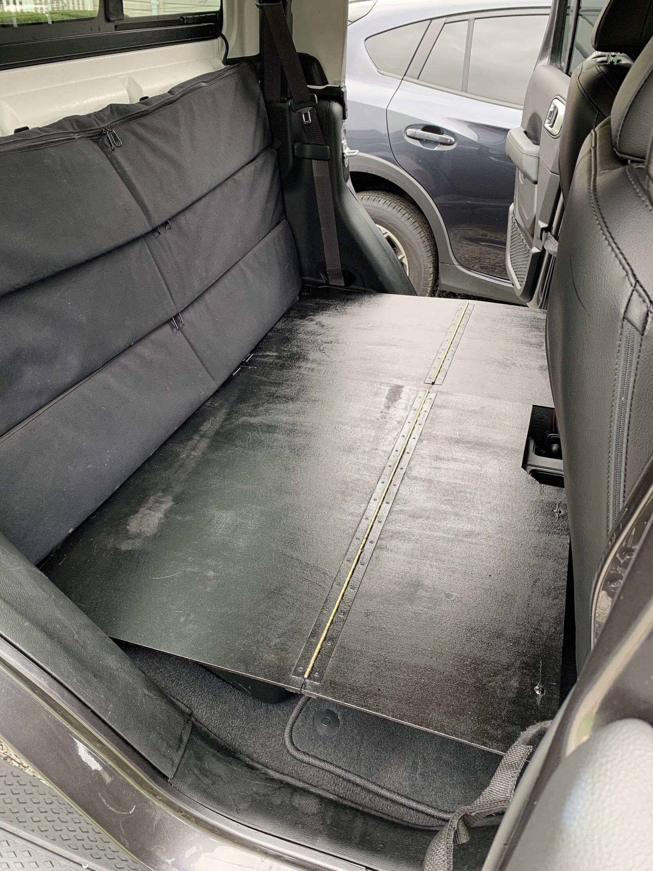

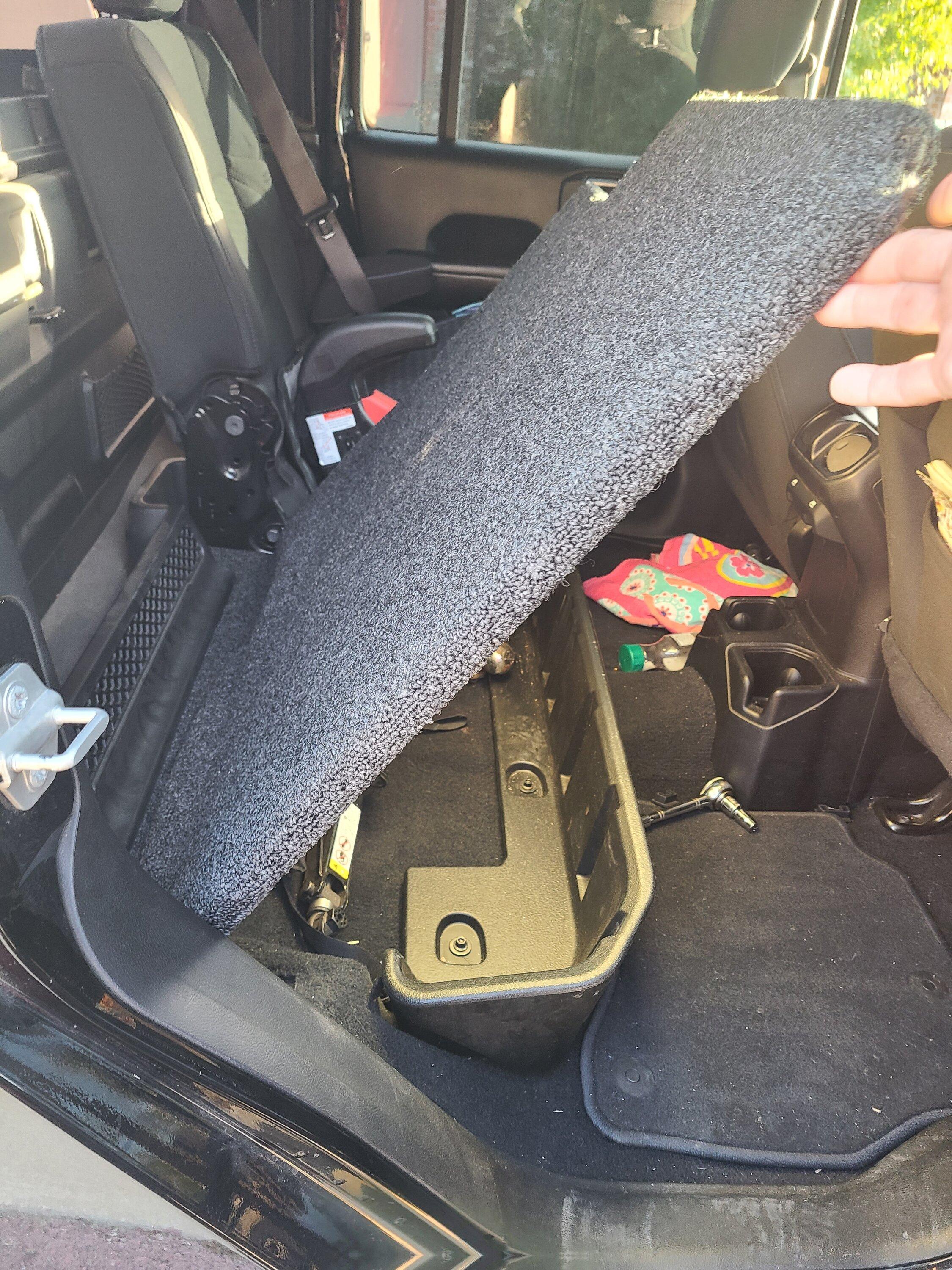

Short background. There are lots of options to do this yourself or purchase one. I am too cheap to pay someone to do something I can for a fraction of the cost (time exclude).
My previous truck had a killer fold out under the seat platform that I used more than the seats so this was my first goal. Second goal was to be light and easily removable and third no crazy welded framework or mounting legs to interfere with storage.
Light weight for dog kennel or hunting gear only was all I am after.

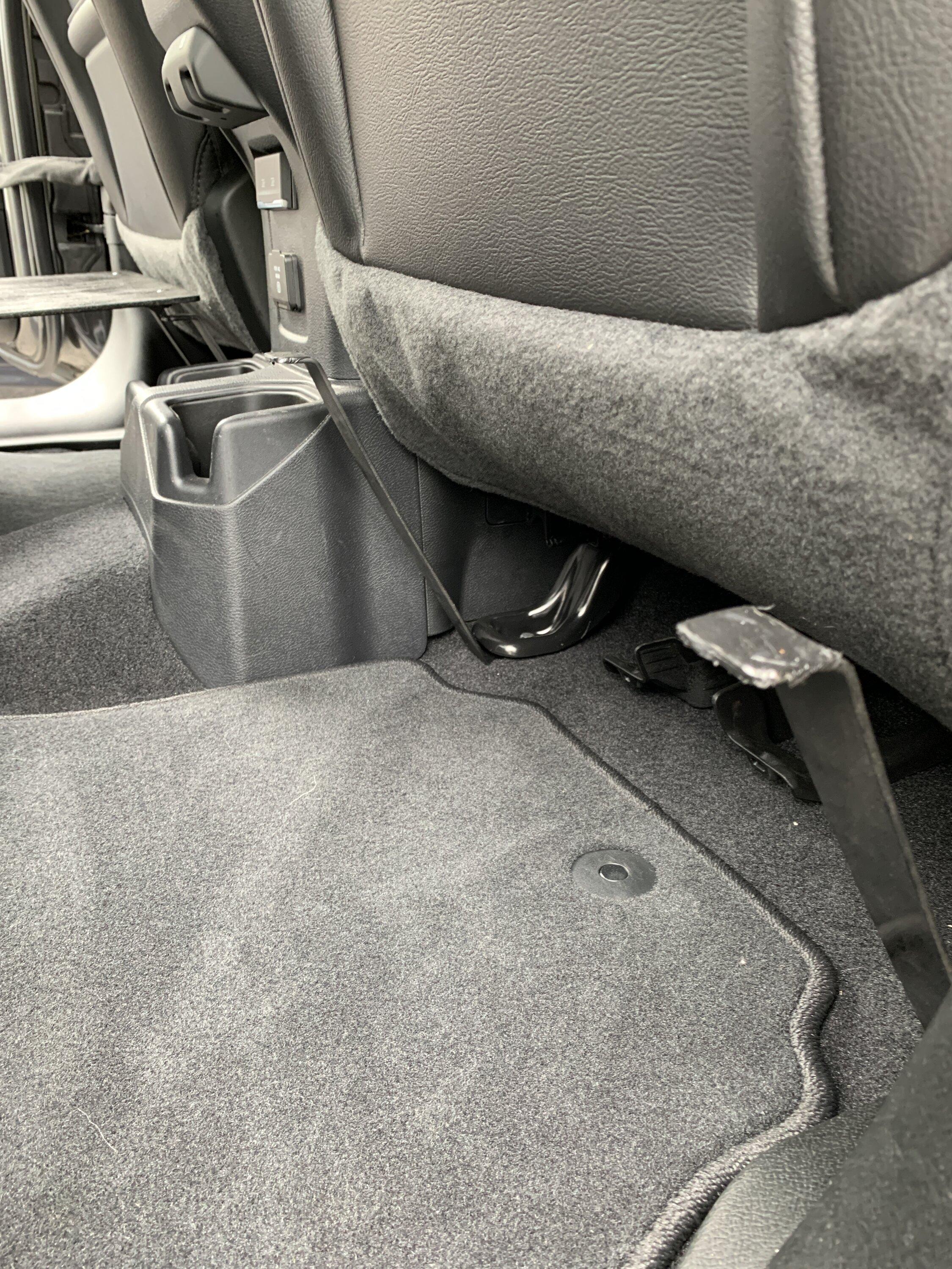

1/8” reinforced plywood with dual hinges to allow access and options for gear placement. I made four brackets to catch the front portion that can remain if the rear seat is reinstalled (making it easier to swap), remove four bolts and lift the platform out, install the seats and 8 bolts back in.
Jeep Gladiator Not another rear seat delete ? F1254EB3-440C-4F92-8C6C-1110442A39D2
Jeep Gladiator Not another rear seat delete ? F0A35329-CDCF-430C-BA4D-82AC95F2FD6F
Jeep Gladiator Not another rear seat delete ? F2B89993-C7BE-4A09-A624-1A16CBA570F3
Jeep Gladiator Not another rear seat delete ? F15FA43A-A5C0-49BC-84D0-0F097674C366

Nice work! What is hanging on the back wall?

You just bend some flat steel for those front brackets? Notice any flex when loaded up?
Love how clean the design is
dutch7
dutch7
Aug 8, 2022
67
120
WPA
'21 Gladiator High Altitude
Thanks, I have had it loaded several times and no noticeable flex or give but I’m sure there is some.

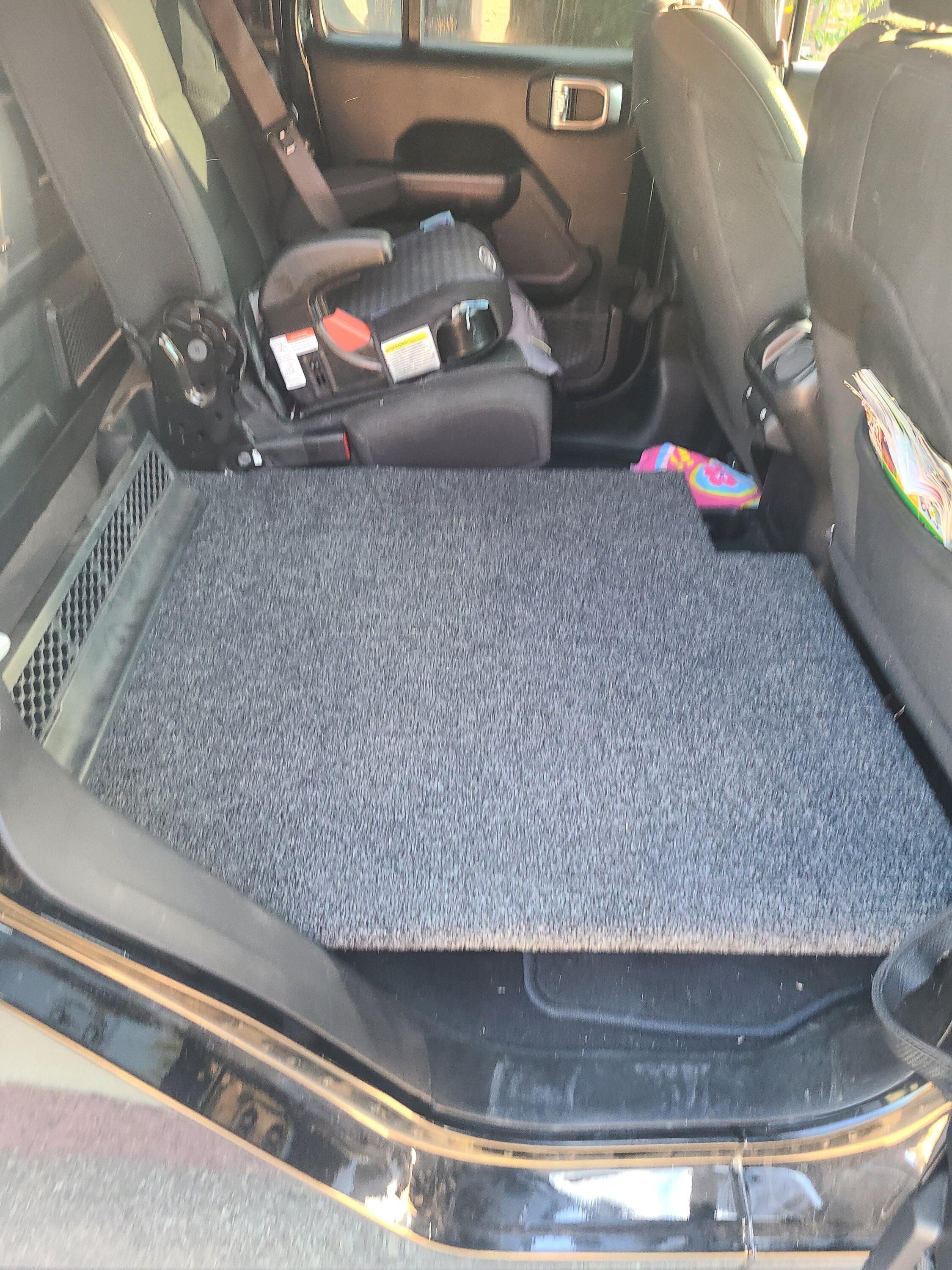

I did a similar thing but only 60%.
Mine goes under the back tray and is secured with the bolts that hold the tray down. I put a hinge just in front of the tray.
Jeep Gladiator Not another rear seat delete ? 20221023_172137
Jeep Gladiator Not another rear seat delete ? 20221023_172147
Jeep Gladiator Not another rear seat delete ? 20221024_072023
