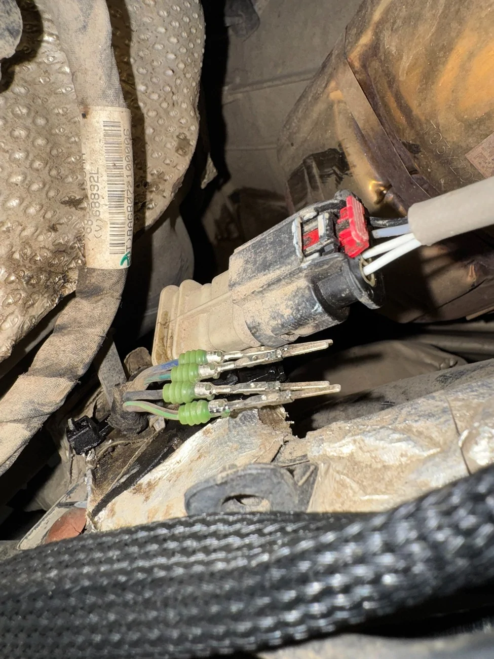

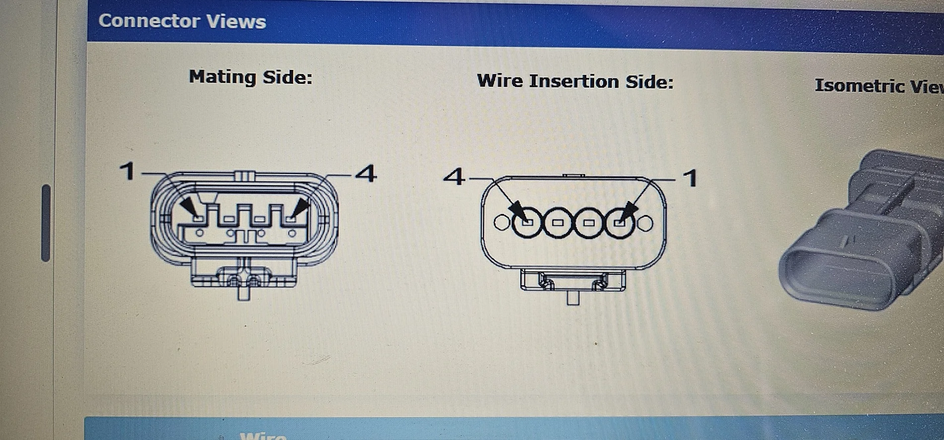

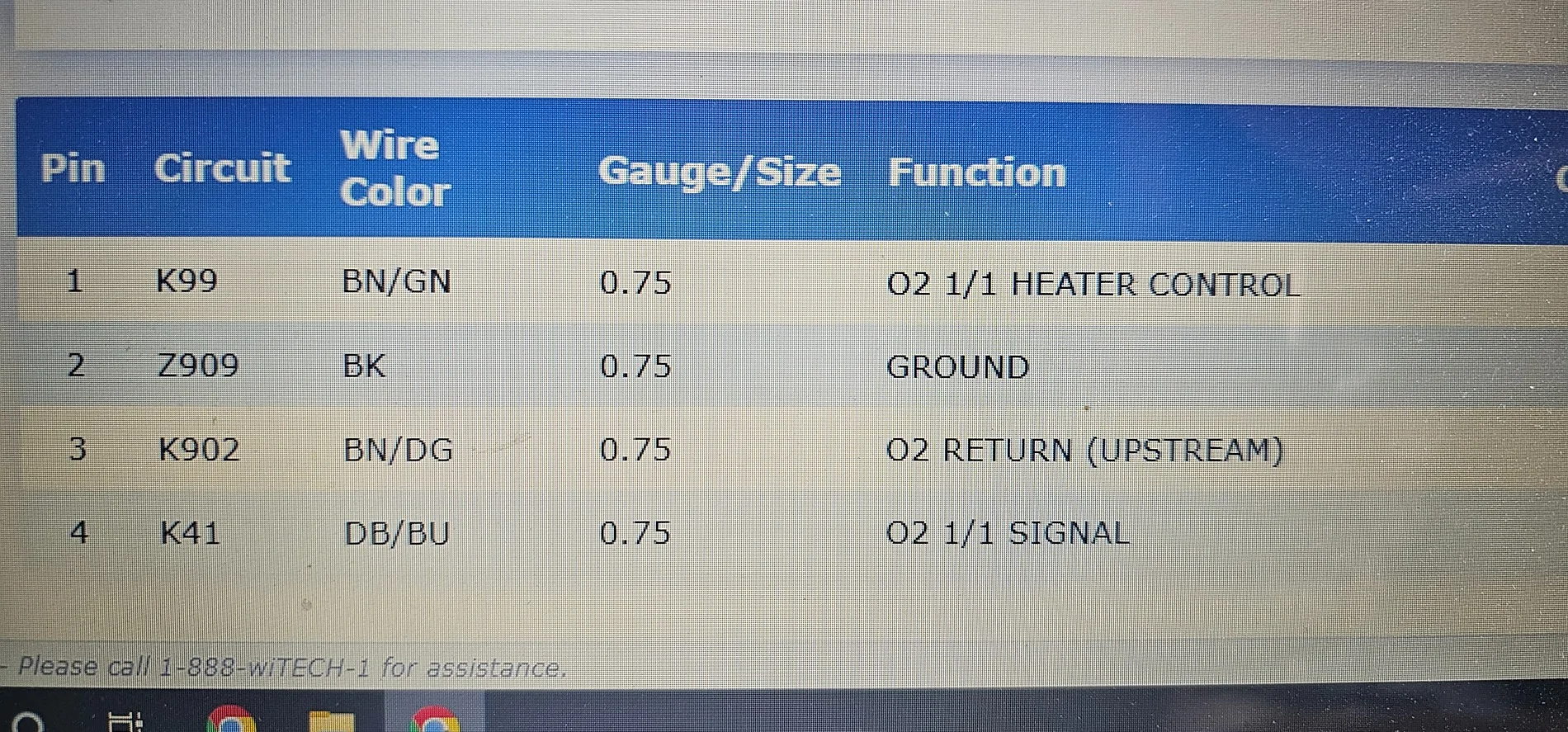

So, i caught a stick out wheeling and it ripped the wires out of the upstream bank 1 O2 sensor. I'm trying to figure out which wires go where into the corresponding O2 sensor wire.

All fixed. P0032 code is cleared.
