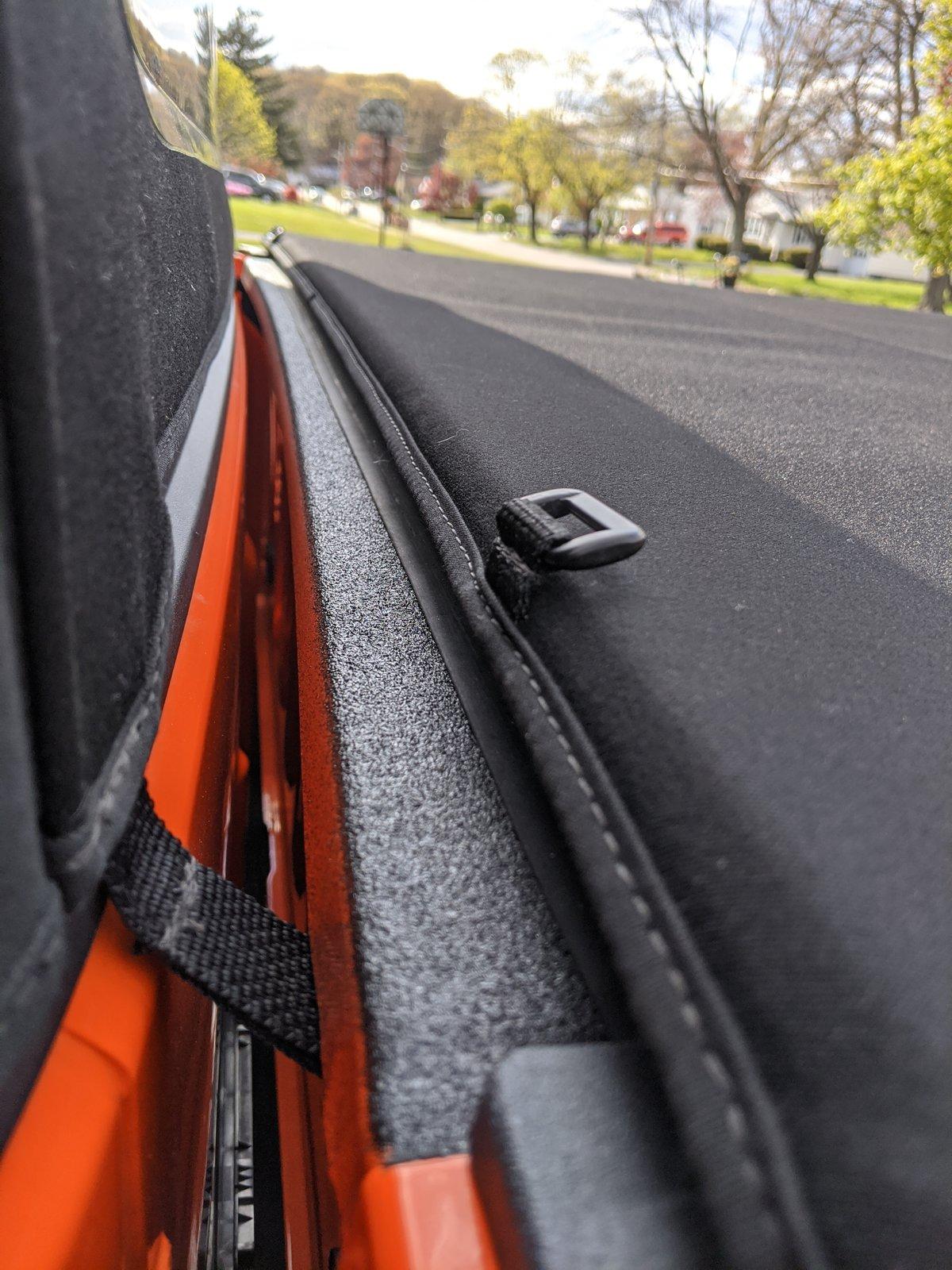

Hey guys. I just got my tonneau in today from a forum member. I installed it but had a couple of questions. Per the title, it’s the MOPAR Soft Rolling cover.
1). I had the truck bed Line Xd prior, and the threaded holes weren’t clear. I tried working a bolt in and out to loosen it up, as well as cleaning it out with a flathead. By the end I was using pliers to grip the bolt head and rotate it. No torque wrench, but it’s pretty snug. Thoughts?

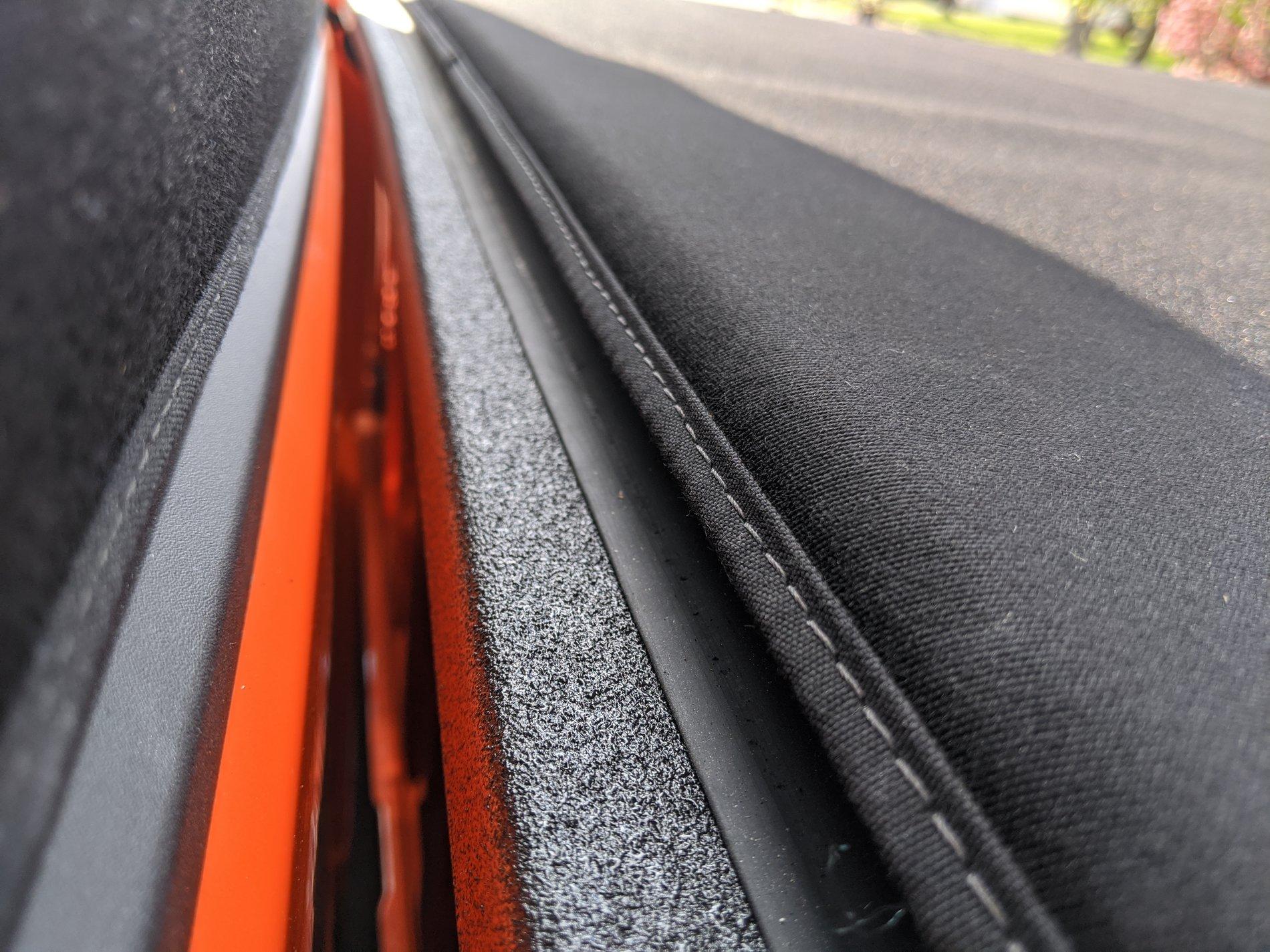

2). How does the front seal seat? Is the seal supposed to lay a small flap over the front of the bed facing the back window, or is it meant to be tucked and have that flap towards the back of the truck?

You need to use a tap or thread chaser to clean the holes. Not a bolt!
I noticed mine doesn't seal as well up front since the bed liner was sprayed

Yeah, it seems I did get lucky. As long as I don’t damage the truck, I’m fine.
I took it back off and it seems that the seal wants to tuck in towards the bed. Must be the right way.

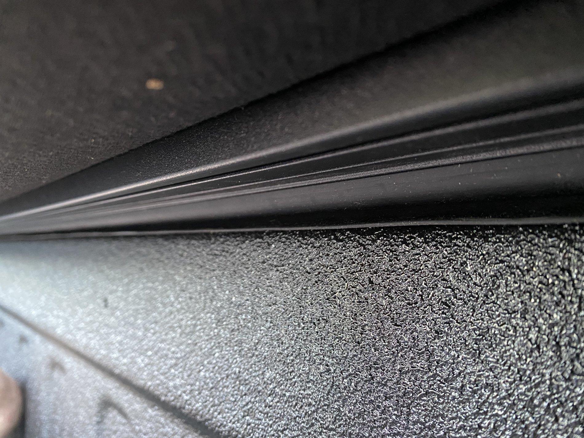

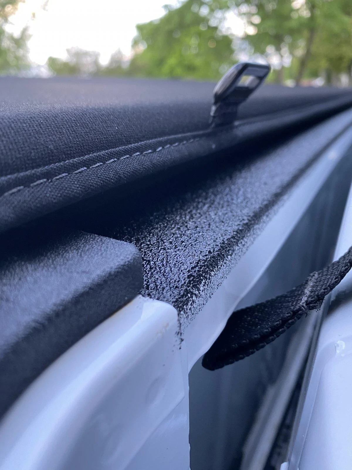

I got a chance to check my cover today, the seal was rolled under like yours...I was easily able to set it on the out side just using a trim tool(anything flat that won't cut the rubber would work)
I don't know which way is right but I'll try this and see if it still leaks

Any more water getting in? I flipped mine as well and since then, no water has gotten it through some really good rains.

I forgot to update, sorry!!
No more water and I also had some heavy rains up here!
