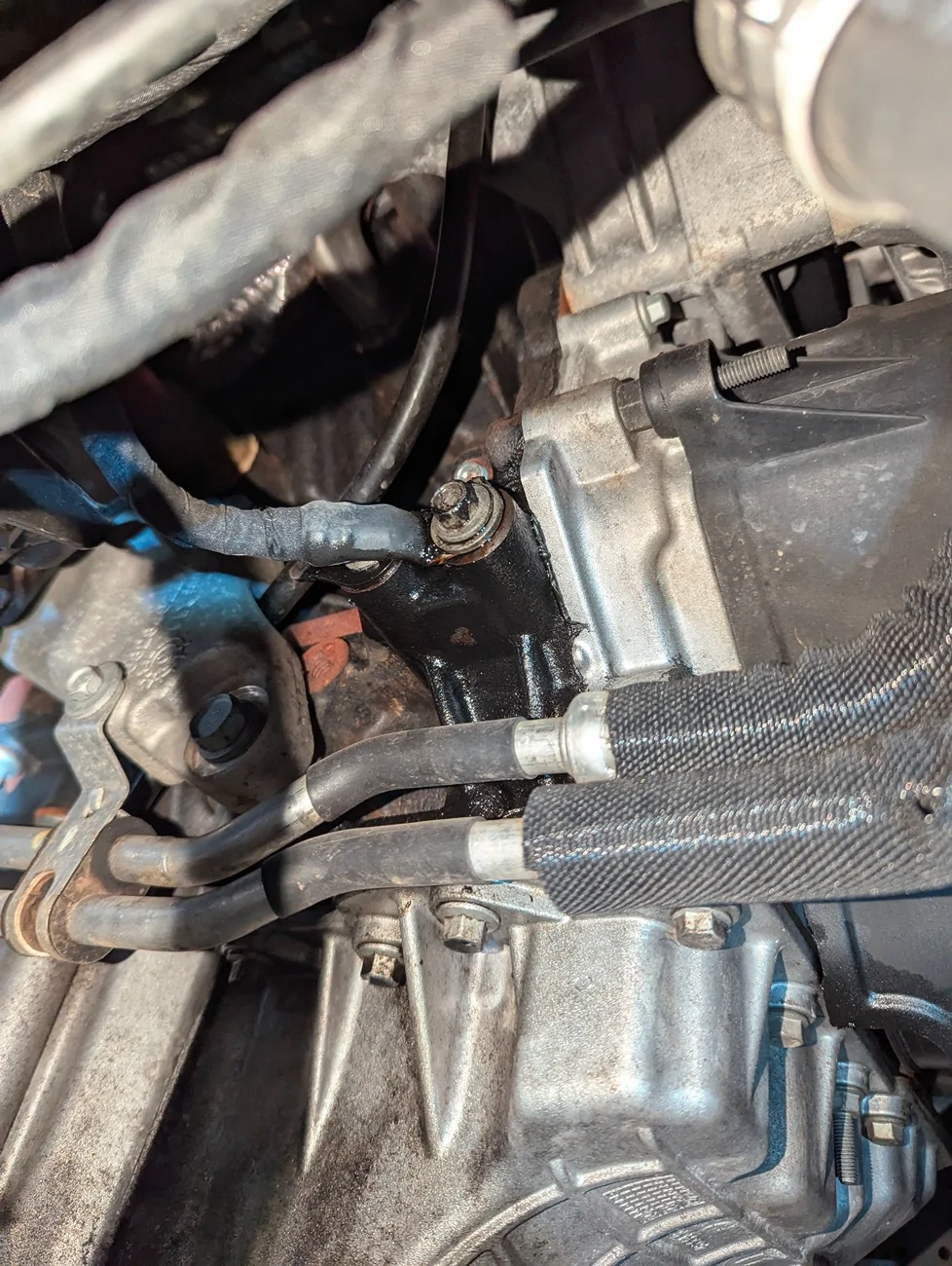

Oil leak at block near engine ground? Anyone have similar? What was the repair?

That's typical of an oil cooler leak. I'm assuming this is a 3.6. If you can get your head in there, you would see oil in the valley under the intake manifold.

It’s probably is the oil cooler. Don’t replace it with an OEM plastic one. There are a couple companies that make aluminum replacements. While you’re replacing it be sure to service plugs and anything else in there that is nearing its life span. As its significant labor to get in there.
