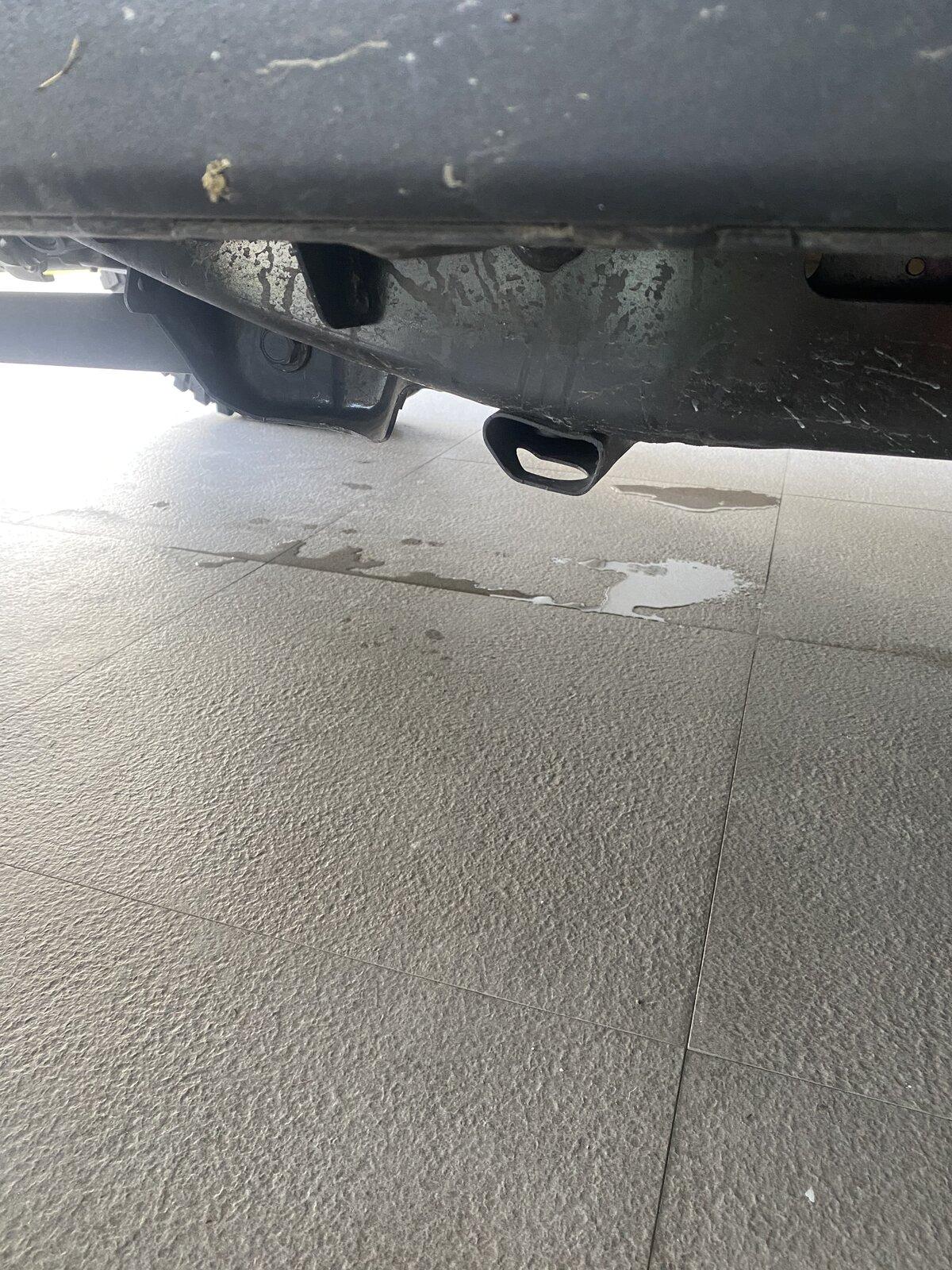

What is this liquid leak, it was leaking straight from the dealer

It was leaking straight from the dealership, forgot to ask them because too exited for the car. Hope its nothing serious, liquid looks clear like water

When it is hot and humid and the AC I'd on if you lay up under the truck look at the floor board of the truck you will see a plastic drain slender and rectangle it is a drain for AC it is more than likely water and it will drip down and run right on the back of the transmission. Did it to me once scared me till I got under it with a flashlight let the AC cranked up and could watch the water dripping out

Exhaust condensation. Mufflers have drain holes. Weird.
