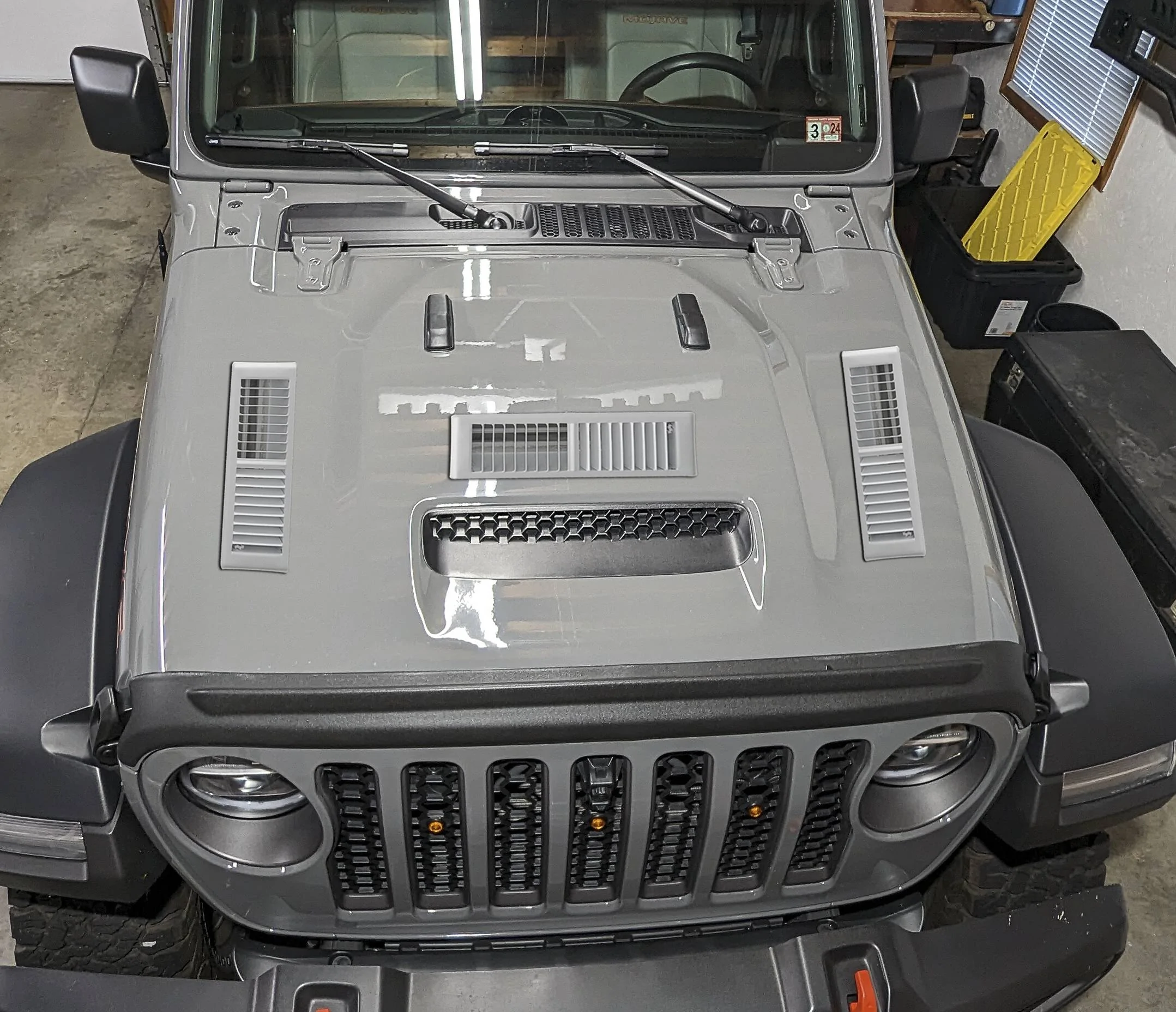

It's probably the Low Pressure System in the engine bay created by my awesome hood vents.
The freaking Weather Channel wanted to give it a name the other day.
For the luxury level of Jeep, you can get those in oak.
Looks like a Grenadier with those sick vents, home depot?
