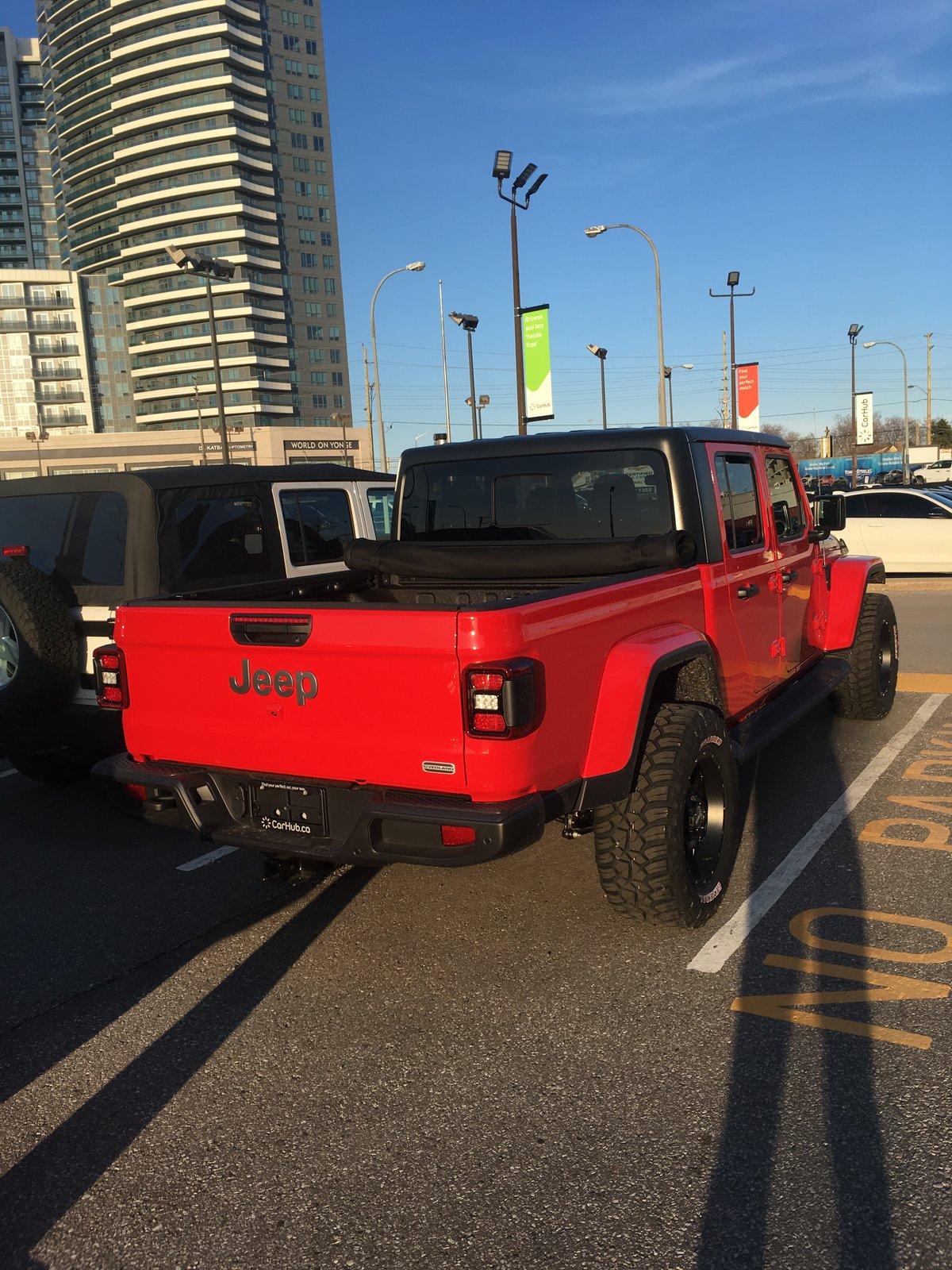

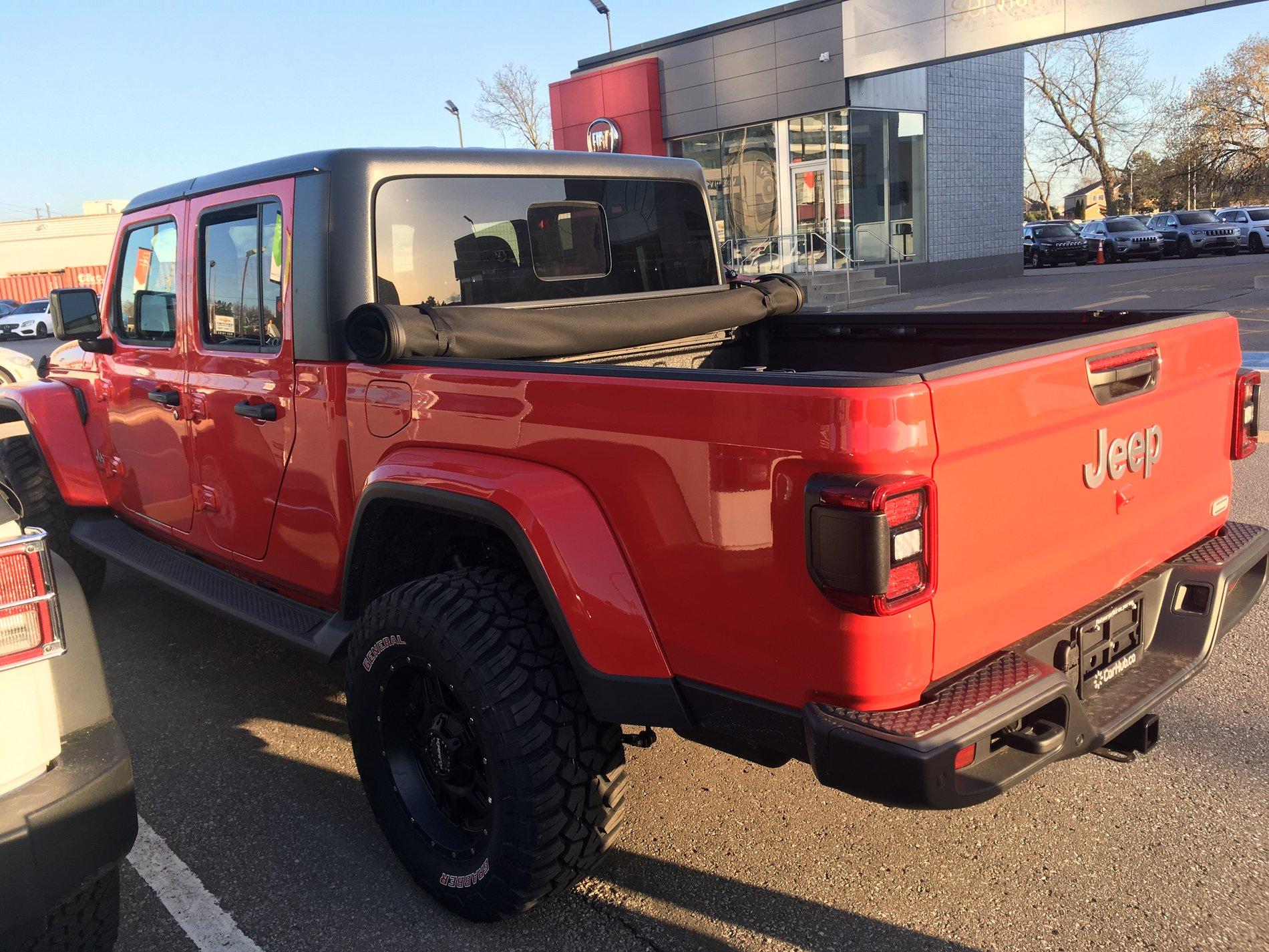

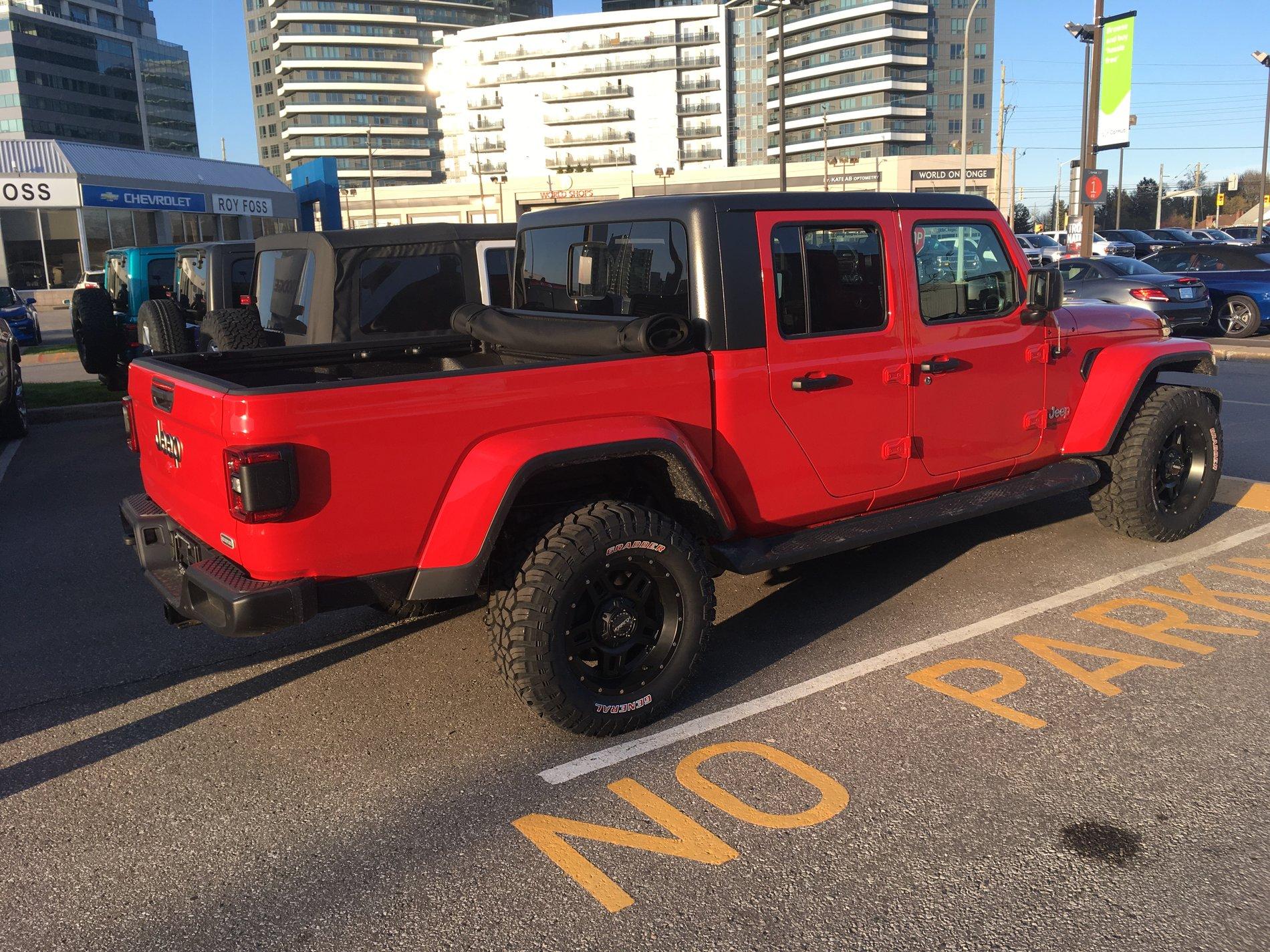

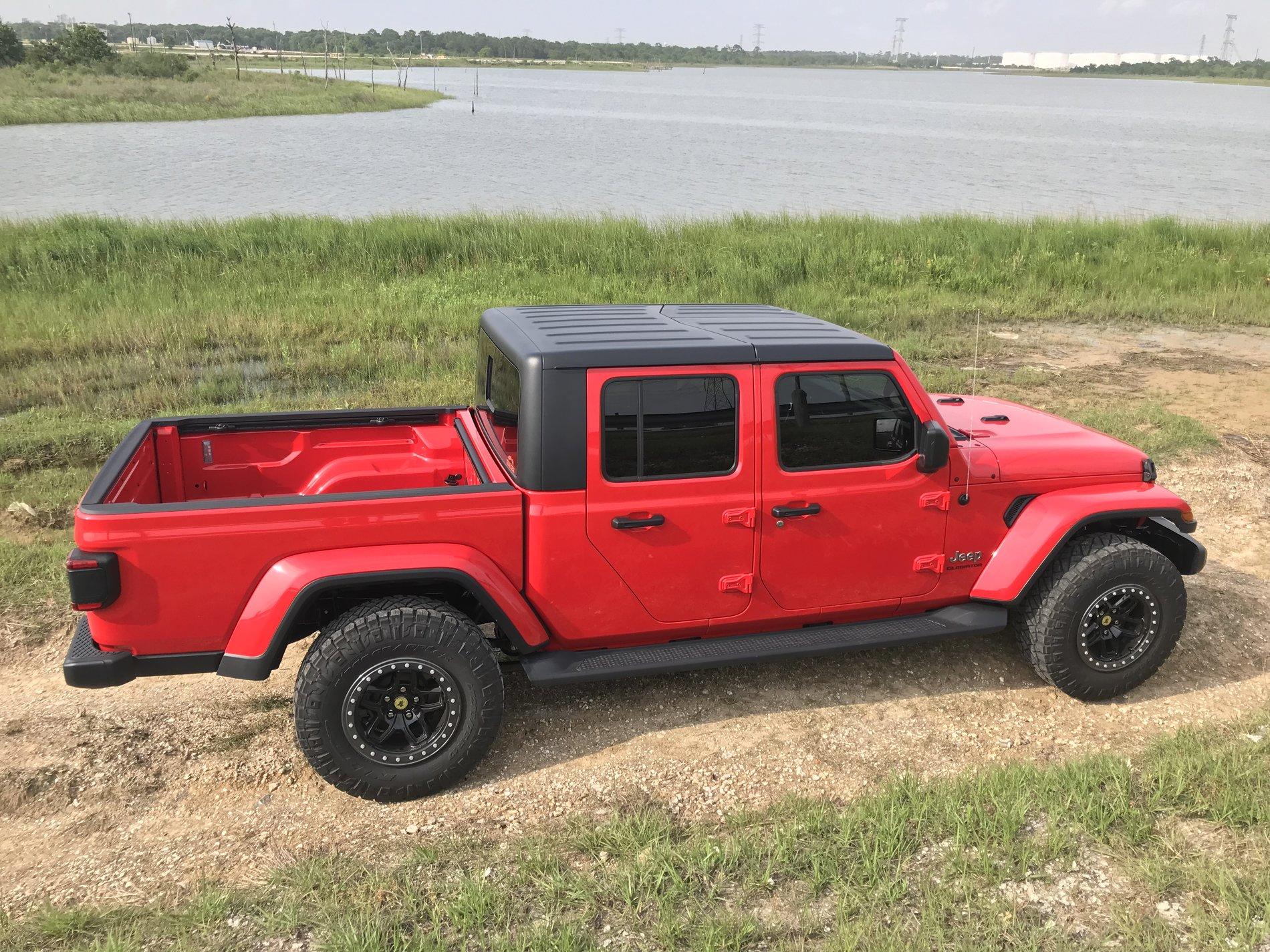

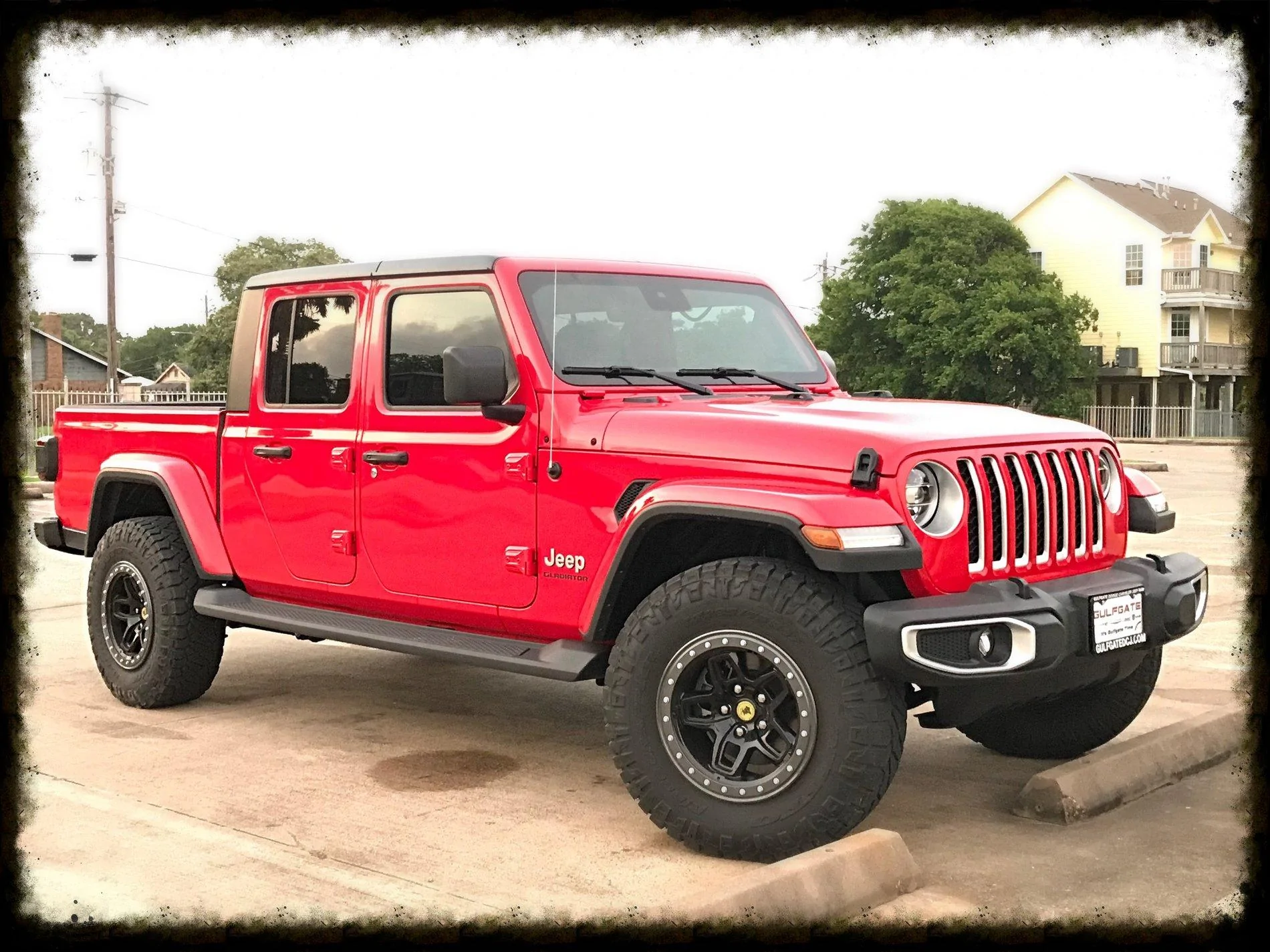

Not heard much about that ATP version. I actually like to sidewall of the AT3 XLTs. Looks good though and good to get another visual of that exact size in comparison.
I’ve heard Cooper in general are much more quieter especially the XLTs than BFG K02s which I was also considering. Regardless I’ll probably recalibrate the odometer with a taser soon after.
The ATPs are a Discount Tire exclusive, basically the XLTs with a different cosmetic sidewall. The tread is almost identical. I did quite a bit of research before buying and the Cooper reviews almost all said how quiet they were for an AT, so I took the chance and I am not disappointed. Overall I'm very happy with the Coopers and I would buy again.

Bro you and I need to talk more. lol. That's the set up/look I'm going for. I'm assuming your suspension is still stock correct? If so any rubbing issues? Do you plan on doing anything to the suspension if so?
I'm looking at the same set up but don't want to anything suspension wise other maybe a leveling kit. And even that would be more for aesthetics than function.
Yes, suspension is all stock and no rubbing issues. I'm gonna go with a leveling kit next - I prefer the look of a level truck and do not tow much.

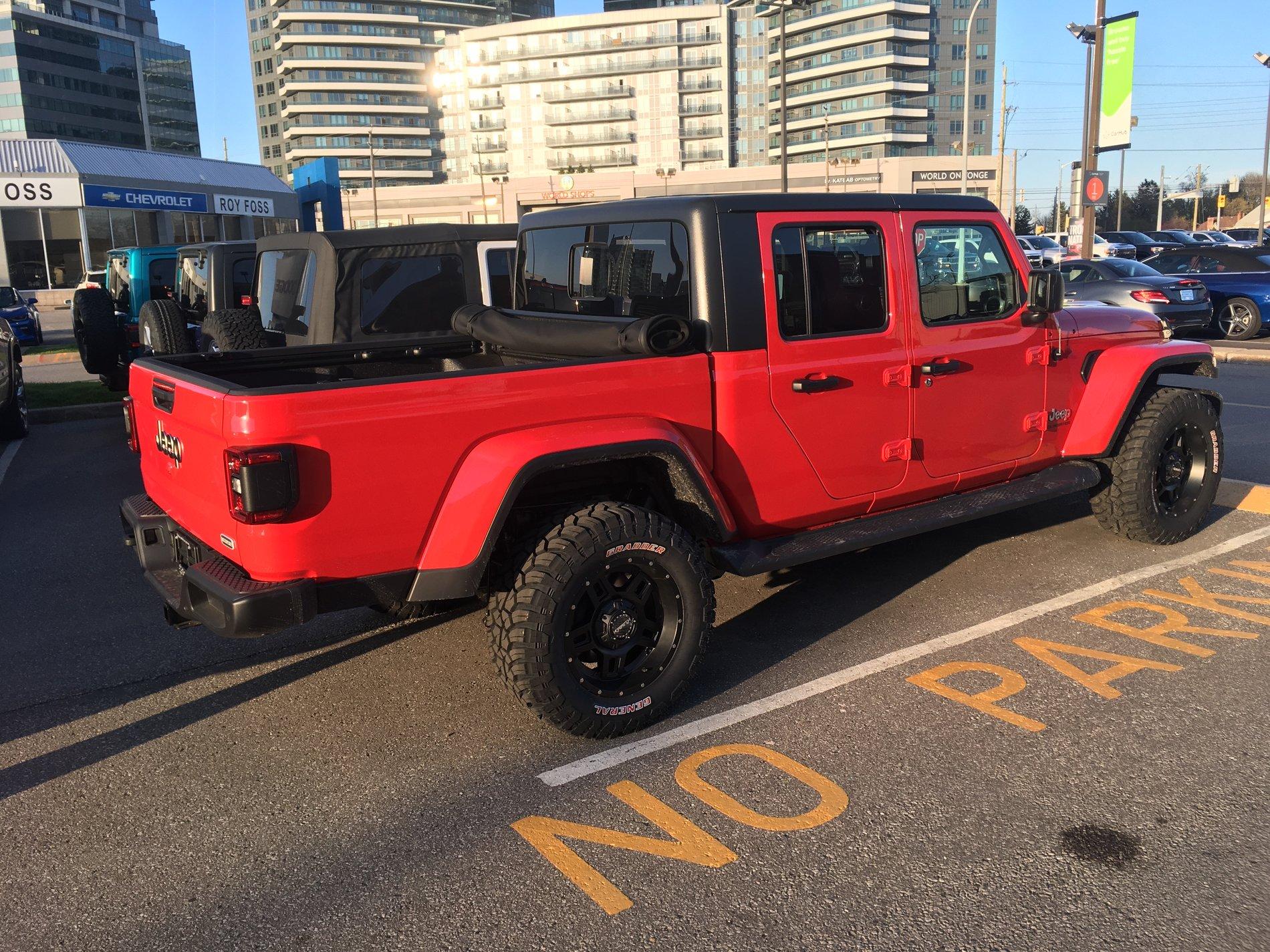

I installed 275/70R18 Cooper ATPs on my stock Overland not long after I got it and I'm very happy as I reported earlier in this thread. It's been about a year and half since and about 12k miles and I'm still very happy with them. The only thing I've done different since I first posted is I've added the Rubicon springs and shocks. I didn't need to though as the 33"s cleared just fine on the stock suspension and I even wheeled with them on several trails.

I didn't notice any performance difference. I did recalibrate the speedo using my JScan app as it was off about 3mph at 70mph. It also wasn't shifting into 8th gear as often as before at highway speeds. The recalibration fixed both. I did notice a loss in fuel mileage though. I was averaging around 22mpg before with the stock Duelers and I'm now around 18mpg since even with the recalibration. Although I only was stock for about 1k miles/1 month before I replaced the tires so probably not the most realistic mileage either before.

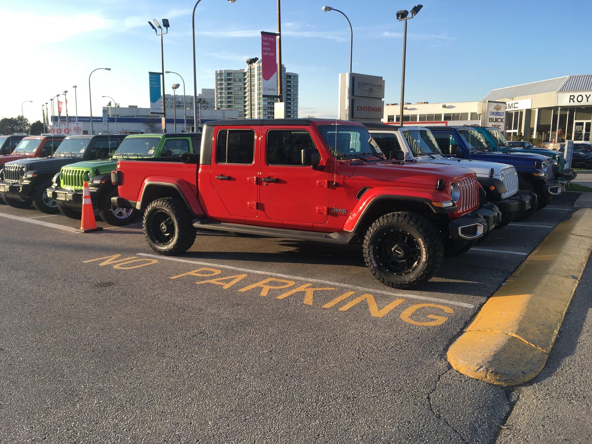

I have a 2022 stock Overland with the street tires. I have two options that I am considering:
1. Rubicon takeoff tires and wheels with a Tereflex 1.5" level kit.
2. Go to a 265/70/18 with Falcon Wildpeak A/T3W.
Any experience or advice on these options?
