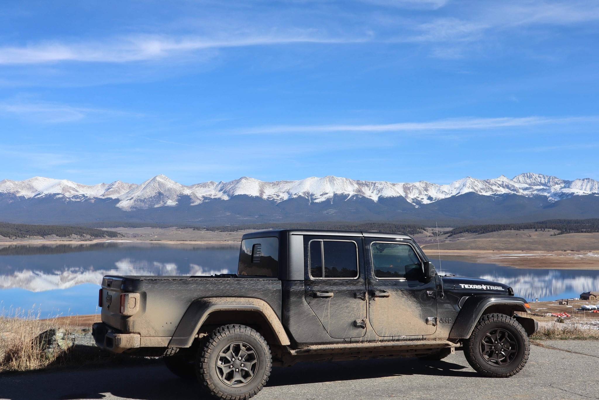

You won't need a lift to run that size. If you want a little more clearance, you can go with a leveling kit with shock relocation brackets, keep your factory control arms, and add swaybar disconnects. I wheeled like this for a while, and it did quite well for forest service roads. I installed a good engine/transmission skid plate and some rock rails and used them. I also have a TJ and if you wheel the JT, you will find it needs quite a bit more clearance due to its size. If you are simply tooling down forest or ranch roads, it will perform quite well and comfortably this way. I did miles in the rocky mountains and was pretty happy.
