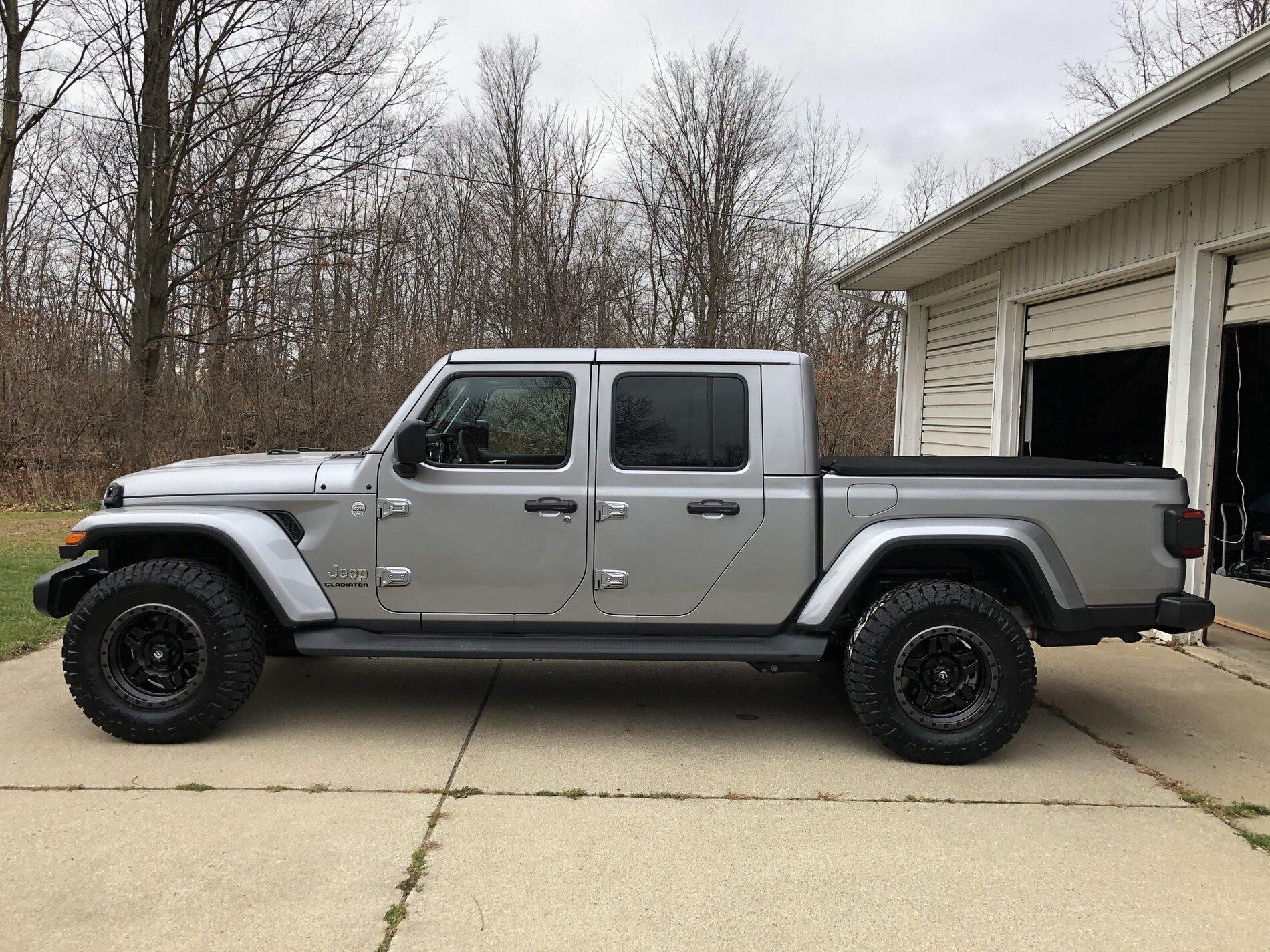

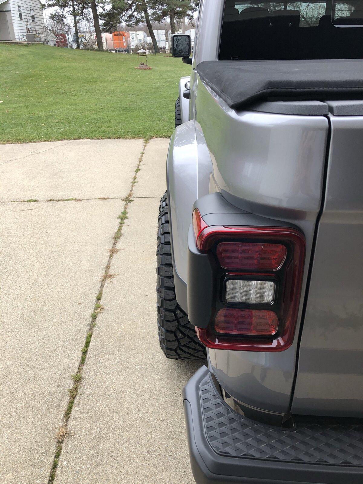

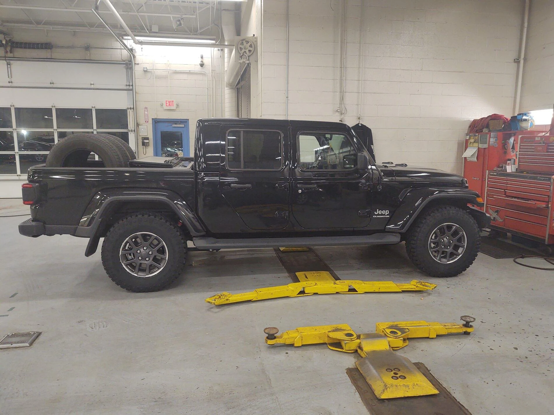

285 75 18 Goodyear Wrangler Duratrac. Rubicon shocks and springs. Need to add a leveling kit. Sits 1.5 inches lower in the front. Tires are pretty quiet. A little hum noise on the highway. Have not had a chance to recalibrate the speedo yet. Speedo reads 60 mph GPS will bounce between 63&64. Doesn't take much of a hill for it to shift down from 8th to 7th gear. Fuel mileage dropped by about 2 mpg. I'll report back after I get the speedo recalibrated. Just a note I got the updated steering gear installed before I changed the tires or suspension.

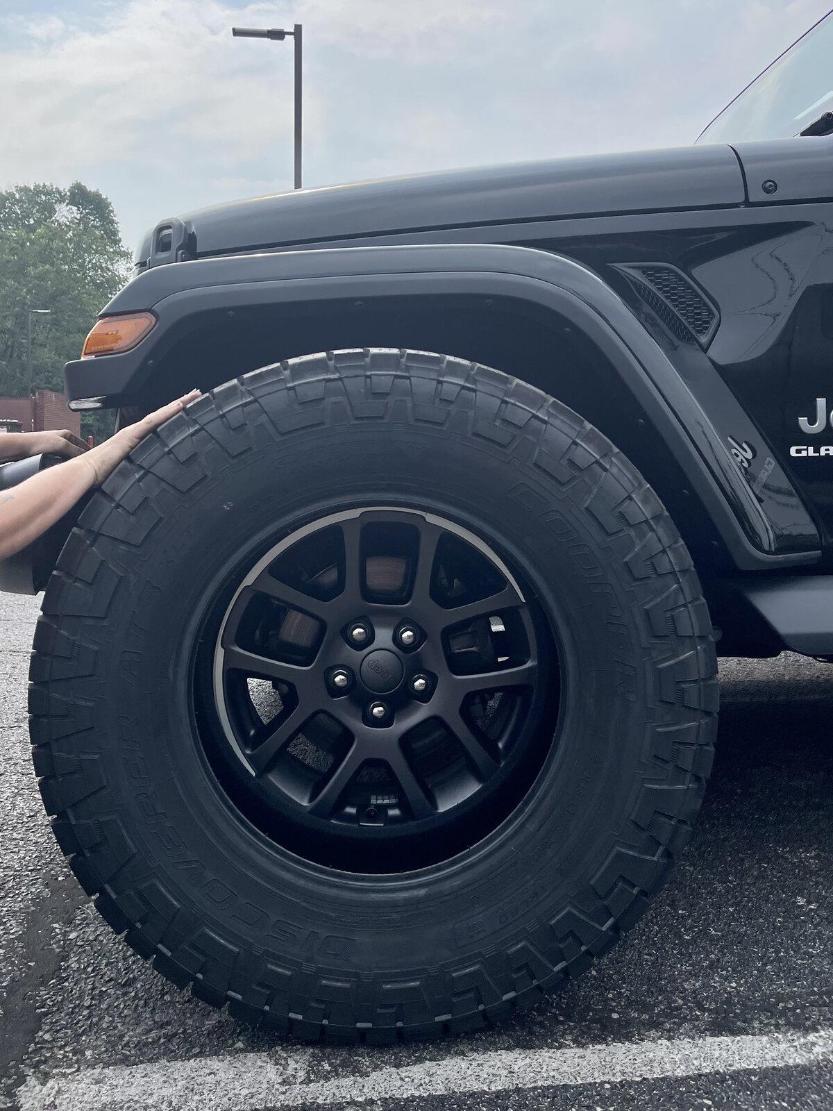

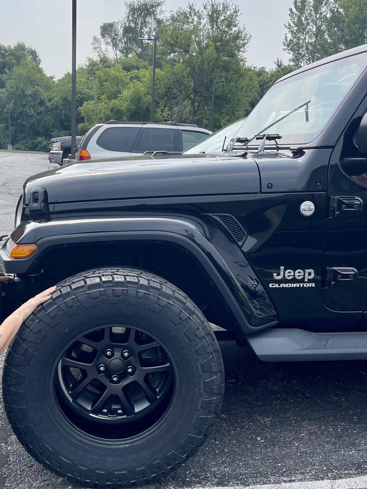

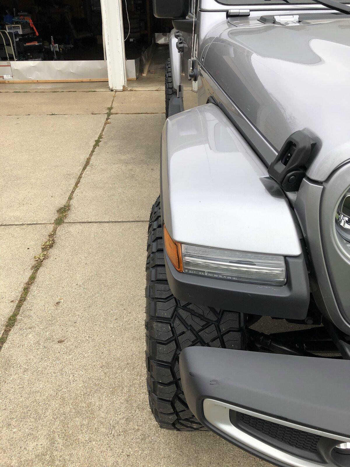

Been reading this forum a while trying to decide on wheel and tire combo for my Overland with stock suspension, thought I would post pics now that I have made the purchase.
Nitto Ridge Grappler 285/70 R17
Fuel Anza 17x8.5 +6

Blwhitfield07
Brecken
Jan 1, 2021
Estero, FL
Jeep Gladiator
Fuel Anza 17x8.5 +6
How is the road noise with the NItto's? Have heard mixed things. Thanks!

paulsoncall
Paul
Jul 7, 2021
Rhode Island
Gladiator Overland
What PSI do you run those? I just picked up the same.
Sarge502
Jul 3, 2021
46
1,313
2,484
Kentucky
2020 Jeep Gladiator Overland
Thin Blue Line
Fuel Anza 17x8.5 +6
Bro you and I need to talk more. lol. That's the set up/look I'm going for. I'm assuming your suspension is still stock correct? If so any rubbing issues? Do you plan on doing anything to the suspension if so?
I'm looking at the same set up but don't want to anything suspension wise other maybe a leveling kit. And even that would be more for aesthetics than function.
Did you ever get your speedo recalibrated? Mine is only off my 1 mph but I’m having the same problem with 8th to 7th only the smallest incline. Having a tough time recalibrating to get it right. Also when I measure the diameter of the tire it’s smaller by an inch than what the specs of the tire show.

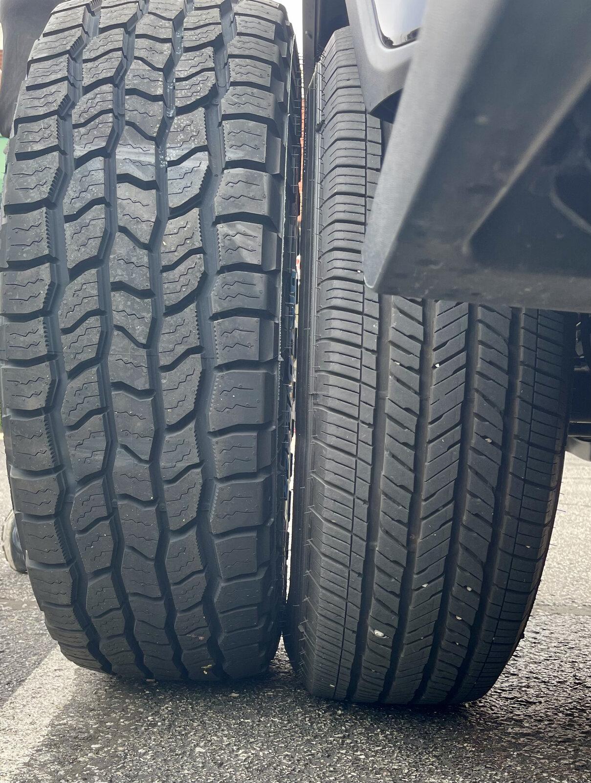

Considering I love the Overland wheel and plan on keeping for awhile. May even get an extra Overland wheel for a spare. But probably about to pull the trigger on these soon. Cooper Discoverer AT3 XLT 275/70/18
thoughts?

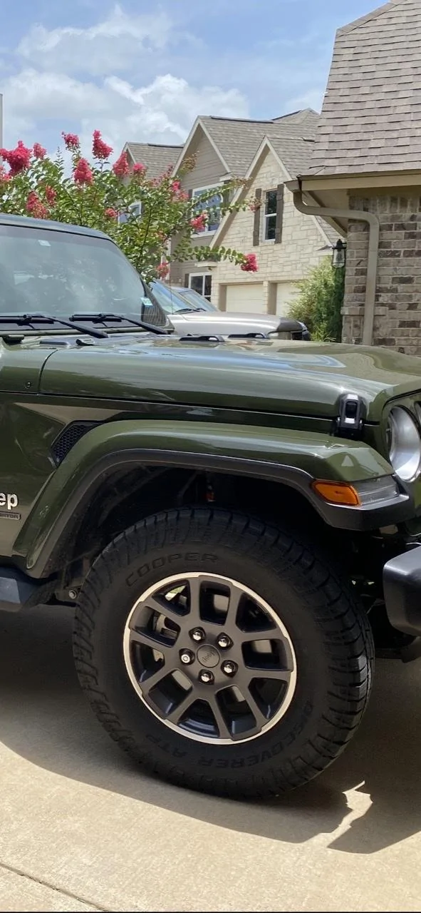

thoughts?
I just did the Cooper Discoverer ATP 275/70/18 on my JTO and love them. Very quiet, good grip, and I like the sidewall better than the AT3. Speedo was off about 3 MPH at 70, but I corrected that with JScan and now it's on the money using the 33.25" size in the app.

Sarge502
Jul 3, 2021
46
1,313
2,484
Kentucky
Thin Blue Line
I just did the Cooper Discoverer ATP 275/70/18 on my JTO and love them. Very quite, good grip, and I like the sidewall better than the AT3. Speedo was off about 3 MPH at 70, but I corrected that with JScan and now it's on the money using the 33.25" size in the app.
Not heard much about that ATP version. I actually like to sidewall of the AT3 XLTs. Looks good though and good to get another visual of that exact size in comparison.
I’ve heard Cooper in general are much more quieter especially the XLTs than BFG K02s which I was also considering. Regardless I’ll probably recalibrate the odometer with a taser soon after.
