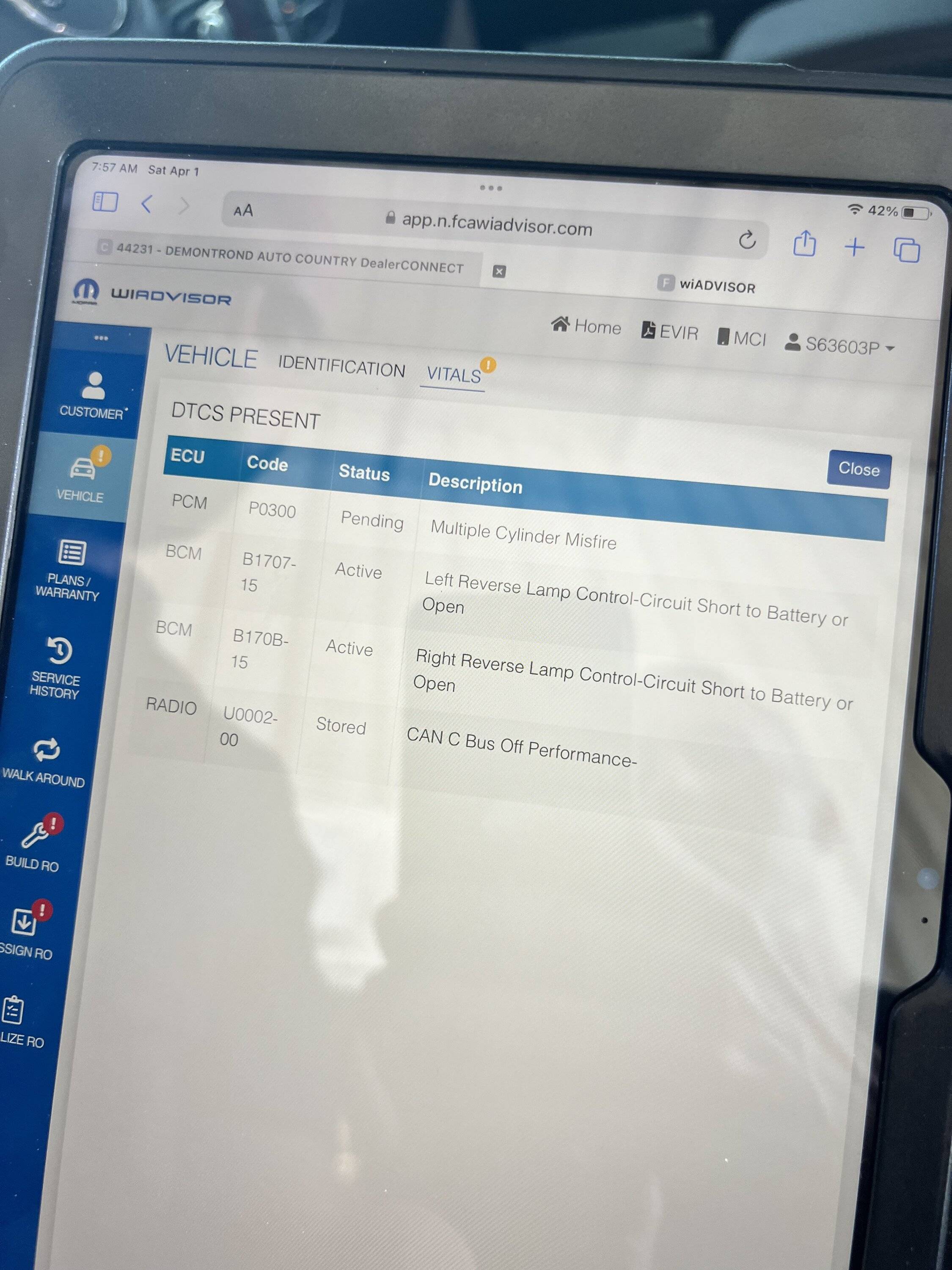

Since I’ve bought my 22 Rubicon I’ve been dealing with the P0300 issue (see previous threads here
https://www.jeepgladiatorforum.com/...-those-with-misfire-issues.24853/post-1009891
https://www.jeepgladiatorforum.com/forum/threads/hi-ho-hi-ho-its-off-to-the-dealer-i-go.64608/)
It’s presented itself as an intermittent CEL that I’ve been tracking:
* 08/06/2022: 1:44 PM
* 08/08/2022: 8:40ish PM
* 08/10/2022 5:30 AM
* 08/11/2022 8:29 PM
* 8/13/2022 11:01 AM
* 10/13 1:32 PM
* 11/8 7:07 PM
* 3/23/23 12:45 PM
* 4/1/23 9:49 AM
The truck has had the all the Jeep updates applied to the ECU without luck. I’ve worked with Jeep Warranty and the dealership to get this issue fixed permanently w/o luck. In typical dealership fashion they can’t reproduce the issue even when I show them pictures of the CEL, so they return the truck to me asking me to try again later.
Today I’m headed back from a local store and the CEL comes on and I’m literally a mile from the dealer, so I drive in. They are finally able to pull the error code and take the truck in for repairs. I explain to the service advisor this is the 4th or 5th time I’ve tried to get the issue resolved - so he knows there is a backstory. I’m waiting to hear back from the dealer to see what the diagnosis will show.
I’ve done this song and dance with the dealer and Jeep several times over the last 6 months. I’m beyond frustrated due to the lack of ability for mechanics to perform diagnostics beyond plugging in a computer. Why doesn’t Jeep have the ECU store the error codes for several hundred miles in these situations? Why doesn’t the Jeep app report the error like it used to? It’s really frustrating to be that guy complaining about an issue that never presented itself to the dealer in the narrow window they had it!
Depending on the outcome I’m considering a lemon buy back, trading it in, or ? I’ve looked around the forum and most people’s trucks were diagnosed quickly and fixed. I’m one of the few where nothing done has been able to resolve the issue… Is there someone with a similar situation that had the P0300 issue resolved permanently?

Mine has been resolved. It was the CCDIFF thing where it hadn't yet learned the relative cam/crank positions. They forced a relearn, reported the info back to STAR and shortly after, after others had done the same, a fix was sent out.
But mine was VERY very specific in when it would or would not do it, and it was always the same bank under specific conditions. Engine hot/warmed up, shut off for 20-40 minutes, then restarted and low load, low RPM, it would kick a P0300. I used jscan to log and track it, gathered freeze frames and so on. My logs and detailed descriptions of the events as they happened allowed them to pair my P0300 with other reports to STAR and led them to some papers on what to look for and what information to gather and send back to STAR.
My wife's 2021 Grand Cherokee had a weird P0300 pending, no CEL called for misfire that ended up being resolved with spark plugs. Again, I had detailed logs for them because by the time I got it there, it was settled down and it hadn't set the CEL or stored any codes. They said it looked clean when I got it there. I handed them the detailed logs as proof, the freezeframe info showing it was ignition, and that all else was within normal operating parameters.
Neither the 2021 GC 3.6 nor my 2022 JT 3.6 ever exhibited any ticking.
The JT only set the CEL a couple of times. One time it was misfiring so hard/bad that I was afraid it was going to die, but it never set the CEL! The only times it did trigger the CEL was when I couldn't even feel or hear the misfire, it appeared smooth. It was counter to expectations.
Anyway, both cases resolved.
The Grand Cherokee with spark plugs, the Gladiator with a forced learn of CCDIFF.

Got it back from the dealer earlier this week and the work states:
* 14761 check engine light is on code P0300 Calibration: 2022 JT 3.6 PCM 850RE 4.10AR 97MPH Rubicon 4:1 Transfer Case 50 State Flashing from current part number 05149315AC to targeted part number 05149315AD
I was advised that the timing is off, hence the occasional CEL. If the light goes off again they will be tearing into the engine Apparently, Jeep advised them that it would not be necessary for a verification before looking at the cams and camshafts. The service advisor didn’t seem to think that the software update would fix it.
