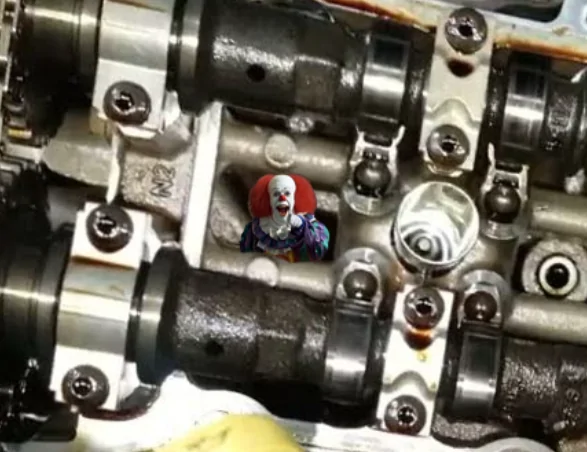

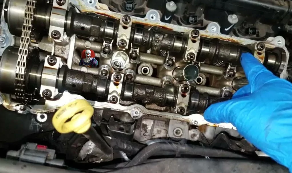

Now THAT is scary, especially to anyone with coulrophobia
Jeep Gladiator P0300 Code - New Cam Shaft? 1754590599387-k
Jeep Gladiator P0300 Code - New Cam Shaft? 1754590765747-k0
I wonder what the term is for the rational fear that some clown last worked on your Jeep?
