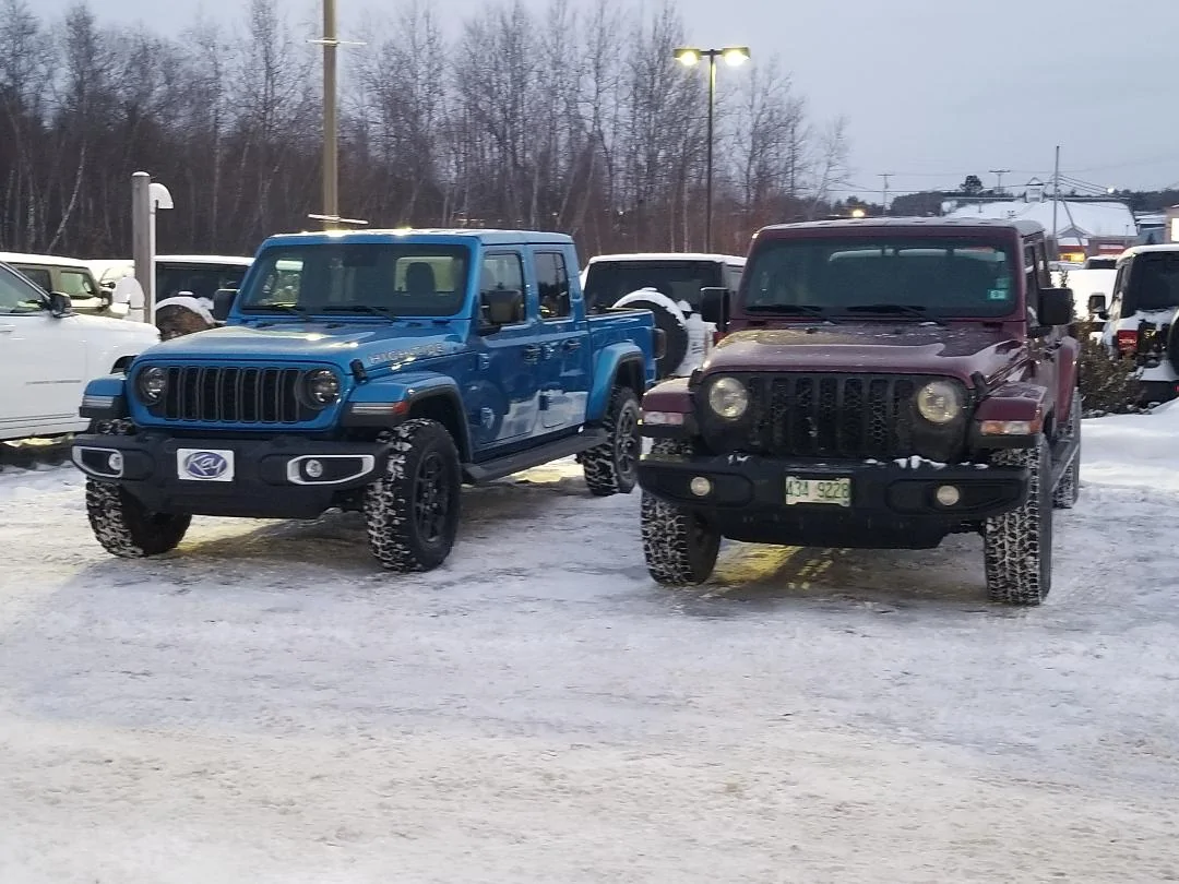

Pulled into work yesterday and truck seemed to run rough. Really rough. I was turning at the time, and thought it felt similar to the front axles binding as they do in 4wd at low speed. But it was far worse, and the CEL started flashing as I pulled into my space. I knew it was a misfire at this point, so I shut it off for a few seconds, then turned it back on. CEL was gone and it seemed to run smooth. A few seconds later the misfire started coming back along with a steady CEL. After work, I started the truck and drove it to AutoZone since my code reader is in a car under 2 feet of snow. P0300 was the only code that popped up. So over to the dealer I went. The service writer checked the code, checked my vin and gave me wonderful news. Seems my Powertrain warranty expired on the 21st of January. Just 6 days ago with only 46k miles on it. Now I am hoping for a cam sensor failure, or bad gas. At least the cost is on me anyways, and more reasonable. I am sure if they need to go internal, it is going to hurt.
My wife was on the internet digging for the culprit. I finally told her she is wasting her time. At one point she mentioned a loose gas cap. I just laughed. So hopefully it will get diagnosed sometime next week, and parts for whatever it is will be available. I thought about calling Jeep, but today no one cares anyways, so it would be a waste of time. People seemed to find it hard to get things covered when they are under warranty. Six days out, and I will be told to pound sand. I thought about buying a new one, but it has no trade in value. Less than half of new. And to buy a new one, I would have to by a lesser model to stay at the same price point this one was when new since the prices shot up over the past couple years. (Mine is a loaded Willys) Thought about another truck, but I ruled that out quickly as I bought the Gladiator because of what it is. So now I wait to find out how painful it will be to fix, and move on to many more years with it.

I am not sure what the problem if any was, but I fixed it.
