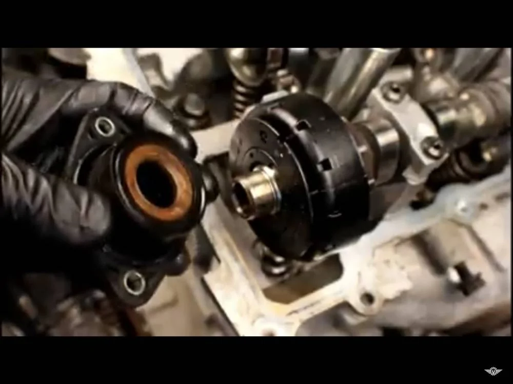

As far as "can you look inside" - yes, absolutely. I've done it on a 390 that had a weird #8 thing going on with spark plugs and uneven running.
People scope inside engines all the time. It's easy and cheap with today's electronics, but there are other ways and things to look at first before going that far.

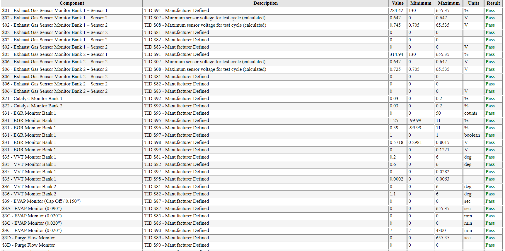

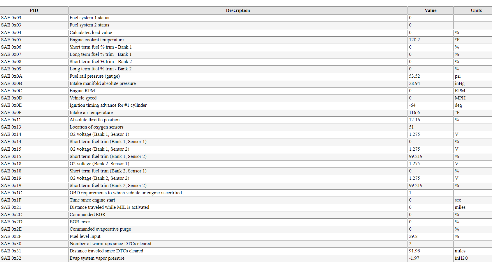

Below is a fraction of what any fool with the right tools can find on these (boy, I left myself wide open there, eh?)
There's so much more detail available, a bore scope is not likely needed to know what's truly going on, but if all else failed, piece of cake to do.
At least on the right bank.
The left bank you have to pull the intake to get the spark plugs out.
Heck, a good troubleshooter can read the details of what's going on in an engine and know what to look at and sneak up on the issue, not say hey, we have a ping, time to tear into it!
No reason for someone to tear into these so quickly, and frankly, I'd try some of my old-fashioned remedies for carbon before a tear down.
We used to run into carbon build up as something that happened as cars aged back in the 70s. (the coke bottle and water was a good way to clean 'em out)
Fault code: P0303
PCM Mileage since MIL On: 0.00 miles
PCM Odometer: 950.27 miles
Open Loop - Bank 1: No
Closed Loop - Bank 1: Yes
Open Loop due to Driving Conditions - Bank 1: No
Open Loop with DTC - Bank 1: No
Closed Loop with DTC - Bank 1: No
Open Loop - Bank 2: No
Closed Loop - Bank 2: No
Open Loop due to Driving Conditions - Bank 2: No
Open Loop with DTC - Bank 2: No
Closed Loop with DTC - Bank 2: No
Engine load: 30.20 %
Freeze Frame Engine Coolant Temp: 66.00 Deg.C
Intake Air Temperature: 215.00 Deg.C
Ambient Air Temperature: 12.00 Deg.C
Short Term Fuel Trim - Bank 1: 12.49 %
Long Term Fuel Trim - Bank 1: -3.13 %
Short Term Fuel Trim - Bank 2: 9.37 %
Long Term Fuel Trim - Bank 2: -7.04 %
MAP Voltage: 1.96 V
MAP: 46 kPa
Atmospheric pressure: 97 kPa
Engine RPM: 875.00 rpm
Vehicle speed: 0 MPH
Throttle Position Sensor 1 Percent: 12.94 %
Battery voltage: 14.58 V
Fuel level: 95.69 %
Purge Solenoid Current: 0.00 mA
Purge Duty Cycle: 0.00 %
Idle Air Control (IAC) Current: 0.00 mA
Idle Air Control (IAC) Duty Cycle: 0.00 %
EGR Flow: 0.00 g/s
Current Adaptive Cell ID: 24
Spark advance: -2.00 Deg
AC Clutch: Disengaged
EGR Gassed Flowing: No
Power Steering High Pressure: No
AC Switch: Off
PRNDL in Gear: No
Brake switch: Pressed
Low Ethanol PWR Enrich Flag: No
Low Ethanol Therm Management Flag: No
Ethanol Gas For Sure: No
Ethanol Mode: No
Ethanol - 0% Blend Direction: No
Ethanol - 85% Blend Direction: No
Ethanol - Open Loop Fuelling: No
Ethanol Fine Tune Complete Previous: No
Ethanol Fuel Volume Changed: No
Ethanol Low Fuel: No
Ethanol Trigger On Fuel Volume Fault: No
Ethanol Trigger During Learn: No
Ethanol Learn: Disabled
Ethanol Course Update Ready to Learn: No
Ethanol Course Update: Not completed
Ethanol Fine Tune: Not completed
Actual Torque: 0.84 Nm
Potential Torque: 78.16 Nm
Target throttle position: 2.56 V
Electronic Throttle Control (ETC) Motor Directional Duty Cycle: -20.67 %DC
Electronic Throttle Control (ETC) Motor Duty Cycle: 20.67 %DC
Throttle position sensor 1: 2.58 V
Throttle position sensor 2: 17.42 V
Accelerator pedal sensor 10.44 V
Accelerator pedal sensor 20.22 V
Accelerator pedal position: 0.00 %
Brake switch 1: Released
Brake switch 2: Released
H-Bridge Circuit: Enabled
Ignition Run/Start Switch: On
Throttle Flow Adaptive: 0.13 g/s
Throttle Flow Multiplicative Adaptive: 2.00
PHI Adaptation Value: 0.00
Calculated MAP: 46.59 kPa
Ethanol Percent: 0.00 %
Turbo Boost Timer: 0.00 ms
Throttle Inlet Pressure: 0.00 kPa
Throttle Inlet Pressure Voltage: 320.34 V
Turbo Airport Mass Flow: 3.45 g/s
Turbo PRatio: 1.00
Turbo Torque Count: 0
Turbo Speed: 65535 rpm
Turbo Wastegate Duty Cycle: 200.01 %DC
Time since Run/Start: 45 sec

Doesn’t the 3.6 use a centrifugal oil separator?
Hootbro
Apr 13, 2019
10,237
20,138
2025 Gladiator Sport
It does. It is on the back side of the RH exhaust cam and works in conjunction with the PCV to separate air and oil.
Thanks for confirming, honest question: Isn’t this a better solution than a catch can? My understanding is that centrifugal separators are not terribly common and do an excellent job of managing PCV blow by. A catch can would seem to be rudimentary in comparison.
