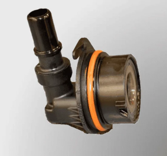

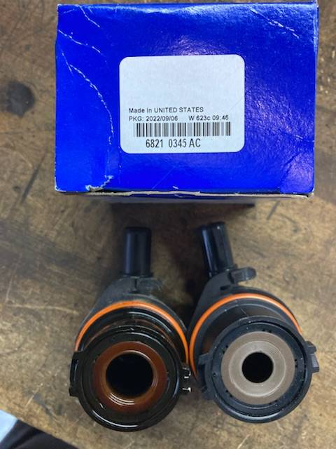

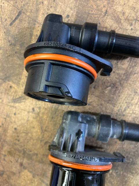

Yea I heard they changed it, I want the new one I think there might have been leaks and even a tsb on the older one
Replaced one in a JL after some other repairs (dealer tech). I was given the outdated design unknowing. The engine died shortly after due to guzzling oil through the PCV. The intake had over a quart of oil in it
